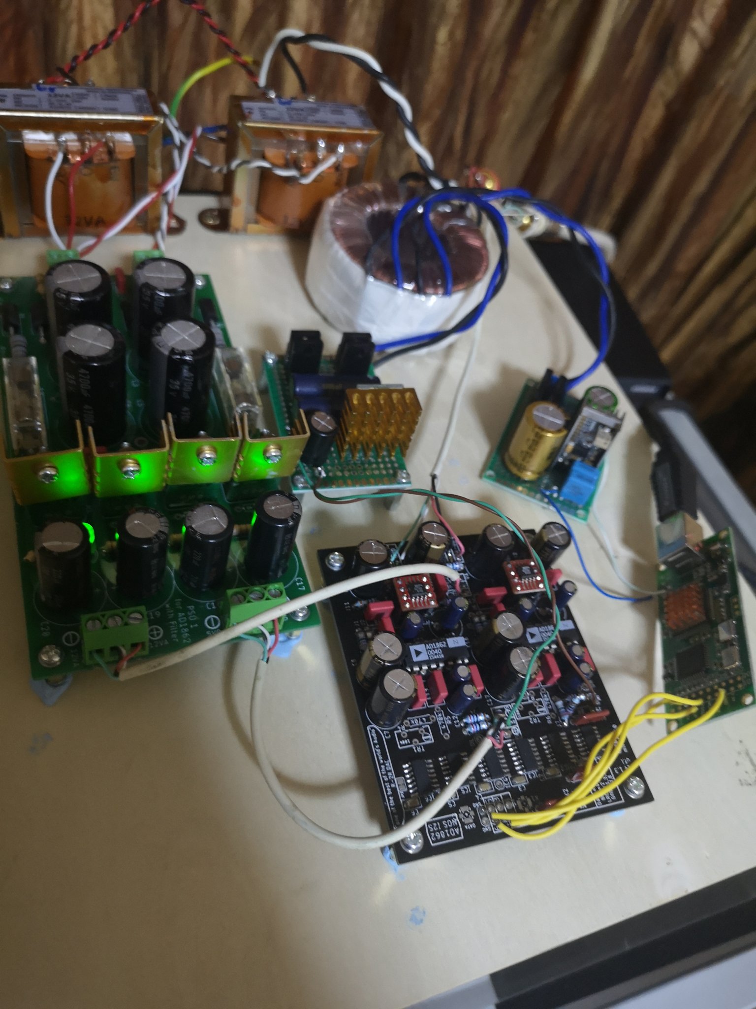

I have just completed a Ad1862 dac and have been comparing it to the Kubelik. Both are using the Amanero USB inputs. I don't know, I feel the Kubelik has the qualities in certain area that I do not know how to define well like an audiophile reviewer. English is not my native language. But to my best of ability ~ the ad1862 does not have the same airiness and musicality of the Kubelik in my system. It could be due to the output stage in the Kubelik that gives it a very well controlled, calm sound when it comes to complex passages of the music. The Ad1862 sounds flatter, more 2D as compared to the Kubelik. I have not tried other iv stages on the ad1862 though and I think it is still worth exploring.
yes, they are. And they are from the legit supplier.That's interesting, thanks for making that comparison. Are your IV opamps OPA627s?
any opinion on that ?
What I found when developing Kubelik was that the noise in the IV stage affected how 'airy' the sound is. OPA627 is the lowest noise JFET opamp but its still more than twice as noisy as the OPA2209 used in Kubelik which is a bipolar input device.
I just checked OPA1641 datasheet and found it slightly beats OPA627 on noise so I'm a bit out of date, OPA627 is no longer the quietest JFET input opamp.
As I suspected, you have done extensive tests before finalising on the design of output stage. This thread is not about ad1862 so I shall not ask you what can be done to improve it... 😬What I found when developing Kubelik was that the noise in the IV stage affected how 'airy' the sound is. OPA627 is the lowest noise JFET opamp but its still more than twice as noisy as the OPA2209 used in Kubelik which is a bipolar input device.
