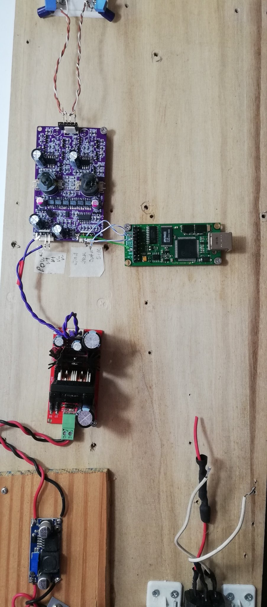

Yes Claude, I have built the Phihex dac, which I use for listening to music from a laptop USB out. The USB to I2s converter for this, is the jlsounds I2SoverUSB v.III. It isolates the electrically noisy laptop (due to dead battery) from the Phihex DAC.You built the PhiDac as well if I remember well... how does that one sound in comparison to Phi DecaDac or any other DAC to your ears?
Now, the USB to I2S converter I connected to the Kubelik is not isolated and at the USB tests I run yesterday, a lot of noise mixes with the music, so for the time being I am not in position to compare those two.

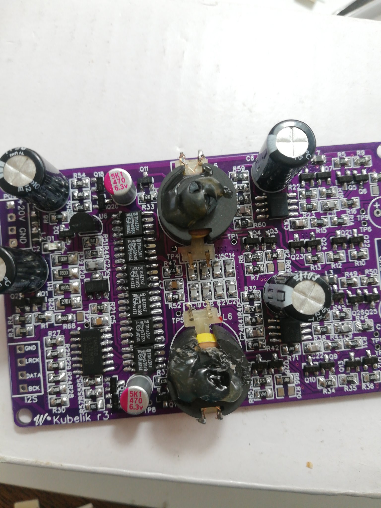

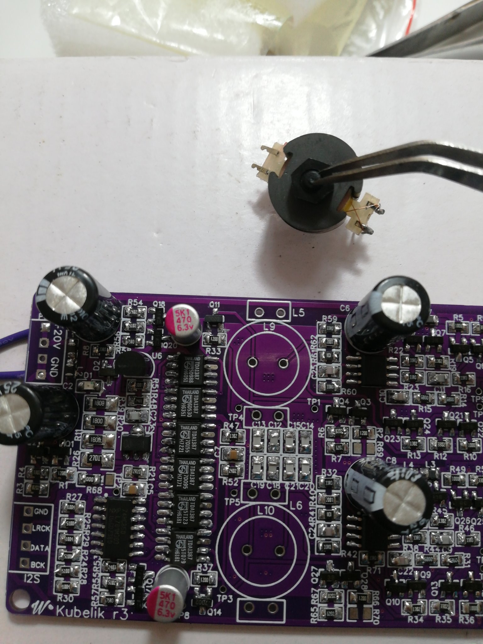

By all means secure the screws by glue or hot melt. As far as possible, don't move the ferrite halves relative to each other or the inductance value will change. Are you sure its the screw that's loose, not the ferrite core relative to the bobbin? The latter is very normal. Tprquing up the screw won't stop the play of the bobbin relative to the core. Once its soldered down, the PCB will hold both in position and there won't be any movement, that is if you tension the bobbin 'arms' sufficiently by applying pressure to each when soldering.

Check for the inductors pin pair on which the magnet wire is visible. This pair should be oriented to the inner side.
The other pair of pins is not connected to the inductor wire. Also the outer pads of the PCB are not connected to the circuit.

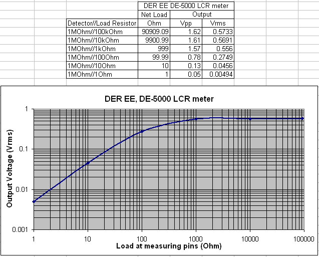

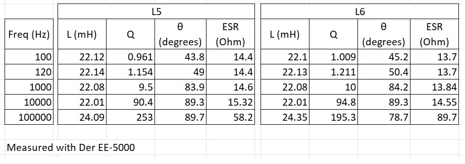

At lower frequencies I think the inductance goes up because the drive current used to measure increases, resulting in increased flux in the core and higher non-linearity. At 100kHz we're on the way towards the inductor's self-resonant frequency where it forms a parallel tuned circuit with its own stray capacitance.
BTW the inductors are made by my wife 😛

l want to report that the problem is the c media usb i2s converter. It is playing well with another pcm2706 converterl have been listening to Kubelik today.
