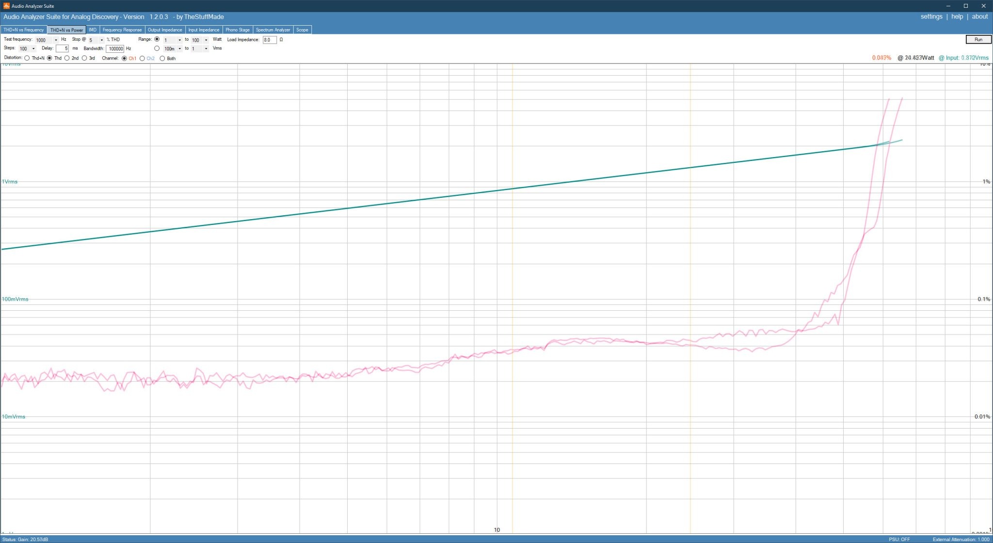

More on this, I'm trying out different ways of hooking up the cathode resistors on the KT88s. Have a look at the two configurations I just tried, and the resulting measurements. There's a clear difference, however with the bypass capacitors the distortion plot doesn't have the dip around 30W and is flattened out. Interesting, just not sure what sort of conclusions I can draw from this?

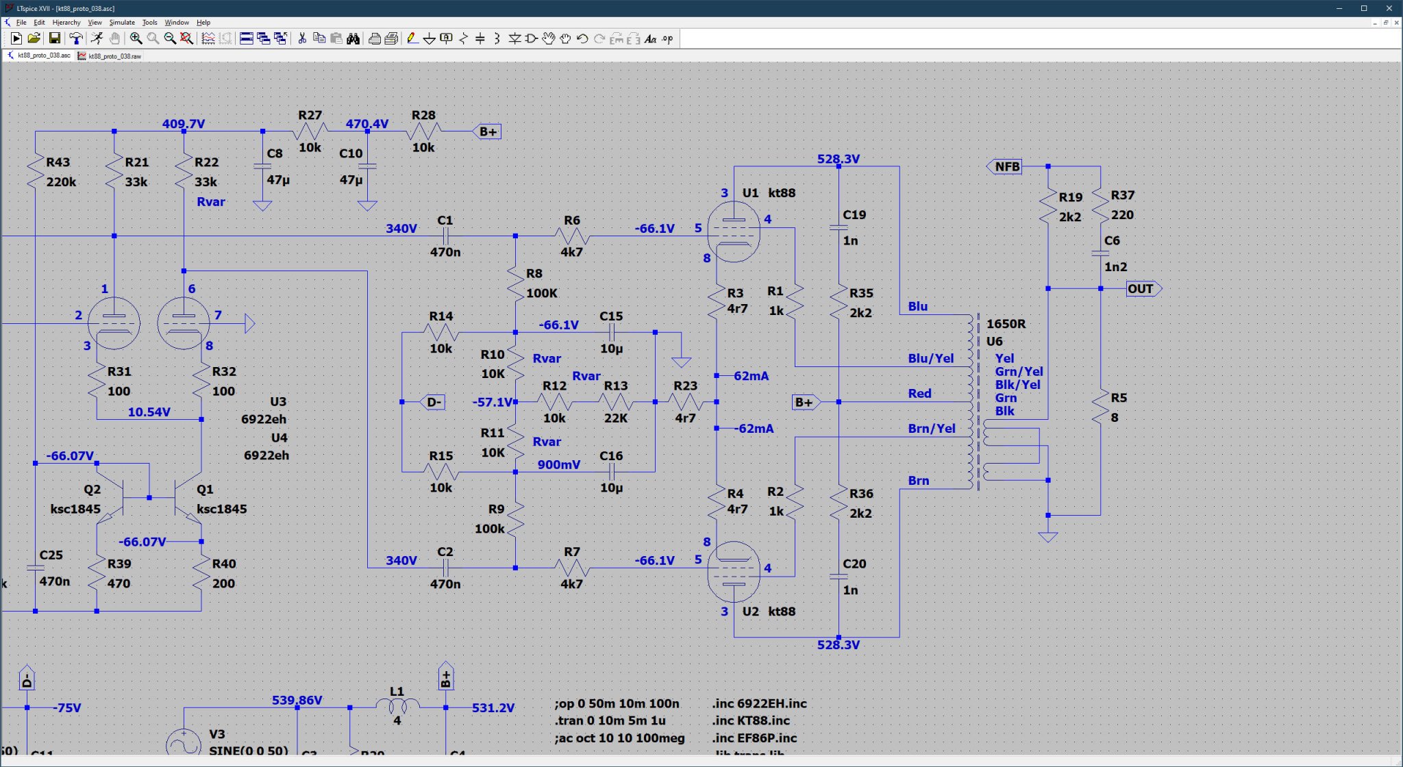

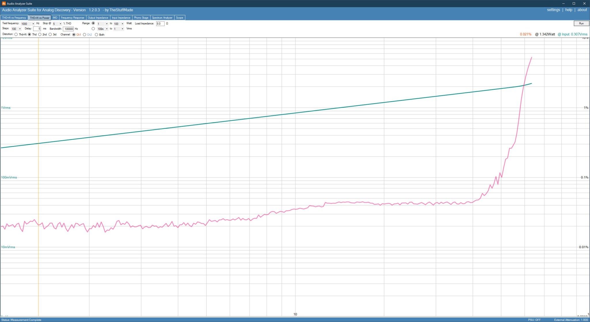

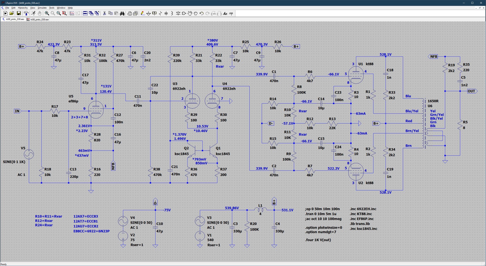

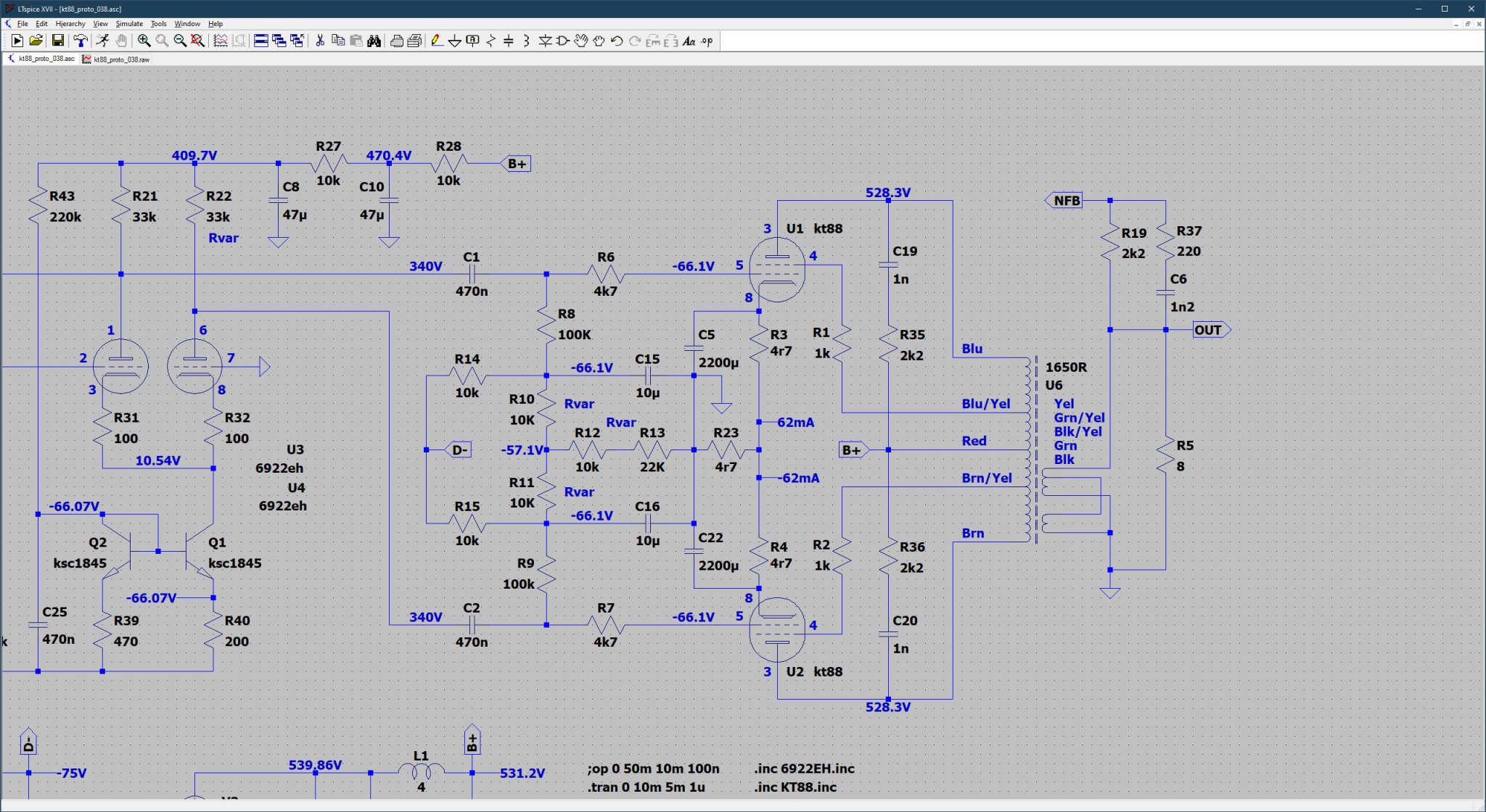

Alright, this is where I'm at at the moment, and I am running out of ideas to further optimize things. I've reduced the parts count and simplified the circuit around the LTP without any adverse effect on performance, or at least as far as I can see/measure. I believe it was Albert Einstein who said: 'Everything should be made as simple as possible, but not simpler' and I couldn't agree more. Thanks guys for all the helpful suggestions thusfar!

What about reliability at 330Va?
Actual anode voltages on the 6922 are lower, around 300V, I forgot to add these to the schematic, please see an updated schematic below. The voltages noted with a * are the measured voltages. So there's no problem, Also many manufacturers (JJ and Tung-Sol for example) specify a 400V Ua-max for the 6922/E88CC so we're nowhere near the max, with about 100V of headroom.
This 400Va is only at Ia= 0, which is not the case here. Maximum at Pa<0,8W is 250V
I don’t see the problem, the 6922 is routinely used, also in commercial designs, running at much larger current and anode voltages than I’m using here. If you worry about the longevity of the tube then I suggest you stay away from tube amplifiers as they all need their tubes replaced at some point, some more often than others.

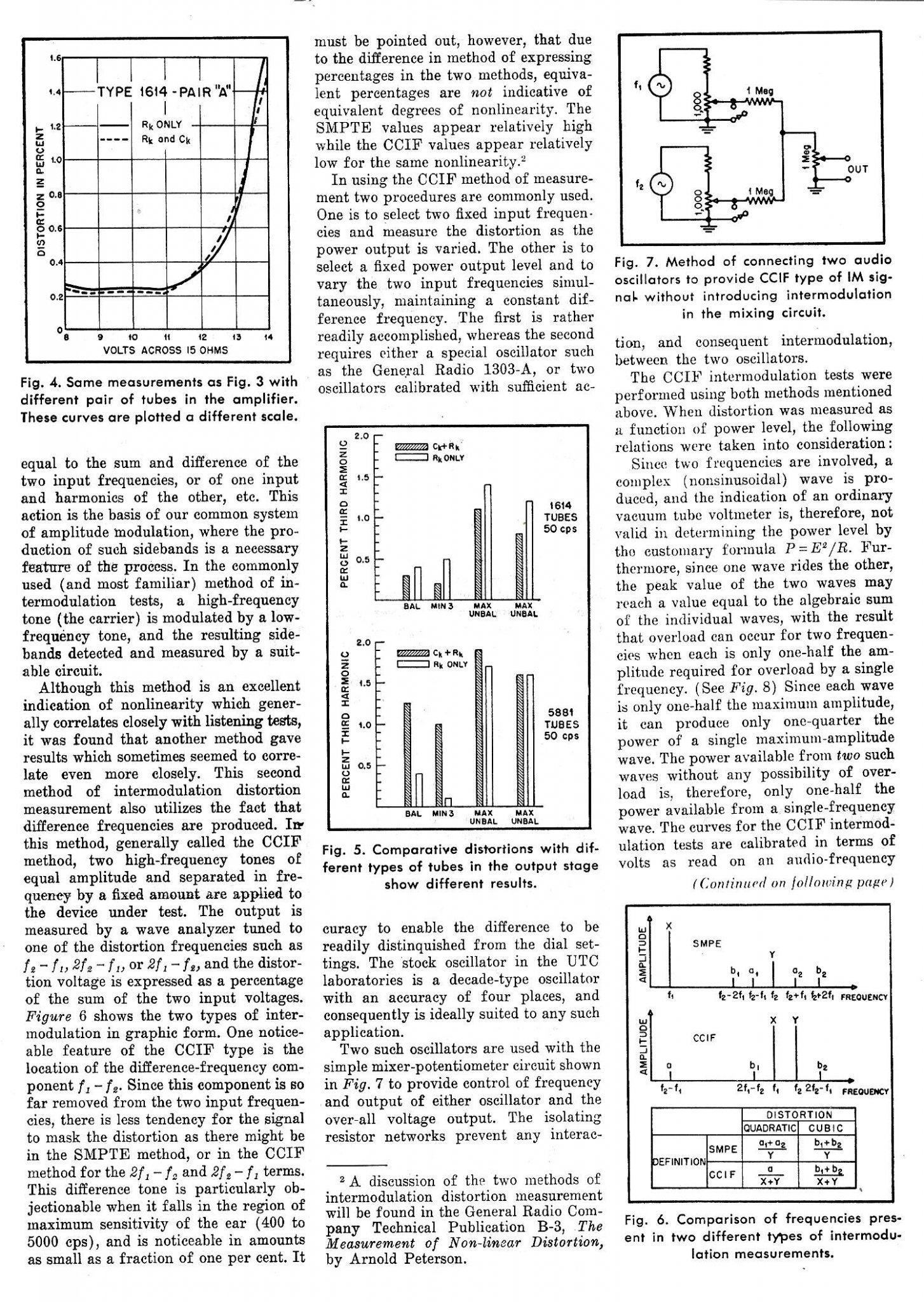

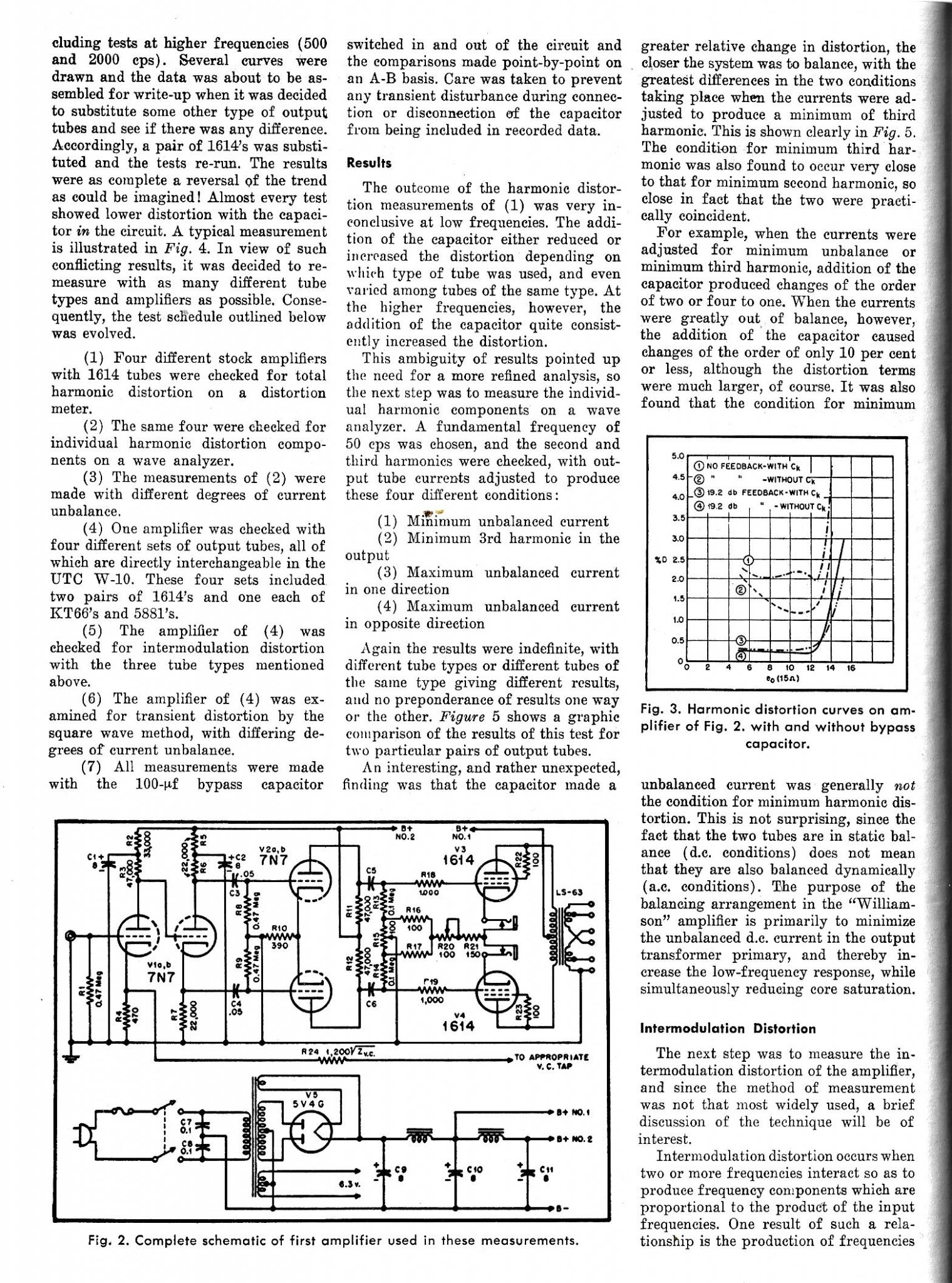

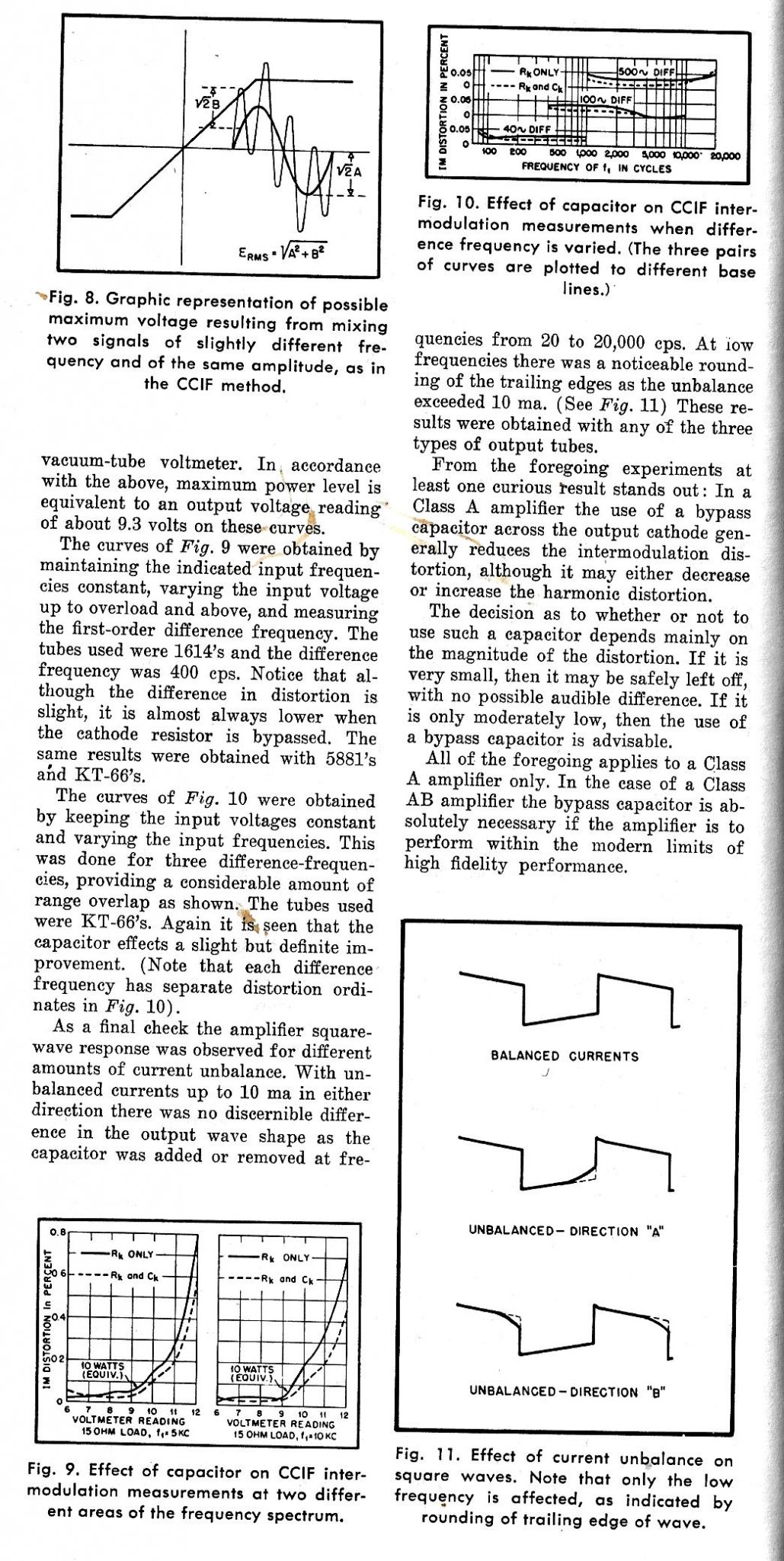

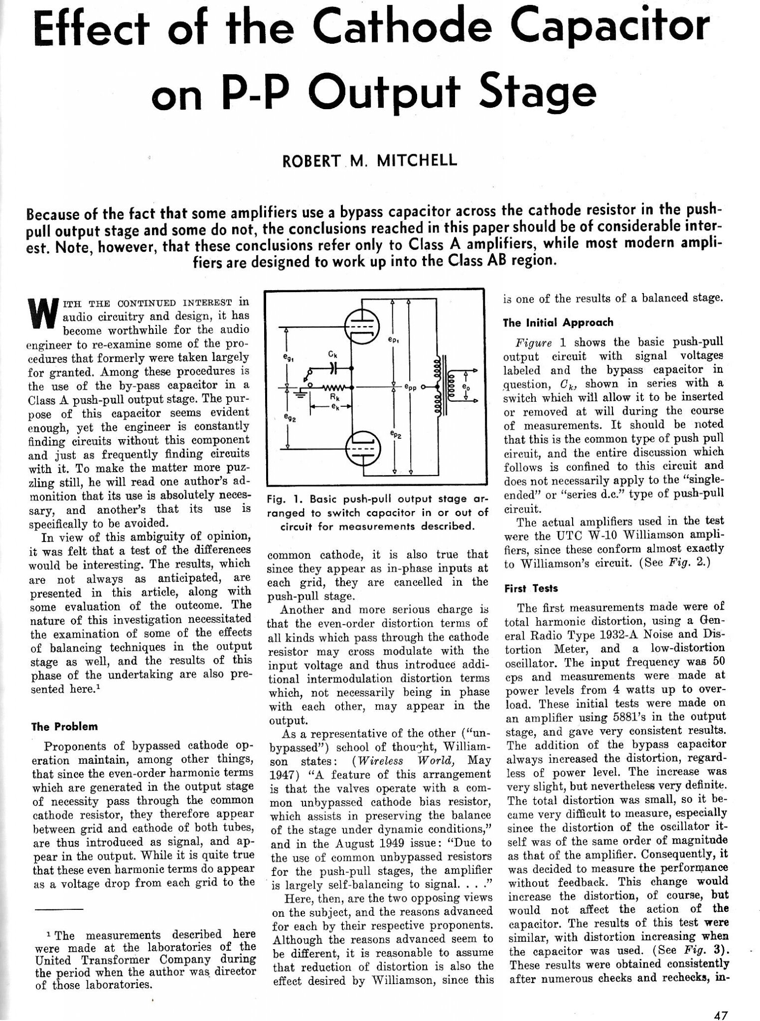

Here is an interesting read on that subject.
Thanks John, I’ll be sure to give that a read!

P.s. any suggestions for a gyrator load for the EF86 you mentioned earlier? I mean I can cobble something together, but if you have a proven design you’d like to share I’d rather hit the ground running.
