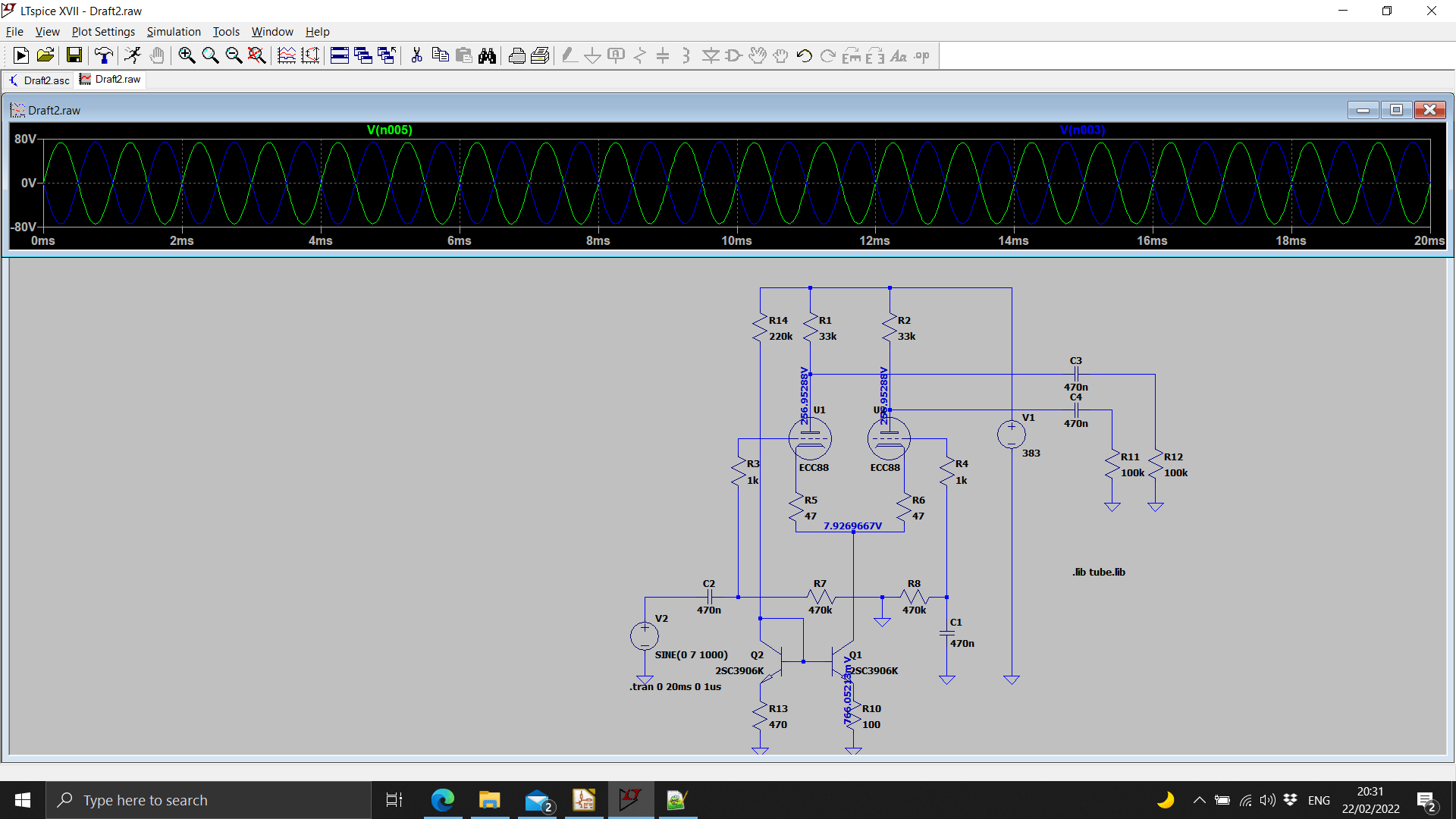

This would be my version with a bit more swing.

You are correct in saying that the rounding of the peaks of the waveform in the LTP actually does compensate for the distortion in the output stage. Sort of distortion cancellation. In fact if you look at the drive to the output devices you will find the NFB has rounded the drive waveforms. However I am not sure such distortion cancellation can be relayed upon and in my view its better to design linear. I don't know if 43% UL may be a bit high.
Anyway you wanted i dotting and t crossing. Still don't know why the distortion suddenly increases. You would expect it move with bias as class B will be later.
Yes, please look at the measurements with the different current settings for the KT88s I posted earlier, you’d expect the point where the amplifier enters class-B to move with the current setting (i.e. lower current it shifts to the left, higher current shifts to the right). The fact that it doesn’t and the point where the distortion starts to increase is the same for all, hence the cause for this lays elsewhere.
My take on what causes this is that the LTP runs out of headroom, which I plan to test tomorrow by providing it with a higher supply voltage, to see if this point moves.
It doesn’t, it is nowhere near what I’ve shown in the first post. How do I know? Because that’s one of the 1st designs I prototyped just to have a baseline.

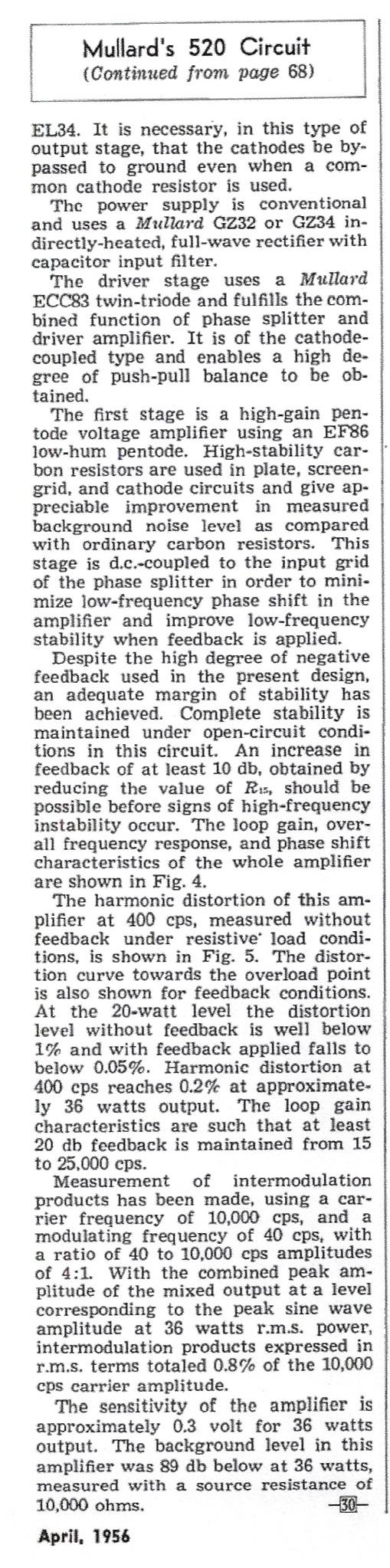

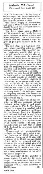

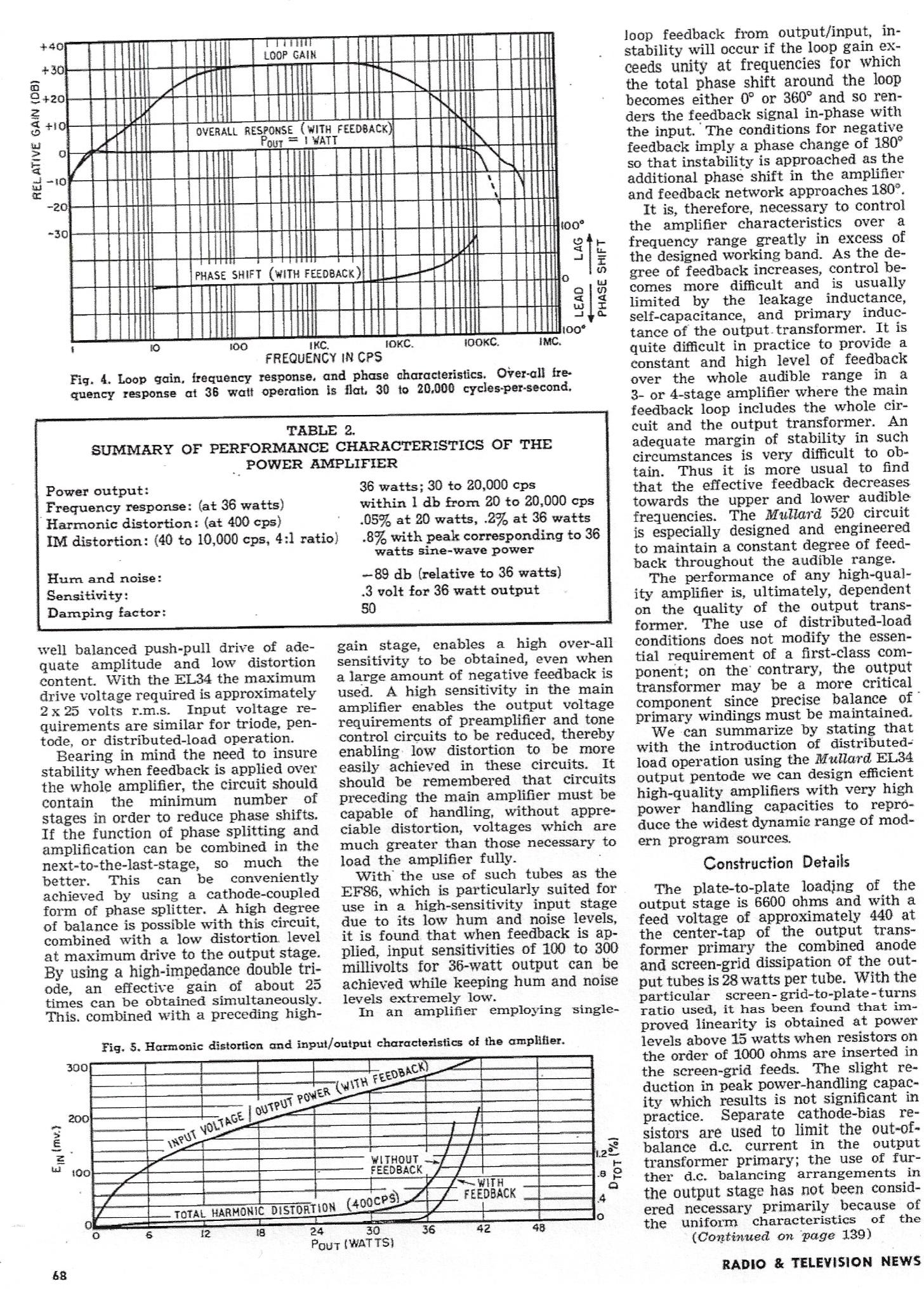

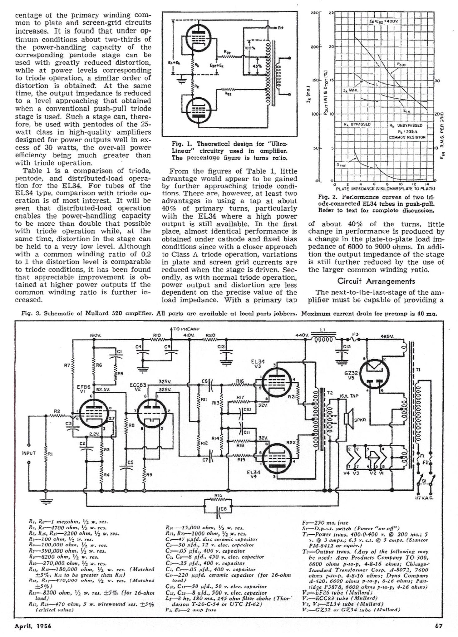

Proto 30 is definitely the basic Mullard 5-20, of which there are many iterations since its introduction in 1956.
66 yrs ago. Shew us where your cct Proto 30 is significantly different. I'm curious.
Look at the THD vs. output power measurement I included, now show me a Mullard 5-20 design that does the same or better. They don’t, I looked at them in great detail in the simulator and have built a few variations to get a handle on what they’re capable of and they don’t offer this level of THD performance. But am welcome to try any suggestions you might have as you have far more experience than I do, I’m just a nitpicking perfectionist that bites down on something and won’t let go until I have extracted every last bit of performance from it.
