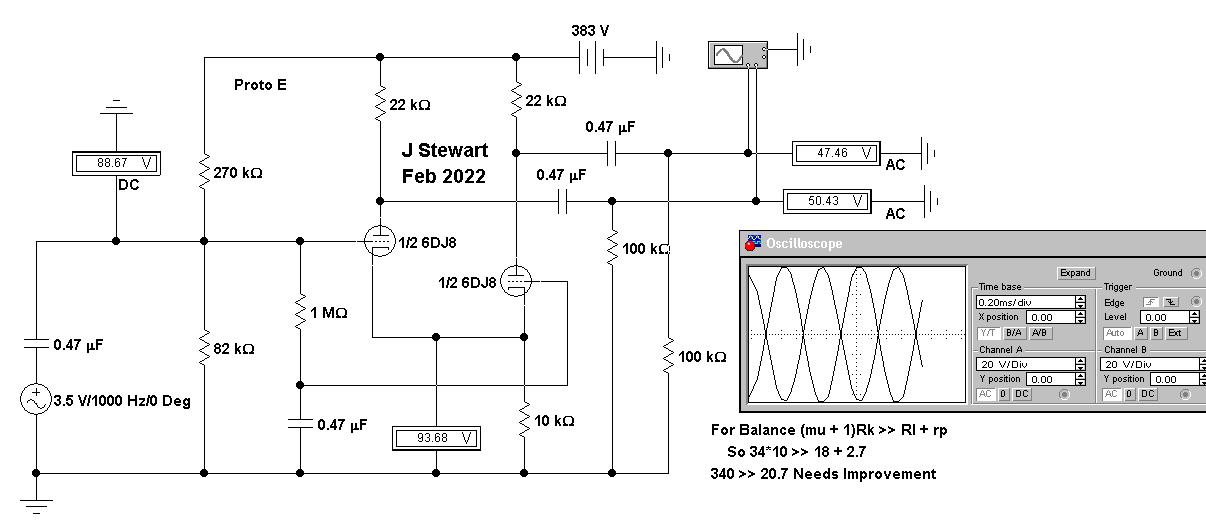

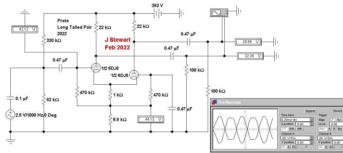

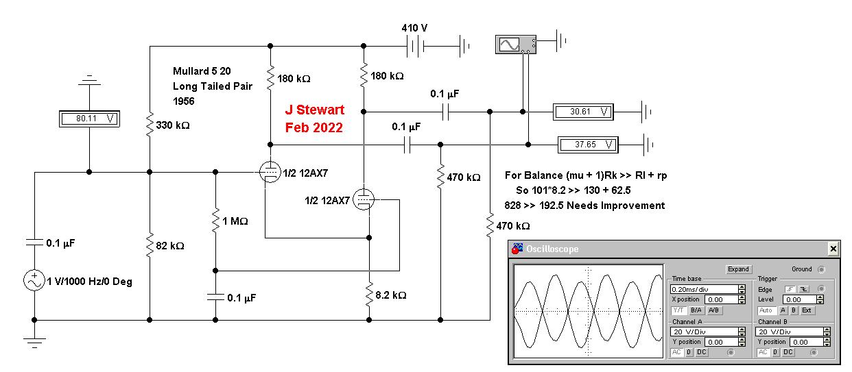

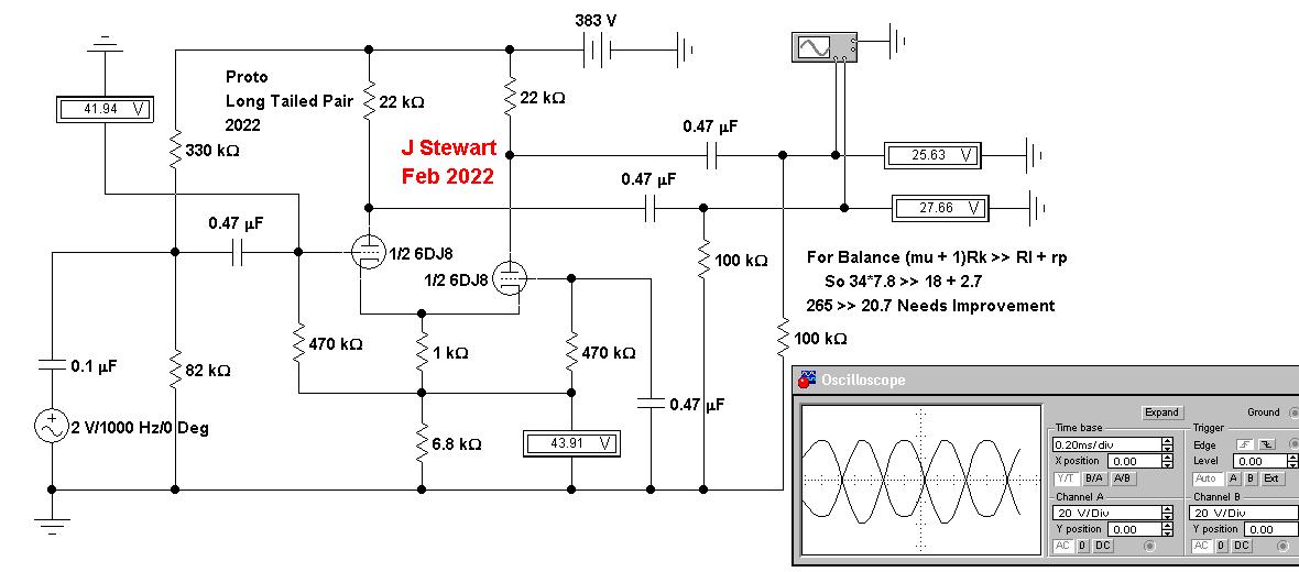

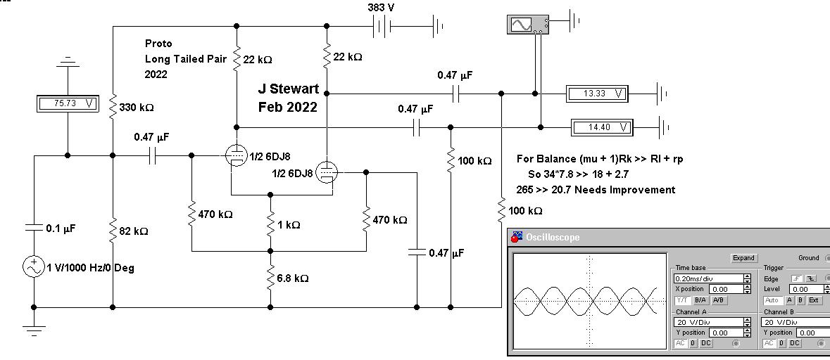

Problem solved, follow the examples. The Mullard long tailed inverter has no problem driving the output.
The 2nd sim shews your long tailed pair, looks OK driven by One Volt.
In the 3rd 2V starts to shew some clipping, not enough p-p to drive the output.
The 4th shews 2.5V, overload.
The 5th is biased up like the Mullard & easily drives the output. The balance is also a little better.
There are other ways to get here, but this works well.

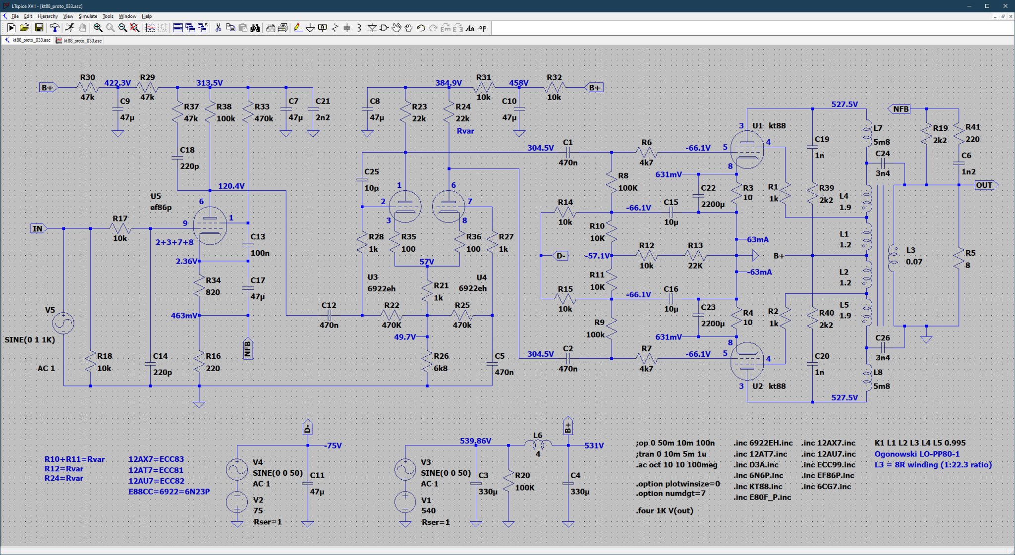

Thanks! I dusted off the R&S LCR bridge and took some measurements of the Ogonowski LO-PP80-1 OPT, here's what I found, these values may seem low, but take note these are at 1kHz as that's the frequency I'm using in the simulator for modelling the amplifier, so it seemed wrong to use 50Hz measurement data. Also the LCR bridge tops out at 1.5Vpp, which may not be enough to get an accurate measurement. I'm measuring the OPT without anything connected between the Anode, UL and B+ connections, so I'm measuring one half of the PP transformer.I agree with you on the reliability of most if not all OPT models, but using a different voltage ratio between anode and screens and a different reflected impedance will change alot the behaviour of the output tubes, so at least I would put it right in the simulation. The OPT is a 4k-8 Ohm (based on the 22.3 ratio written as note).

Primary LO-PP80-1
Anode to UL > 1.88H > Rdc=36.3 Ohm
UL to B+ > 1.2H > Rdc=23.6 Ohm
Secondary LO-PP80-1
8 Ohm winding > 67mH > Rdc=0.5 Ohm
I also measured parasitic inductance, which is the parasitic part of the primary winding that's not coupled to the secondary. I measured parasitic inductance by shorting the secondary 8 Ohm winding leaving the 4 Ohm winding open and measured between Anode and B+ on the OPT.
Parasitic inductance
5.8mH
Since I had the tools out I also wanted to take a look at parasitic capacitance. Which I measured by shorting the Anode, UL and B+ on the primary side and the 8 Ohm winding on the secondary side individually and subsequently measuring the capacitance between these shorted primary and secondary windings.
Parasitic capacitance
3.4nF

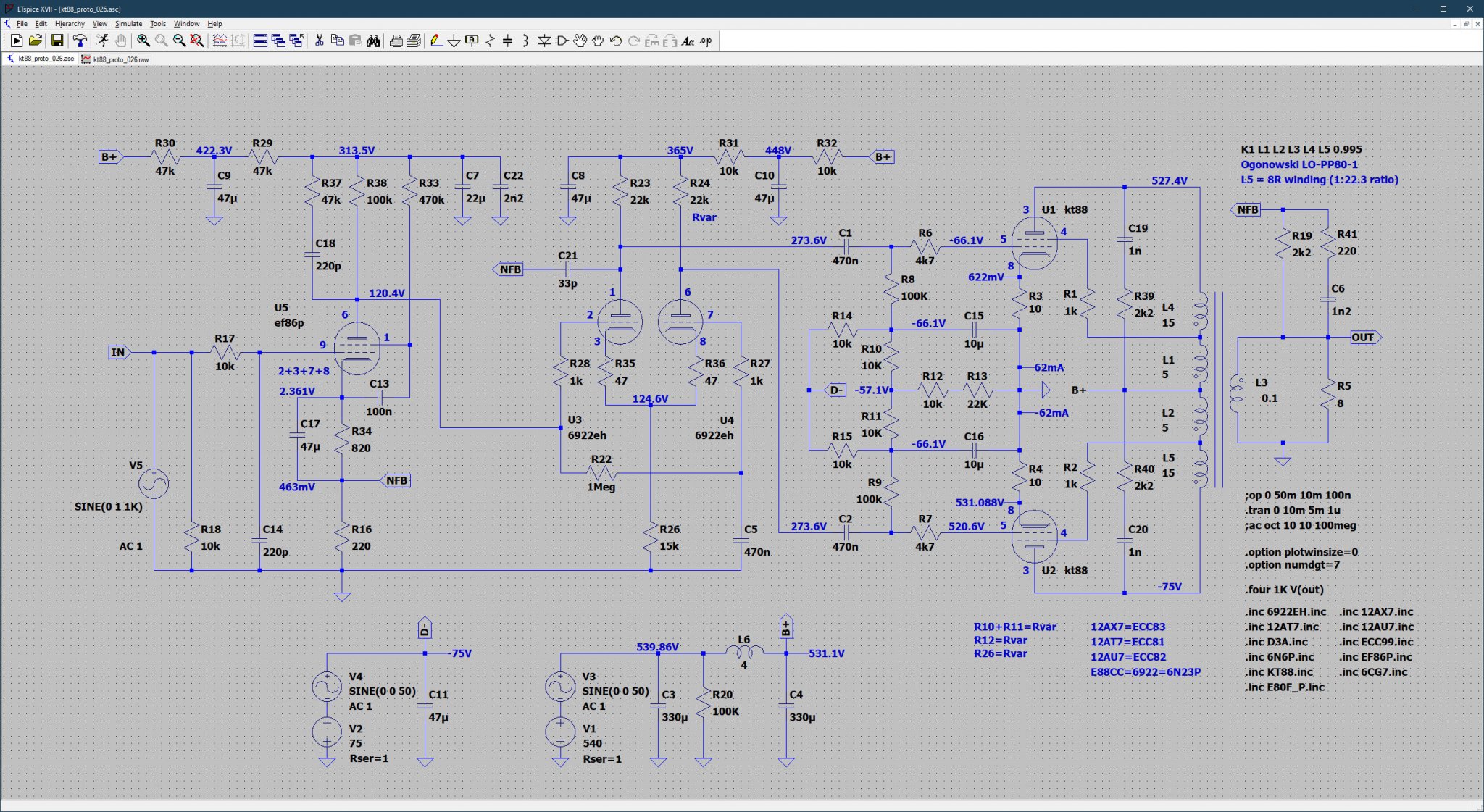

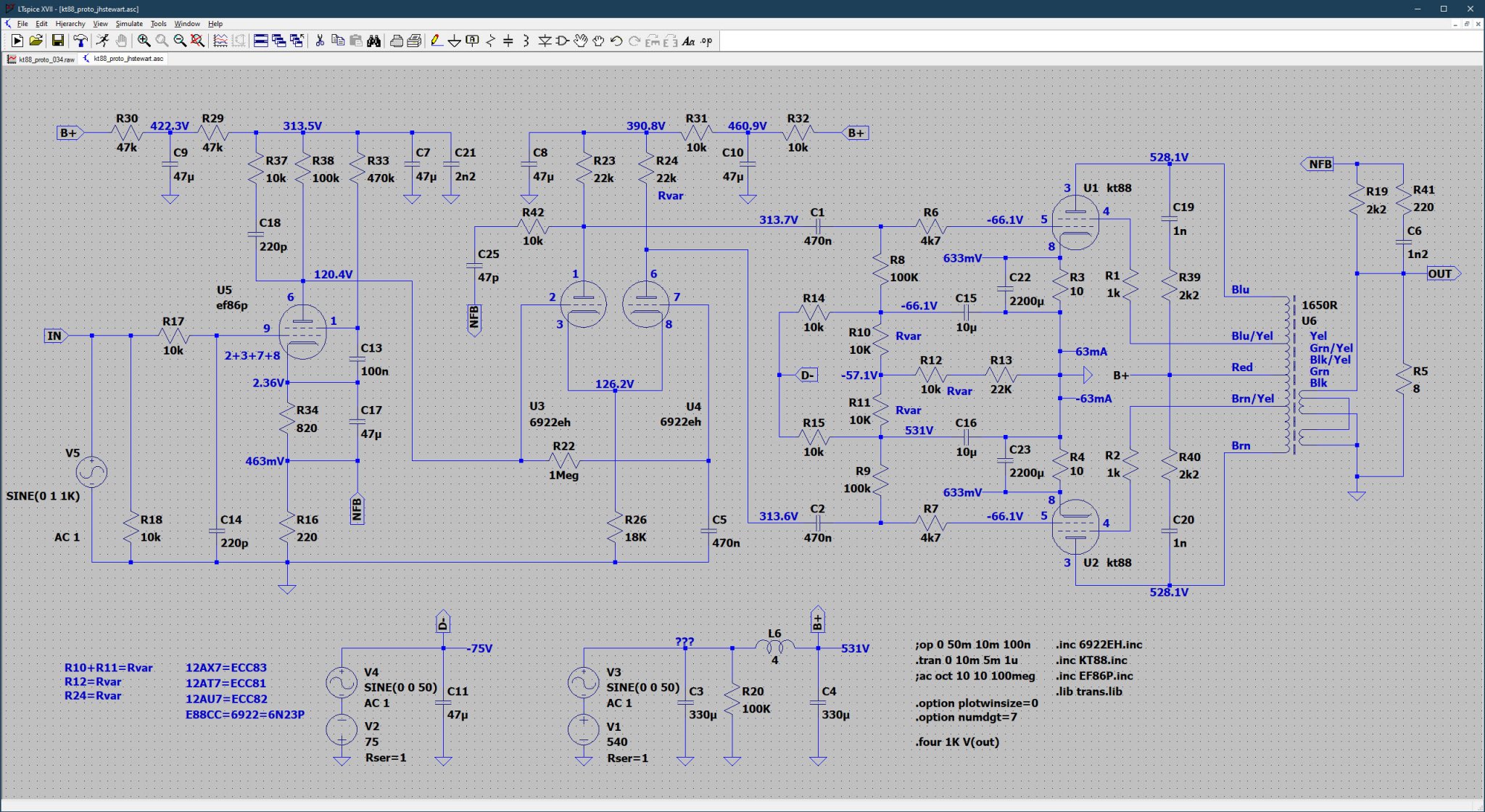

I added these in the schematic, see attached, and ran some simulations, but I get the distinct impression this still doesn't accurately reflect reality?
Nop the leakage inductance sets the coupling factor. The primary capacitance is just across the total primary.

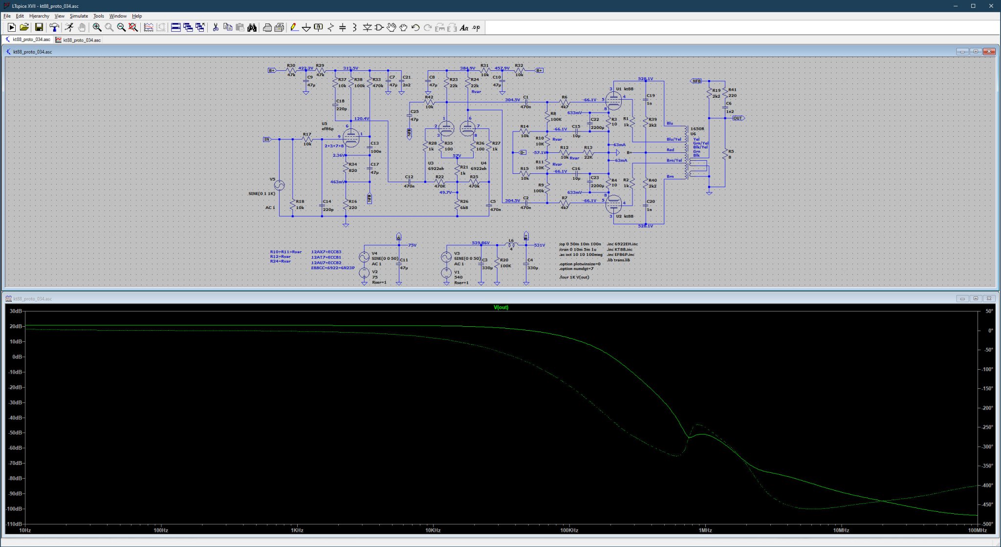

Thanks! I think I got most of it up and running, but for an odd squiggle in the gain plot. Would certainly appreciate it if you could check whether I'm not doing something monumentally stupid though. I have a pair of Hammond 1650R sitting on the shelf, so seemed logical to use that model so I can check the simulation with data from the actual prototype. Screenshot and zip archive with the latest (and greatest?) attached.If your struggling still I can look later today.
Thanks John! I tried your suggestion, but it doesn't result in a working amplifier, the lower half of the sine is compressed, resulting in distortion levels measured to be >5%. In one of my earlier prototypes I tried a similar configuration which also didn't fare too well, please see attached.Problem solved, follow the examples. The Mullard long tailed inverter has no problem driving the output.

Okay John, I took another stab at it, by raising the value of the tail resistor R26 to 18K (from 10K) this results in a working amplifier, however the performance is not at the same level as the configuration I originally posted, please see attached. I think this shows that another mechanism is at play that causes for the THD to rise when Pout>20W, do you perhaps have any other suggestions?Thanks John! I tried your suggestion, but it doesn't result in a working amplifier, the lower half of the sine is compressed, resulting in distortion levels measured to be >5%. In one of my earlier prototypes I tried a similar configuration which also didn't fare too well, please see attached.
I would have concerns taking some of the NFB to the plate of the LPT. This is because when that output valve goes out of conduction in higher power - that part of the loop will no longer have any effect so may make for HF burst on that part of the cycle. Consider taking the NFB just to the first stage.
Yeah, that makes sense, I'm just playing with compensation at this point and this was one of the ideas that proved to be effective.I would have concerns taking some of the NFB to the plate of the LPT. This is because when that output valve goes out of conduction in higher power - that part of the loop will no longer have any effect so may make for HF burst on that part of the cycle. Consider taking the NFB just to the first stage.
It’s not actually feedback from the output back to the 2nd stage plate, it’s nested feedback from the 2nd stage plate to the summing node. It’s the “tube” equivalent of taking the lead compensation from the output of the VAS rather than the speaker out. It’s a trick you can use to get higher levels of NFB before it sings - I do it this way all the time on big solid state amps with massively parallel output stages. The idea is that high frequency feedback (above audio) comes back without the phase shift through the output stage, letting you get away with low fT output transistors. The voltage ”gain” from the LTP through the output tubes and trafo is usually under unity for UL connection. Needs to be in order to work properly. It often takes experimentation to get it right. In a tube circuit, it may help you out with stability margin if your output trafo is rolling off a bit too fast for the level of NFB you want. Just another tool in the box.
Could you zip your latest offering so I can take a look. I have an interest in looking at distortion too. Cheers.
Post #50 has the latest, including your transformer model. Thanks!Could you zip your latest offering so I can take a look. I have an interest in looking at distortion too. Cheers.
Yes thats a large amount of NFB, I guess the series R C across the transformer primary is helping a lot.
To quote Bruno Putzeys: use Nfb and use lots of it … 🤣Yes thats a large amount of NFB, I guess the series R C across the transformer primary is helping a lot.
