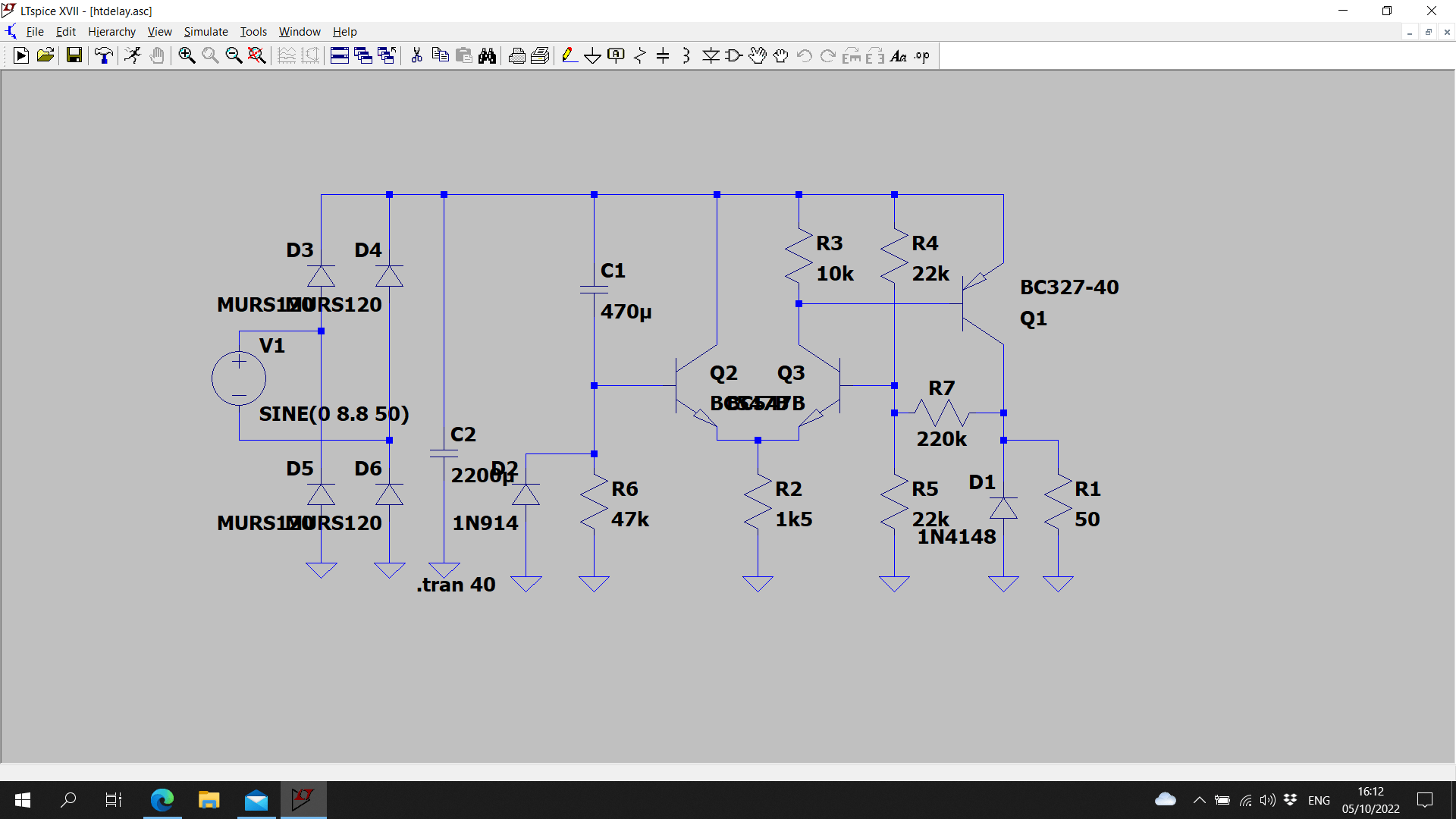

I have a B+ delay. It's two 2k2 very watty resistors connected in series with each AC HT winding shorted out with a relay. But the grids are held negative too on the KT88's so the main caps can charge. Here's my implementation R1 is a 6V double pole relay, V1 is 6.3V AC. You could use an additional small relay to do the grids. A 7555 timer may be simpler. As for the transformer using two 3A windings will be fine.

As for the turn-off ( and turn-on "thump") dave gillespie has written an article about the dangers :
Techniques To Maximize Power Tube Life
In your case it seems that a large pulse emanates from the pre stages and finds it's way to the
power stage, with potential damaging effects.
One way of reducing this is to sequence the power down , power stage first, then pre stage. Or, short
the powerstage with a fast relay before B+ have started to fall at power off. Same relay might also
somewhat protect the power stage at power on.
Same effects may also be present of delayed B+ is applied at power on, a sudden surge might
hammer the power tubes, that's one of the reasons rectifier tubes is beneficial to tube life.

Interesting article. Thanks for sharing. My amp does not have any turn-on "thump" as the tubes are not warm enough to conduct when the B+ is applied. I guess this is OK. I do have a "thump" at turn-off. So I think the solution would be to use a relay to turn the B+ going to the power tubes as fast as possible when I disconnect the AC. This is similar to the protection circuit I have for solid state amps. This has a turn-o delay before connecting the power amp to the speaker terminals and it disconnects the speakers as quick as possible when the loss of AC is detected. I could adapt this design so that when I turn the amp on, I will delay the application of B+ to the output tubes only. The input and driver will be turned ON instantly and the power stage will be delayed let's say 30s. At turn-off, I will disconnect the B+ from the output tubes as quick as possible when I detect loss of AC. I know that the solution presented in the article delays the application of B+ to the input and driver tubes as well. It waits 30s so that the input and driver stages will heat up. And then it waits another 10s to connect the power stage. I'll try to think of a practical way to implement this scheme.
Try and hold on to the negative bias rail for longer. I had issues with this and helps.
I tried increasing the capacitor from the +/-10Vdc rail and this improved the situation a bit, but it did not completely remove the "thump" at power off. When turning the amp off, I see the woofer moving about as all the capacitors discharge, and right at the end I hear a smaller "thump". It will have to do for now. I'll try and come up with a more elegant solution, but for now I'll use it as it is. In the evening, I'll do a test in the evening to see if the very faint light coming from the tubes is still there.

I've just noticed the input has a hum bucker very cleaver. It's a very well-engineered design. Being symmetrical should be thump free on turning off. Your blue glow is the output tubes conducting heavily. Try and arrange for the negative bias rail to discharge more slowly by increasing the main negative res cap. The input CCS needs to remain as active as long as possible.
I added 2000uF on the +10V rail and the "thump" is still there at turn off but reduced. I did not notice any light effects coming from the tubes. I'll keep an eye on this and see if the very faint glow is still here. The challange is ti keep the +10V rail up as much as possible so the B+ voltage has enough time to drop as much as possible.I've just noticed the input has a hum bucker very cleaver. It's a very well-engineered design. Being symmetrical should be thump free on turning off. Your blue glow is the output tubes conducting heavily. Try and arrange for the negative bias rail to discharge more slowly by increasing the main negative res cap. The input CCS needs to remain as active as long as possible.
Change the absurd coupling caps ( 4.7uF) to 0.47 or 0.22uF That will cure most of the thumping andI've updated the schematics for both the amplifier and the power supply.
does not reduce fidelity as the transformers will only transform infra sound to distorsion.
The second CCS I think I would use a zener and get the volts from HT removing the need for +10V. There's quite a bit of voltage across the CCS collector resistor to reduce power dissipation in the transistor - that will narrow the compliance range partially when the HT collapses.
