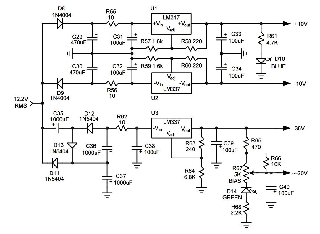

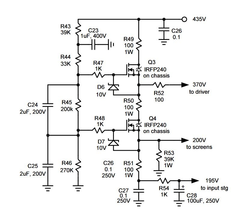

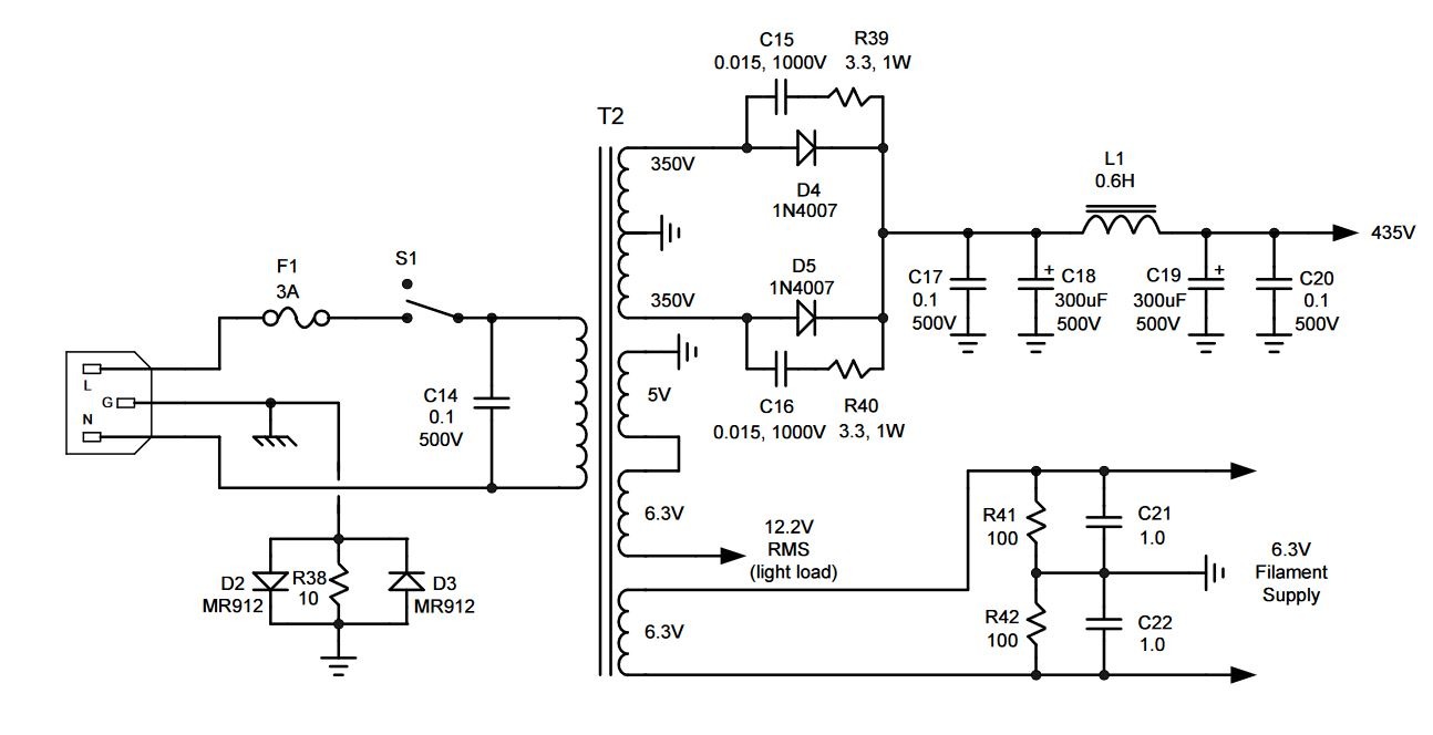

Just to give all of you some more info, in the design made by B. Cordell, he is using old output transformers with 7200OHM primaries and he also recommends another of the shelf alternative with a 4300 OHM primary. The only modifications required if we use the other transformer are the the resistors and capacitors connected between the grids and the anodes of the driver stage tube (12AU7). Bias of the output tubes is set to about 63mA and this will result in a voltage drop of about 200mV over the 3.16OHM cathode resistors. The power transformer is also an old one and it has 350-0-350 secondary that is full wave rectified to about 435Vdc when loaded to 330mA.
Solid state or tube rectifier? That's a quite powerful transformer...>350-0-350 secondary that is full wave rectified to about 435Vdc when loaded to 330mA.
Solid state rectifier. An then a semi-regulated supply for the anode voltages of the input pair and the driver pair.Solid state or tube rectifier? That's a quite powerful transformer...

The general consensus is that the input stages are a lot more susceptible to low frequency noise (power supply ripple). This is valid for solid state amplifiers as well. I've build several of these solid state power amplifiers and I got to experiment with several topologies. The best results were with the ones where the input stage was well filtered. Especially the negative rail. You can clearly see the power supply frequencies on a spectrum analyzer. In the case of your test, maybe there were other differences as well. In my projects I had pretty significant differences between the THD+N (mainly noise) of an amplifier that had no filtering of the rails for the input stage and one that had plenty of filtering.A bit off topic, but I wonder if there is really a need for section regulated fonts etc?
