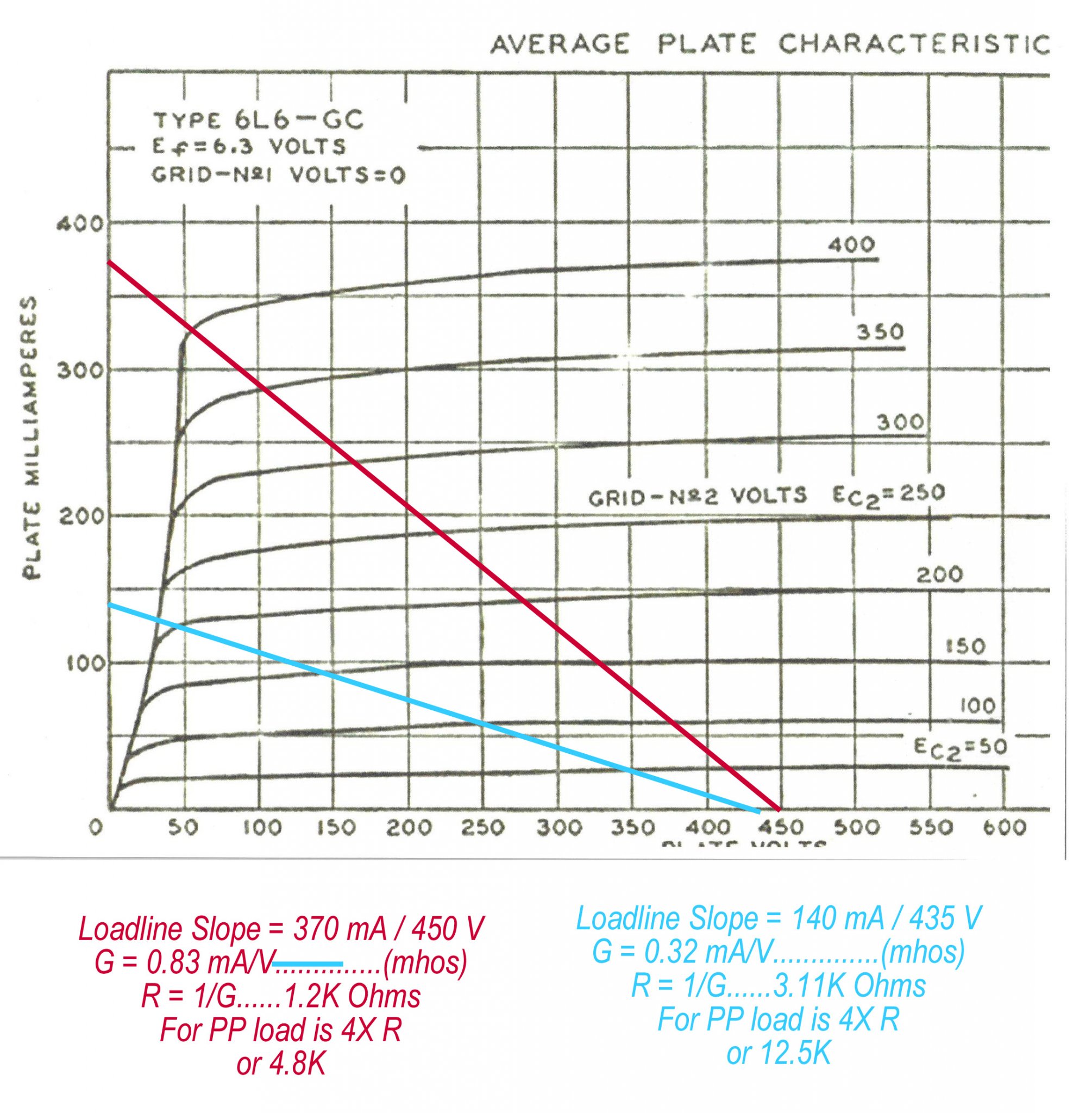

There were many suggestions regards OPTs. But everybody was way off as far as plate to plate load.I'm in the process of building my first tube power amplifier. I've built several solid state amplifiers but never a tube one. I always considered tubes to be inferior to transistors but nevertheless I really liked reading and learning how tubes work (Morgan Jones's book and several websites). All this reading made me wanna build one really bad 🙂. I stumbled upon Bob Cordell's KT88 amplifier presented in Linear Audio. I really like this design and I decided to give it a go. He uses the kt88s in pentode mode and I will use them both in pentode and ul mode. I already have the tubes but now I'm looking at buying the transformers and I'm in a bit o a pickle. I want to use an output transformer with a primary inductance of 6600 OHMs due to the higher turn ratio that yelds lower output impedance of the transformer. I know that output power will not be very high with 6600 ohms but I'm ok with this. I do not know what type of transformer to buy. Toroidal or classic EI ones. I can buy good toroidal transformers from Toroidy (used them in the past for solid state amplifier power supplies) or classic ones from Hammond. Are there any disadvantages of using toroidal transformers for output? I know that toroidal transformers will saturate a lot quicker due to DC but I'm not sure if this is a reao problem or not. Price wise, both solutions are at the same level. Any advice is highly appreciated ( regarding the transformers and the project itself).

Looks like nobody thought about the very low screen voltage. That changes optimum p-p impedance;,
it goes up quite a bit.

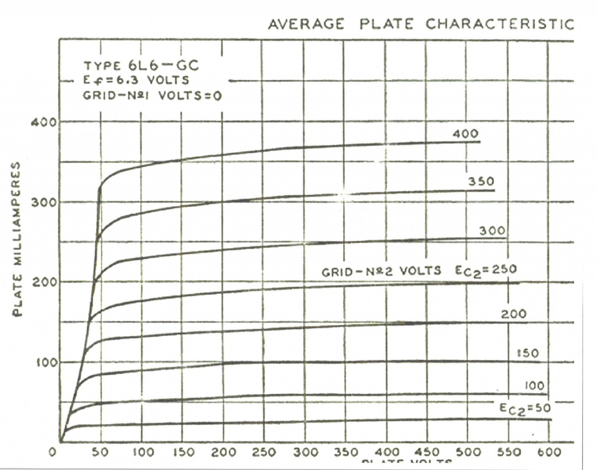

Graphical methods are useful to get the proper p-p load, But one of the best of these needs the plate family
where G2 is the variable, while G1 always at zero volts. I couldn't find that anywhere in either KT88 of 6550 data sheets,
So to demonstrate the method I've used the plate family for the 6L6GC. This is accurate for Class A, less so for Class AB.

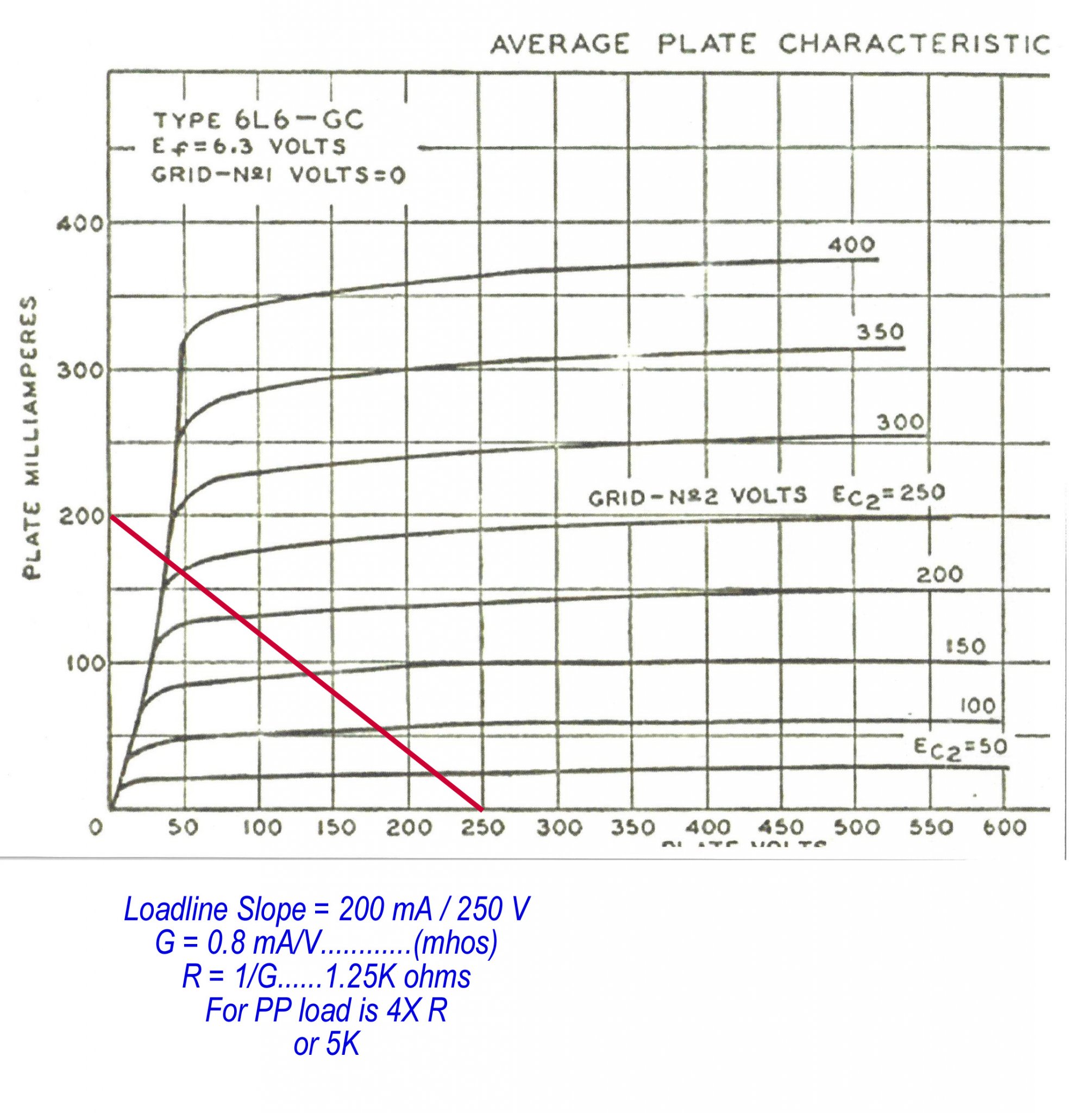

Start by drawing a loadline from the plate B+, then thru the knee of the G2 intended voltage.
For the PP 6L6 at 250V plate & screen the result obtained is 5K, just as published on the data sheet.
For the 6L6GC plate at 450V & the screen at 400V we see 4.8K Not quite the published spec, that is for Class AB.
Another loadline at plate 435V & screen at 200V looks like 12,5K.
That is a significant change caused by a different screen supply.
The best loadline can also be determined on a working circuit. But that assumes a usable CT OPT is available.
Easy to do, but another story.
