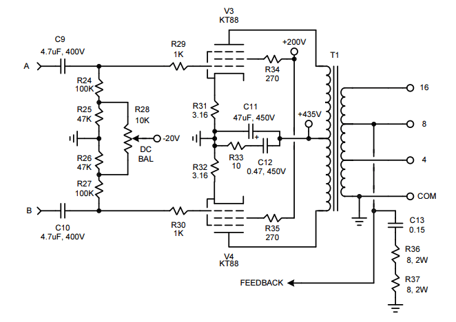

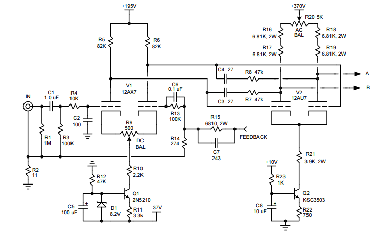

Hi @horias2000
Very well executed design and nice layout, congrats on such a nice looking amp. I like that you are mixing both SS and vacuum components. If possible I’d also appreciate if you could share the power supply and amplifier Gerbers files. I guess 2 zipped files each having the regular 11 files.

I'll happily share the gerbers but you'll have to give a few day as I just realized that v.2 is not done yet. The latest version has some changes implemented that the first version didn't have. I had to add a few components. I will finalize the second version and share it later this week (maybe in the weekend).
No hurryHey guys. Sorry for not posting the gerbers yet but I was busy with other stuff. I did not forget and I will post once I get the chance to finish v.2. Not much to do but I just didn't have the time for this.
