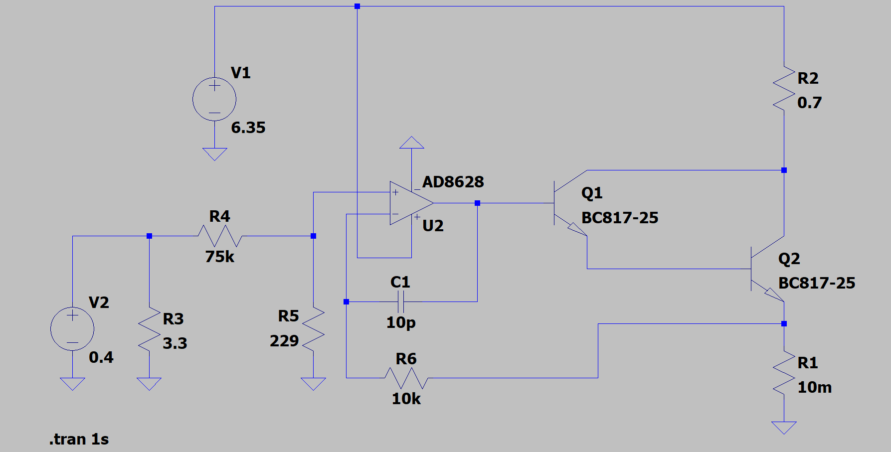

My approach would be to implement something like in the picture below:
R3 is the cathode resistor, R2 would be the milliamp meter and R5 would be adjustable. This circuit has a very low error on the scale I'm interested on. It will be supplied from one of the 6.3Vdc regulators that I use for the filaments of the input and driver stage. During normal operation I have around 190mV on the 3.3R resistors (~57mA) and the circuit will draw around 58mA from the 6.3Vdc supply. I will add a rotary switch before R4 and in this way I will be able to switch between all four tubes.
AD8628 supply voltage should be 5V. Add small resistor from op-amp output to base of Q1. R1 is quite small do you need to make the voltage to the op-amp input so small ie is R5 needed?

I can also interrupt the shunt resistor (loop of wire) and use it as a voltmeter. I will then add a voltage divider with one of the resistors adjustable to be able to align the values.
After cutting the shut wire, the resistance of the meter itself is around 13R. By adding a ~73R resistor in series with the meter it should be ok. I will have full scale at 330mV over the 3.3R resistors. The only thing is that when the meter is connected, it will add 2.2mA of current through the tube I'm measuring (on top of the 57.6mA that goes through the tube). This will definitely create a small imbalance but I'm not sure whether this is something to worry about or not.
Nop but you could have an off position. It may create a click though in the speakers. If its a problem just add a unity gain buffer opamp.
Yes, I will use a buffer so that I will not disturb the current through the tubes. I will probably use a general purpose opamp like the tl072 or similar.Nop but you could have an off position. It may create a click though in the speakers. If its a problem just add a unity gain buffer opamp.
OK the KT88 cathode impedance Zo ~ 1/gm = 1/12*.001 = 83R. The cathode current is dominated by the KT 88 not by the 3R3. So the change of 100R across the 3R3 will have virtually no effect on the cathode current and therefore the operating point. So direct connection is fine - forget the op-amp. I am sure Mr Summer can explain this better. Clever solution to remove the shunt I was guessing you already had the meter. Also means the graticule is correct.
I think I understand what you are saying. The current through the tubes is not limited by the 3.3R resistors. Terese are just used so that we can measure the actual current that goes through the valves by using a simple voltmeter and not having to add an ammeter in series. So it does not matter weather these resistors are 3.3R or 1R or 10R. The current through the valves will be the same, just the voltage drop over the resistors will be different based on their value. You can even connect the cathodes directly to GND. This means that adding the meter will have no impact on bias current. I will make the modifications on Friday and I will post the results.OK the KT88 cathode impedance Zo ~ 1/gm = 1/12*.001 = 83R. The cathode current is dominated by the KT 88 not by the 3R3. So the change of 100R across the 3R3 will have virtually no effect on the cathode current and therefore the operating point. So direct connection is fine - forget the op-amp. I am sure Mr Summer can explain this better. Clever solution to remove the shunt I was guessing you already had the meter. Also means the graticule is correct.

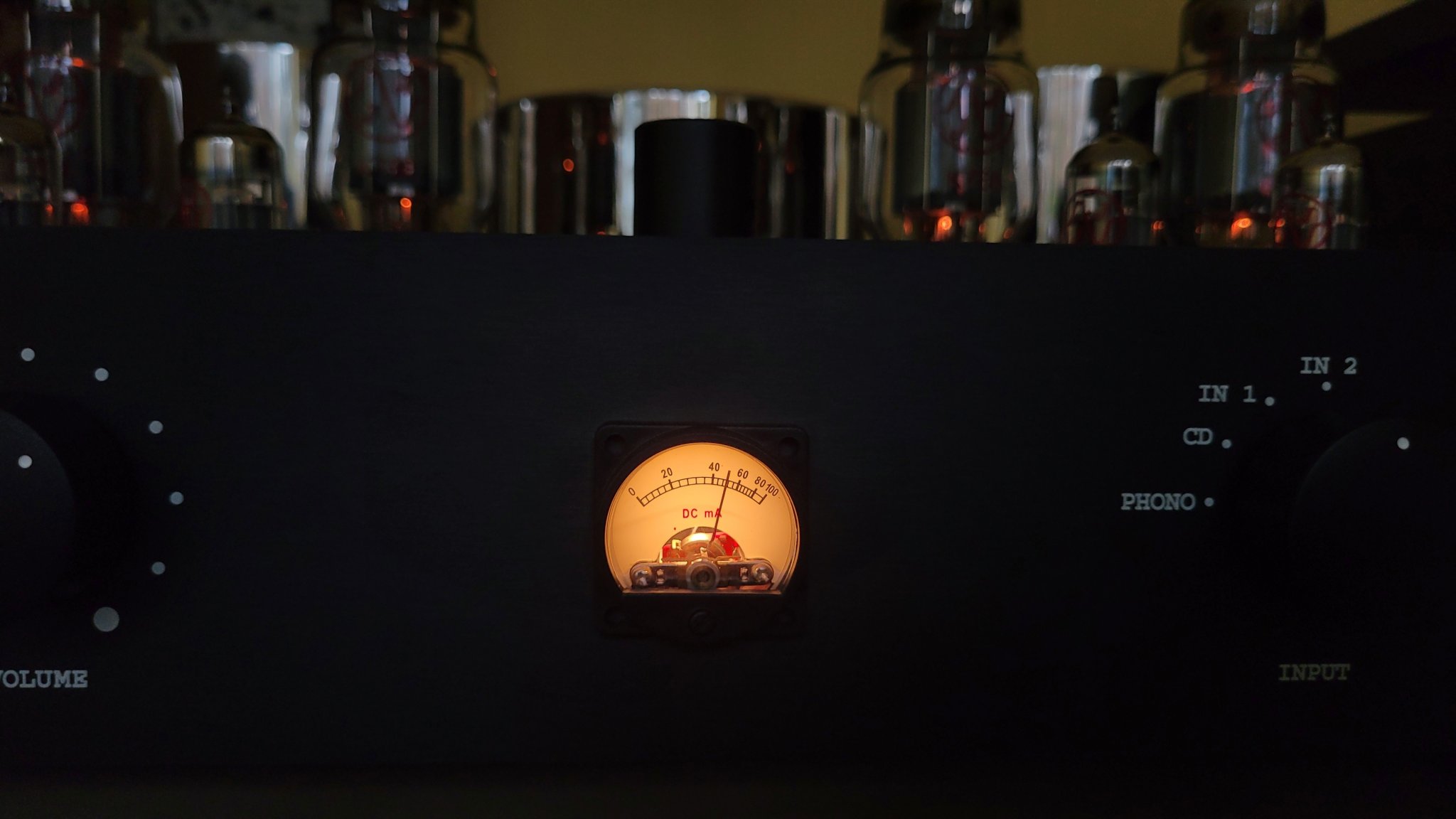

Indeed I already had the milliamp meter. It measures up to 100mA and I must say the precission of these milliamp meters is excelent. I tested one with a calibrated desktop multimeter and the readings were exactly the same. I was really surprised to see this 🙂
For 50ma adding a 100R across the 3R3 will change the voltage on the cathode by 5.3mV. This will change the current I = Vgm = 0.064ma. I think that's right? The shunt is probably trimmed to match the movement. I think as long as Rcathode << 1/gm this applies.

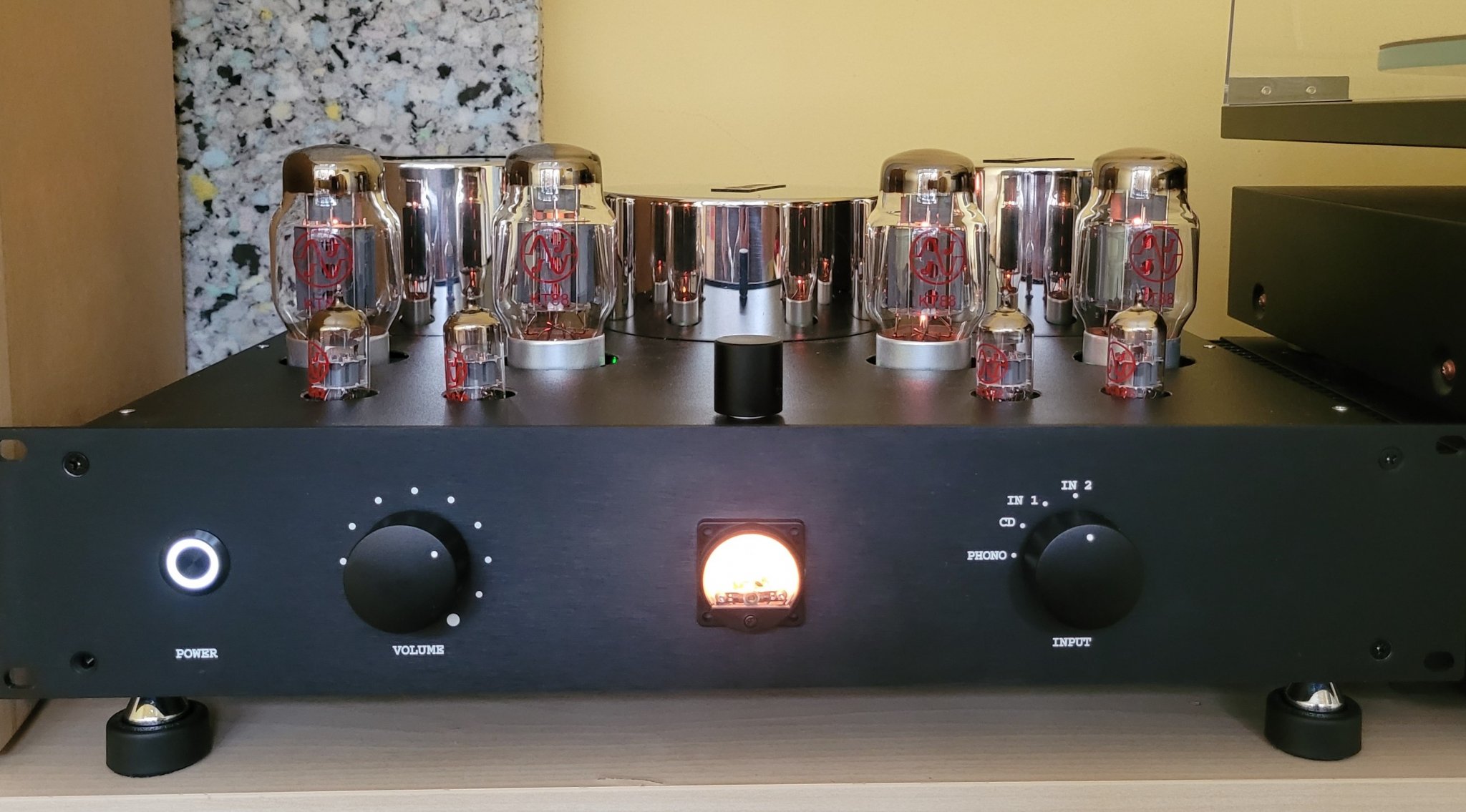

I decided to use an opamp as a buffer before the 73R resistor and the meter. In this way I know for sure that the current going to the meter will not affect the current going through the tubes. I had a few AD8655s from another project and apart from the odd pinout, these should work like a charm. And indeed, these worked just fine. The only slight inconvenience was that AD8655 has a max supply voltage of 5.5V. But tat was ok as I had a few 5V LDO regulators laying around 🙂 (I know, I have many parts just laying around, maybe too many 🤦). I also added a rotary switch (non-shorting) on the input of the opamp and now I can see the current through all four tubes. I think that this concludes this project. At least for now 🙂.
