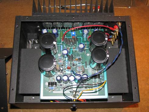

When Carlos and his constructing friend mount the finals to the heat sink assembly it should look a bit like Steve's amp shown here. You can see the output transistors and how they mate with the PWB and the heat sink. I don't have a photo of the tracking diodes mounted on the heat sink as they are mounted to the heat sink below the PCB and I couldn't get in that close to see 'em. I'll try to get a photo when I go over to Steve's place in a week or so. By then Carlos and party may have theirs finished tho and can show us a photo of what the diode assembly looks like mounted to the HS.

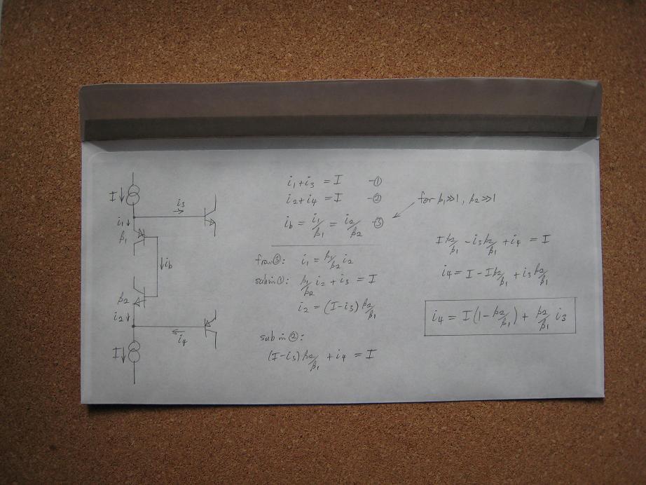

if Q2 is less saturated then Q1 than Q2, it's beta will be higher, (B2>B1).
Let's just pick two random values that match that criteria for saturated Betas.
B2=10, B1=5.
What value is predicted for i4?
Could i4 be negative?
What does that tell us?
Thomas-
If you go to Steve's and he has the components to assemble my PCB's can you get them and ship them to me? It will take more out of his stock / inventory and I think help him more than Mouser.
All-
On Carlos' board he just showed the small cap on the left in the back of 5 was jumpered but on your picture it is there. Is that a different revision of the schematic negating the need for that component?
I hope to build one just like the photo Thomas posted but different case / heat sinks.
AndrewT said:
post 1099.
B2=10, B1=5.
Hi Andrew,
In practice, the ratio of the betas will never get that far from 1 because the driver base current difference would be huge. I don't see why i4 could not go to zero...beyond that it would cut off and any further current would be drawn from the 1uF cap (in the actual circuit). If there were no cap I suppose the pnp base voltage would continue to rise (reverse-biasing the pnp driver) until Q2 saturates enough (lowering its beta).
The cut-off condition can be derived from the formula by setting i4=0 and solving for b2/b1:
b2/b1 = I / (I - i3)
Of course, either driver can also be cut-off by a large enough difference between Vin and Vout - which will occur with large output current.
Brian

troystg said:
Thomas-
All-
Hi Troy - I will be glad to ship stuff to you but I know that Steve is providing parts for his PWB's so contacting him directly will most likely result in you getting the parts quicker.
The missing cap that has been replaced by a jumper on Carlos PWB is the correct revision. That cap is eliminated from this version of the amp and replaced by the jumper. If you already have Steve's PWB's I can send you some photo's I have of the component placement - but only if you already have PWB's that have been provided to you by SD. I'm not trying to be a hard-axx here - just looking out for Steve and his IP.
I did buy a set of his PCB's.
I posted the picture of my set with the cut holes for the transistors if you recall.
He offered to sell me the components but I was in the process of building some other stuff at the time and didn't think I was going to get to his boards so soon.
I would certainly email Steve and request the parts, but I would hate to have to make him ship them in his condition. THAT is my motivation for asking you to get /ship..

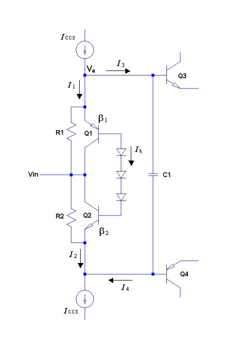

Here's my attempt to explain this bias circuit in a reasonably brief and simple way. The circuit is a little unusual. :usd:
See diagram below. I have simplified SD's circuit by removing the input "diamond" buffer transistors because they are not needed to describe the behaviour. Also, I have explicitly shown the output resistances, R1 and R2, of the bias transistors (sometimes called hox; the Early effect). Typically, these are very large (tens of kohms) but when Vce is is very low they drop to very small values. This is because the current gain of the transistor, or beta, becomes very sensitive to changes in Vce.
Two, brief ways of describing the circuit operation:
1) Transconductance
Consider the upper half of the circuit. There is a current I1 flowing through Q1 (R1 is internal to Q1). There is a base current I3 flowing into the driver Q3. There is a CCS whose current must equal I1 + I3.
When Vin increases relative to Va, the Vce of Q1 decreases, and the current through R1 decreases, so I1 decreases. As I1 + I3 is constant, I3 must increase by the same amount. The transconductance is approximately 1/R1.
Note that R1 is non-linear...the smaller Q1 Vce is the smaller R1 is. R1 is like having a resistor in series with the driver's base...so it needs to be small enough to adequately tie Vin to Va. The nominal value of Vce is set by the diode chain.
2) Beta ratios and current flows
There is a relationship between I3 and I4 because the bases of Q1 and Q2 are connected together:
I4 = B2/B1.(I3 - Iccs) + Iccs
If B1 = B2 then I4 = I3. When Vin increases relative to Va, I3 increases and Q3 turns further on. B1 decreases because the Vce of Q1 decreases, and simultaneously B2 increases because Q2s Vce increases. The ratio B2/B1 increases and this causes I4 to decrease relative to I3, turning Q4 further off. It is possible in principle, if the beta ratio becomes large enough, for I4 to become negative, in which case Q4 turns off and the excess current flows into C1.
Hope this helps.
Sorry, but I can't really describe circuits accurately without using some maths. :sorry:

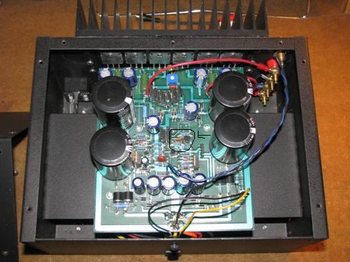

Hello good afternoon to all ...
I am a friend of carlos goosander and I am making the amp. Dunlap's got some doubts ..
which the value of the cap. C2 that this side of the transistor Q5?
not found in the same schema ...
grateful for the attention of all
Hi Robson - it's is good to see a friend of Carlos the Destroyer here!! Welcome!! 😀 😀 😀 Thank you for building this amplifier for Carlos while his health is not so good - you must be a very good friend to have!
I have asked Steve about this capacitor in the past - and it is very rare that it is used - most likely not required. It is used to stop high frequency oscillations if I remember what Steve told me. If it is required I am not sure what value it would be. Hopefully he will check in and give us some information. 😉
Hi Thomas,
That gives us a very good idea what the part is and possibly the approximate value might be. Do you have a schematic, the one for the board? The cap is probably in parallel with a resistor. If you find the resistor on the PCB, you can identify where it is on the schematic and "pencil" it in on the schematic. The position of this capacitor may suggest a value for it.
-Chris
This is what Steve wrote about it:
"You are correct about C2. I left a place for it if it was needed. The value would be 30pF or less. I never had a problem but this makes it easy to correct if there was one."
anatech said:
Hi Thomas,
-Chris
A reply from Da Man: C2 (if needed) 5 to 12pF. 🙂
It is there to prevent oscillations -
