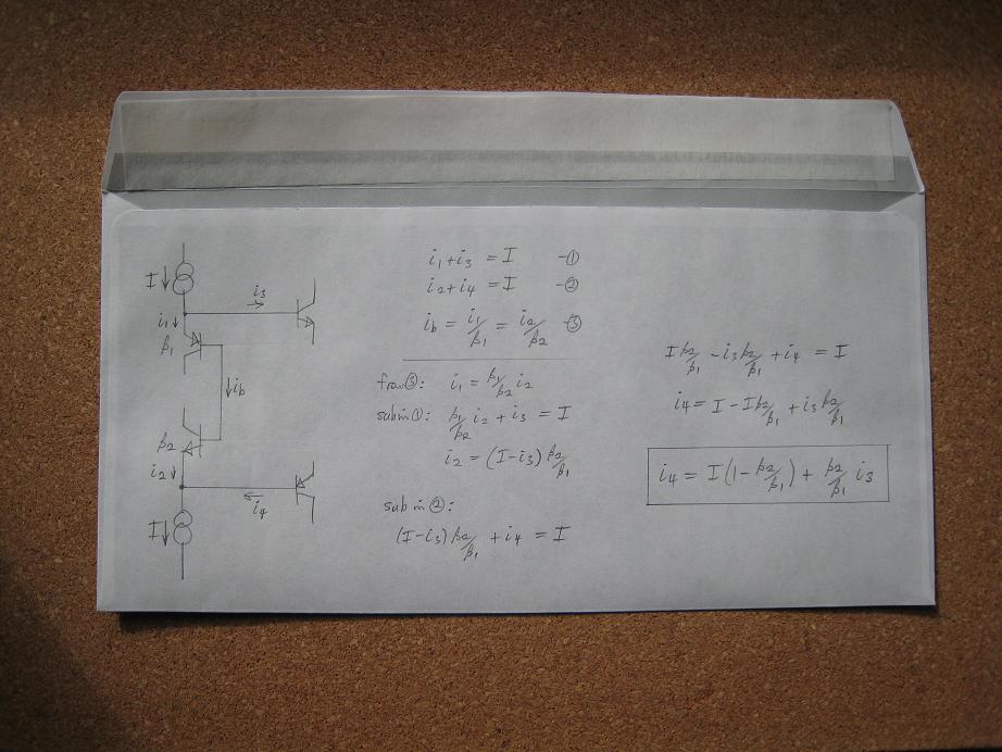

Hugh,
Atached is other "configuration" of Krill OPS.
If we look Q2 and Q4 they looks like cascode of Q1 and Q3 ( besides the base of Q2 and Q4 are not fixed voltage as normal cascode configuration ). So, the base impedance of Q9 and Q10 works as loads from those cascodes. But the input this circuit is on the "load" from that.
Is it a inverted use of cascode?
Or I´m foolish ?
Ed
Or I´m foolish ?
Ed

Hi Ed,
The circuit certainly bears some resemblance to a cascode, since it is a couple of transistors one on top of the other. However signal is applied to Q9 base and taken from Q2 emitter; normally, in a cascode, we would take the signal from a collector. So strictly, it is not a cascode.
Therefore, for this reason, it is not used as a cascode, since there is no voltage gain here. It's used as a unity gain tracker.
The input circuit seen by V3 (from your revised diagram using 5200/1943 outputs) is very high, as it is dominated by the collector loads of Q2 and Q4, both very high, seen by the Q9 and Q10 emitters, multiplied by the betas of Q9 and Q10. In practice, a bias resistor would be connected between bases of Q9/Q10 to ground, to reference signal to earth. This resistor would principally set the Zin, and a good value would be around 33K.
I have been discussing this circuit with Terry Demol, an Australian living in Sydney, and he graciously pointed out that I have missed something in my explanation. There is another mechanism operating in this novel circuit which is responsible for accommodating the very large increase in Vbe which takes place as the output devices switch on hard. This increase will be from 0.6V at quiescent to about 1V at 8A, based on the curves. Clearly as one side of the OPS turns on hard, the diode bias string passes less current, and this means the voltage drop across it must DECREASE. Something peculiar is happening here, since to keep all output devices on, the voltage across the diode string must INCREASE with increasing drive.
The truth is, it's two processes. The first, already discussed in post #1070, is the fact that as one side of the OPS turns on, the driver bias current increases, robbing the diode bias string of current it receives from the CCS on the rail. That much has been explained. But this does not explain how the voltage increases between the emitters of Q2 and Q4, ensuring the inactive side remains on.
Since the CCS on both rails always source/sink a constant current, Kirchoff's Law holds that the current sums at a node must net zero. So if we have 11mA coming out of the CCS, and 1mA is passed to a driver base, then 10mA must pass to the Q2/Q9 and Q4/Q10 devices. So how does the voltage between the emitters (and hence the bases) of Q2 and Q4 increase when the output current starts to increase on signal peaks and troughs?
When Q2 and Q4 are driven close to saturation, and this voltage, Vce, influences operation. As the Vce on a transistor drops, a knee on the curve takes effect and the beta of the transistor drops precipitously, meaning that in this application Vce must change as collector current reduces. As a positive going signal rises higher, more and more current flows through the output devices, and less current flows through Q2.
Q2 has less current through it, but reacts by reducing its Vce, 'squeezing' more voltage at the collectors of Q2 and Q4 for the same voltage across the diode string. But reducing Vce rapidly drops transistor beta, resulting in a massive increase in bias current passing down the diode string. This increases voltage drop across the diode string (their dynamic resistance is high, around 300-400 ohms, and Q4 also adjusts its Vce so that it passes the same current as Q2, forcing the bias from the base of Q6 to rise, keeping the inactive output stage side always on.
So the voltage across the diode string does increase as each OP side alternately turns on hard, and this does put more voltage between the emitters of Q2 and Q4, which drives the driver bases.
The purpose of C1 is merely to slow this up and down cycling of potential difference so that transitions are kept relatively relaxed and smooth, reducing distortion.
Thanks Terry, this is very interesting!! No doubt about it, this is a complicated circuit, with a very low component count.
Hugh

I think this circuit functions basically as a triple EF.
Here is a rough equivalent? circuit. It looks to me like all the
extra machinery is for Vbe multiplier/thermal compensation
(Q9/Q10 and associated circuitry).
Not criticizing, just trying to understand it. I'm also
wondering what role the CS's play in this, because they
aren't really needed in this equivalent? circuit.
