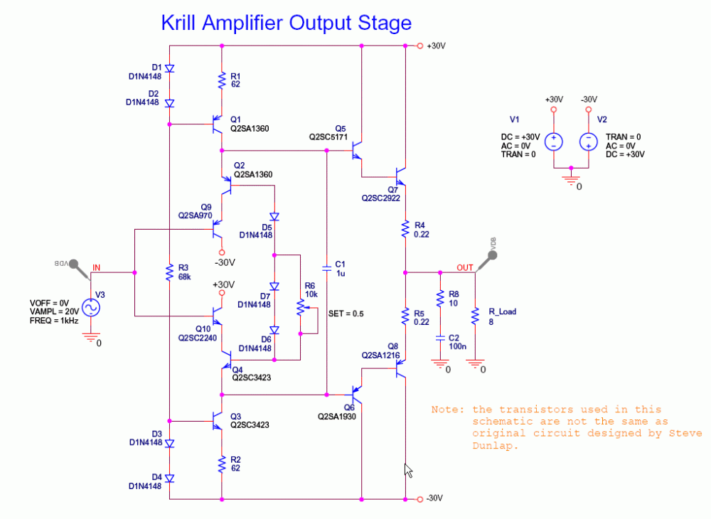

There's been a lot of confusion about how Steve's circuit works. I've run this by him, and he's OKed this description which relies on the attached basic schematic:
1. Input goes positive, lifting base of Q9, and with it, the emitter of Q9.
2. As emitter Q9 rises, it eventually starts to saturate Q2, but Q2 is passing a constant current from the CCS at Q1, so it CANNOT turn off. Fortunately, both the base and the emitter of Q2 are not set at a fixed voltage, so that to accommodate current flow from the CCS, they can actually move up and down in voltage under drive from the emitter of Q2 without constraint.
3. So, as Q9 emitter moves up, Q2 responds by moving up with it since emitter and base are not controlled or fixed. But as Q9 moves up, the voltage across Q2 (Vce) starts to reduce, close to saturation.
4. As Q9 emitter moves higher, it turns on harder the driver (Q5) and its associated output device (Q7). The base current required by the driver rapidly starts to rise. This means LESS current passes to the emitter of Q2. In turn, this means LESS base bias needs to be drawn from the base of Q2 to maintain current through it, and so less bias current flows down the bias string.
5. With less current drawn from the base of Q2, less current must now pass to the base of Q4, since any current entering the bias diode string can only be injected into the base of Q4. So Q4 MUST pass less current as well since its bias is reduced. In fact, the current passed by Q2 is pretty much the same as that passed by Q4; this is a direct result of the shared base bias of Q2 and Q4.
6. With Q4 now passing less current, any shortfall must be drawn from the base of Q6 since the CCS sinks a constant current. The voltage at Q4's emitter will slightly adjust to keep Q6 on, however, so even with the positive side of the amp passing many amps, the negative side will still stay on.
The complementary mechanism applies for negative input swings so that the output stage devices, all of them, will ALWAYS remain on. A question remains, however, how do we set the minimum and maximum currents in the inactive side whilst keeping a reasonably low quiescent? I suspect it's just device choice, very important to have the right diodes and transistors.
This is a highly creative circuit, but it is subtle and unusual, because the drive passes through a collector, not the usual base or emitter. It's a tricky topology to understand, and this has led to many different interpretations, not least a diversity of simulated distortion profiles. The criticism of the designer is to be expected; people generally deride what they cannot understand.

I think I understand this in my simplistic way, so two questions occur to me
- conceptually what conditions determine the null point?
- Ostripper is correct that the diode string & Bias transistors are intimately connected - again what is the condition necessary for deciding this combination - the current range in the diode string between max pos swing & max neg swing of input signal?

Hi John,
If by null point, you mean idle condition, where no signal is passing, then this is simply the voltage across the diode string, and the resulting voltage between the emitters of Q2 and Q4. This takes account of the saturation voltage of these transistors, the Vce, since this must also add to the voltage across the diode string.
It is the bias voltage from emitter Q2 to emitter Q4 which determines the quiescent current of the output stage. Typically this is 2.40 volts.
I cannot tell you this with any accuracy, as simulations are not particularly reliable with LTSpice, and I've not built and measured the circuit. You'd need to measure it on a working example. However, a little calculation could reveal the ballpark; both CCSs are set to approx 11mA, and for output device quiescent of 50mA, beta of 80 and driver beta of 100, the driver bias at quiescent would be around 50/80*100 = 0.00625mA, or 6.25uA, a tiny percentage (0.057%) of the CCS current.
This would mean that nominally 99.943% of the CCS current flows into Q2/Q4 in the quiescent state.
As we ramp up the output stage, say the positive side, to 2A (2000mA), the bias draw at the driver increases to 0.25mA - and probably a bit more because with increasing output current the output device beta tends to drop slightly. Let's assume 0.3mA. So now only 10.7mA flows to Q2, and this reduces base bias from say 11/150 = 0.073mA (based on beta 150 for Q2 and Q4) to 10.7/150 = 0.071mA. This reduced bias is fed to Q4, too, of course, and results in less current passed through it and a bit more passed to the driver Q6.
If the output stage were passing 7A, let's say, and beta of the output device dropped to 60, we would have a bias requirement at the driver of 7000/60*100 = 1.167mA, assuming driver beta does not drop. This is subtracted from the 11mA of the CCS to give us 9.833mA through Q2, reducing its bias requirement from 73uA to 65.5uA. This is not much, and easily unbalanced if the diode strings and Q2/Q4 suffer wandering temperature. Steve runs his Q2/Q4 at higher temperatures with minimal heatsinking to eliminate the effects of variations in ambient; a very good idea.
As alluded to earlier, the disadvantage of this clever scheme is the susceptibility to temperature effects; I've not built it, so can't comment further, but it would, I think, be very sensitive to temperature changes at Q2/Q4 and the diode string. The outputs substantially drop Vbe with increasing temperature, so quiescent control would need to be fine tuned by placing one or more of the diodes onto the heatsink. A fair bit of experimentation would be necessary to get this right; I think Steve has it nailed, but operation in very cold climates might be problematic since there is a greater range of temperatures from switch on to full output.
Thanks again Hugh
Your gentle, calm manner brings a needed air of quietude to this thread! Much appreciate your learned, exemplary & generous approach to this circuit.
What I actually meant by the "null point" was the null point of THD that Steve had alluded to. But no need to answer this as I suspect it's only ascertained by measurement.

Hugh this is not my concern. Ground the input and force +-2.5A into the output. At 25mA bias this represents (at least) two decades of current modulation between N and P halves or ~+-120mV of movement in the output. I don't see the tanh() component of this reduced to 50ppm at only 5-6mV across the degeneration. Steve stated explicitly that the differential voltage across the bases of the output devices does not change. Cancelling the inherent Vbe vs. Ic transfer function with a current depending on three betas does not fly.
This can be done on pencil and paper no simulators needed.
