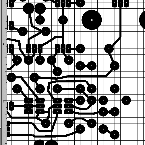

Krill amplifier
Hi folks
Would it be possible to have the layout of this amplifier?
I would like to build it after so many good things heard on this thread
about the Krill.
Hi folks
about the Krill.

By Jmateus -Would it be possible to have the layout of this amplifier?
I don't know, I heard Steve was selling boards... So , I don't
know if posting a board would be acceptable.
I am doing my triple EF , a krill variant ,AND a standalone
Krill output stage. The thermal considerations are "stumping me"
on one hand I see carlo's board with no heatsinking , but
my fingers tell me
I'm not sure what VAS I will use on the "full up" Krill.
OS
my fingers tell me![]()
the CCS /Vbias need SOMETHING!
OS
The latest photo that Carlos shows (post #1096) is the PWB's that Steve is selling and that he had me send to Carlos for his evaluation. The photo does not show the final driver transistors hooked up or mounted to the heat sink - which is where the thermal tracking diodes are mounted.
No I don't think posting the board would be just - Steve has given us this schema & he has boards (which was not the reason he started the thread) so I think in all fairness his IP should be protected - give the man something back for his generosity shown here!
Good on Ya, OS - three variants - should be interesting
No Heatsinking on DX board - I wonder is this the root of his big offset problem on his old board?
Edit: cross posts with Thomas
That much I know..but , I was talking about the 6 - to-126's.
Running at 8-10mA CCS, they are HOT!! It gets 40C here and
with that much heat, semi's don't last as long. I was thinking
of bolting all 6 to a 1" strip of aluminum flashing, at least.
OS
