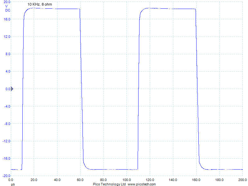

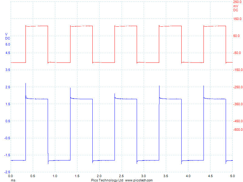

Krill construction thread - 100W version
10 KHz, 8 Ohm

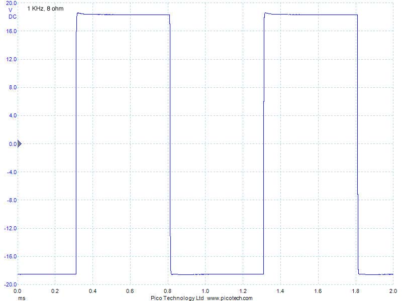

The input filter seems to have cleaned up the 10kHz square cf the 1kHz square.
What value have you set?
Hopefully S.D. will give us some hints on where to apply compensation and the best signals/loads to help determine what that compensation should be.

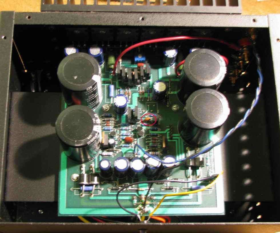

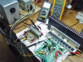

But....... there is a Krill picture from the other thread that shows the C2 cap (circled in red), which makes sense for an amp intended for commercial sales.

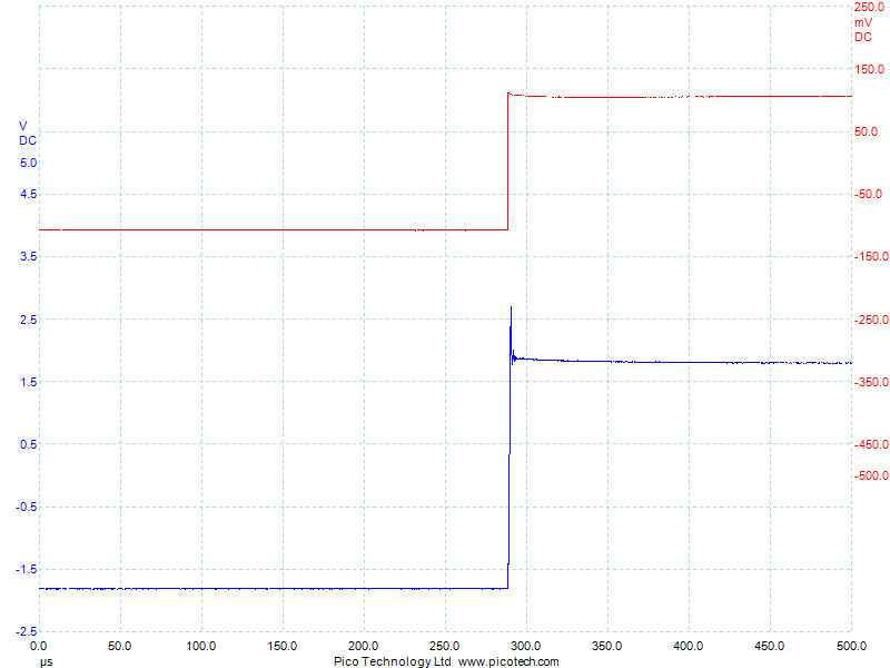

10 kHz square, 8 ohm load
EB/Krill
Top trace is input, lower output with 10x probe. The cycle or two of ringing is most likely an artifact of the setup. There was some oscillation when connecting the Borbely front end to the Krill o/p. The solution was a 4.7k isolation resistor between the two stages.
The Borbely DC-150/Krill combination is the one I will build for listening. I'm currently using 2 modified Parasound HCA-3500 amps, each one bi-amping a Mirage M-1si speaker. So I'll build two stereo EB-Krills at 160W per channel. I have the Borbeley stages already built and the Krill o/p stages are simple to build so hopefully it won't take long.
