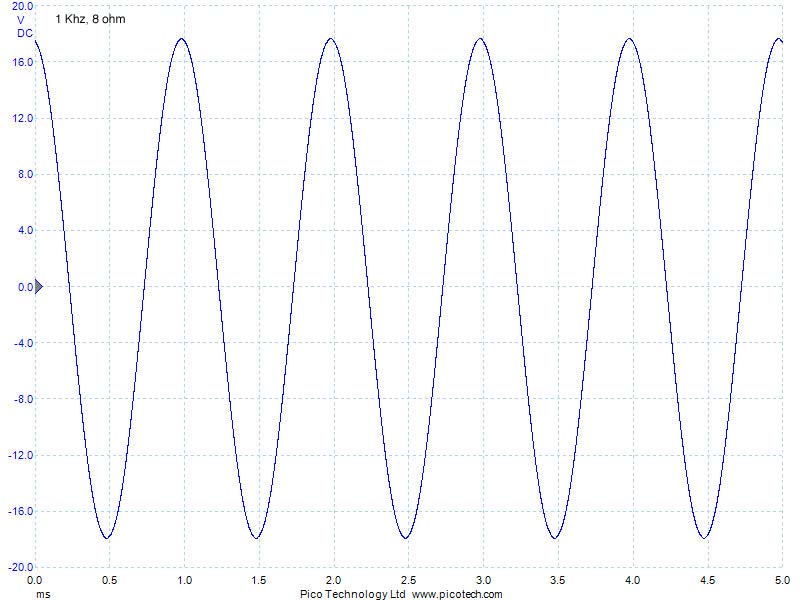

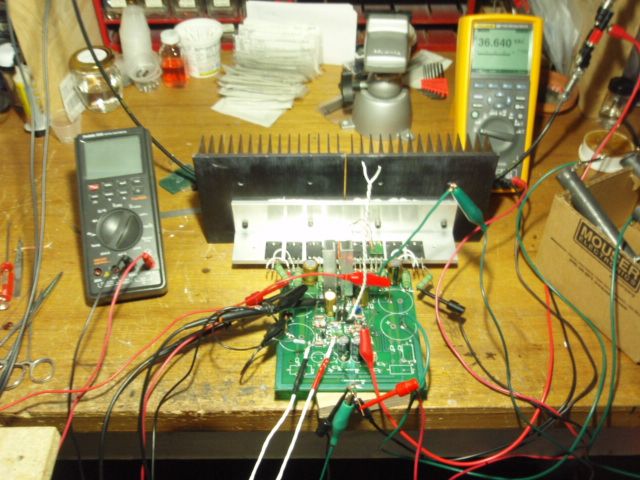

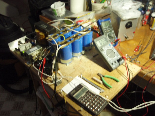

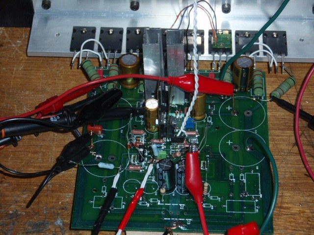

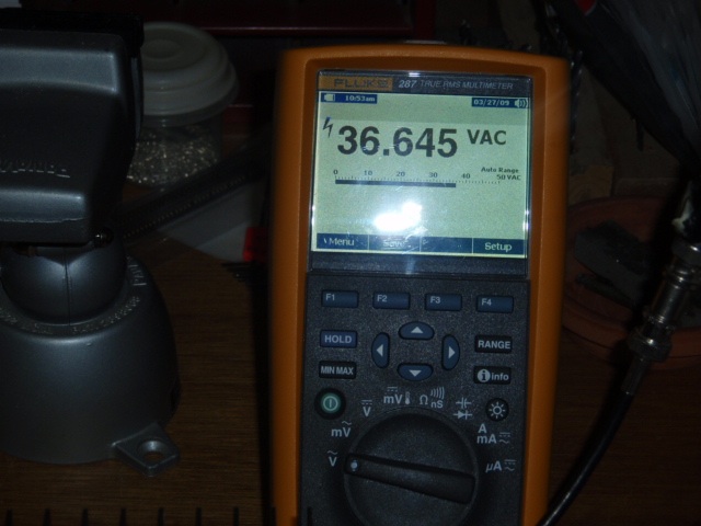

I've made a little more progress on my Krill. Now using 4 pairs of 2SA1943/2SC5200 for output. The scope shots are from a crude set-up with lots of clip leads. The compensation needs some further tweaking but that will wait until the board gets hard-wired into a chassis.
I did some very preliminary tests today with music streamed from KVOD-Denver through my MacBook into the Krill then a small home theater speaker. It sounded pretty good - good enough that I will build the other channel and get the amps ready to play through my regular system. (And Carlos, I have not forgotten for your request of a description of that. I'll do that when I post more listening tests.)
1 Khz sine wave into 8 ohms, 13V RMS.
