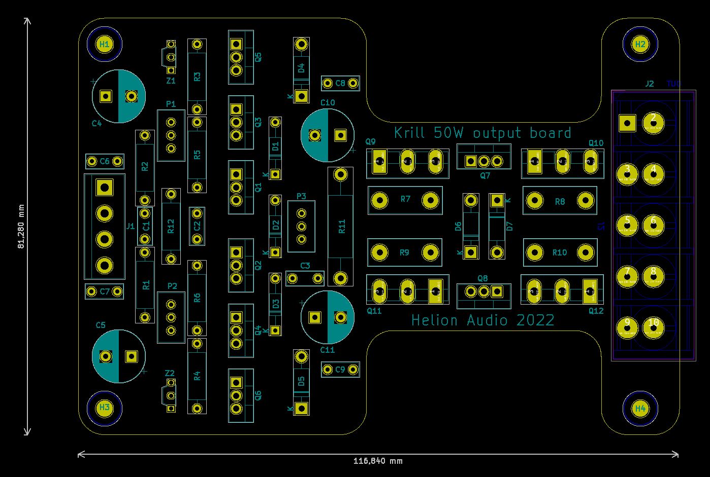

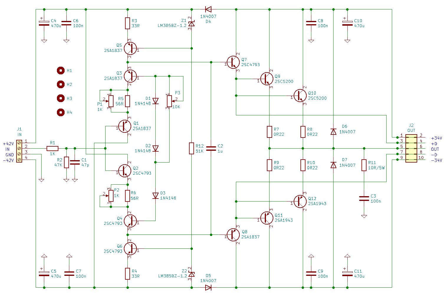

Hi! I see that this thread is probably dead now, but here is my question anyway:
Has anyone tried the Krill output stage together with a high voltage preamp like the A30 (AliExpress, Taobao) or Jensen JE-990?
I am contemplating the idea of making one to see if it is possible.
Here is my attempt:
Any suggestions are welcome!
🙂 morten
