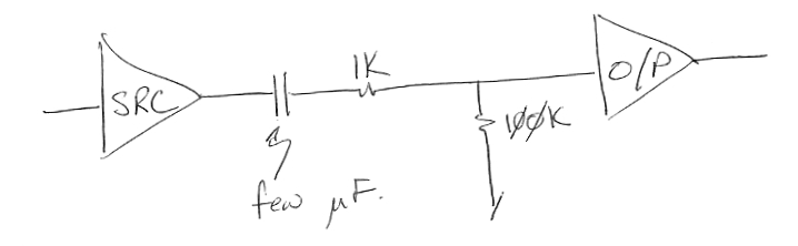

lgreen -- I've attached a sketch of what I mean. SRC is the signal source for the output stage, e.g., your signal generator. O/P is the Krill output stage. The junction of the 1k and 100K resistors is connected to the junction of Q7 and Q10, which is what I referred to as the input to the output stage.
The cap and two resistors in the sketch are not in the schematic and will go away once you complete trouble-shooting. So....
1. Cut the trace and add the 100K resistor (value not critical) from junction of Q7 and Q10 to ground.
2. Disconnect the power to the output stage but keep the AC power connected to the power supply for the VGS.
3. Go back to the VGS and check offset and oscillations without any compensation cap.
4. Correct any problems which will now be related to only the VGS or power supply.
5. Connect power back to output stage.
6. Put scope and DMM on output of the output stage. Check for offset, idle current and oscillations. You don't need the extra cap or 1K resistor for this step. You could also make same measurements with the 1K resistor as shown in the sketch but connecting the open end of the resistor to the ground. See if it makes any difference.
7. Correct any problems and adjust idle current.
8. Add the cap and connect signal generator to output stage as shown in sketch. Check response.
9. Connect VGS back to output stage but as shown in sketch where SRC is now the VGS.
10. Check everything again.
11. Remove 1k and 100K resistors and the new cap and connect VGS to output as shown in Steve's post 251 schematic.

I don't know what you mean by the VGS- it is "voltage gain stage" but where is it? Q1 and Q2? where am I probing? The the base of Q2? R11?
let me see if I understand.
You are saying-
1. Cut the trace to Q7/Q10. the long stright one from Q6. cut vgs here.
2. Check the input stage at the output of R11 which is available and will have the same voltage as at the place where I just made the cut.
3. Adjust DC offset with R26 which operates on this part of the circ. Also that weird cap I have been using will effect this part of the circ. 3 pf should do it? (that is my only small value!).
4. Now check the output stage (connect power to it), you cut its input but not a big deal, you can run open circ, or with 1K to ground, so do both
5. Adjust bias on the output using R27. Look at the response. Watch out for oscillations.
6. Hook up the signal gen to the output stage, use a 1K and dc blocking cap in series with the sig generator directly into the cut made previously. Analyze response.
7. Hook up the input to the output, but not directly. Putting a DC blocking cap and a 1K into the cut trace in series, and a 100K to ground.
8. remove everything (the cap, 1K and 100K), reconnect the cut, and you are good to go?
Have I got this right?
So what you are saying is to cut the trace. To adjust the input part alone. To adjust the output part alone. To join the in to the out by using a dc blocking cap and resistors, and adjust that. And finally to remove everything and go back to where we started without the cut trace?

That sounds right. The output will need a resistor to ground when separated from the VGS (voltage gain stage) to prevent major DC offset. The 1K to ground should take care of this.
The purpose of this is to check and see witch part of the amp has a problem. The DC offset should be set after the two stages are reattached.
