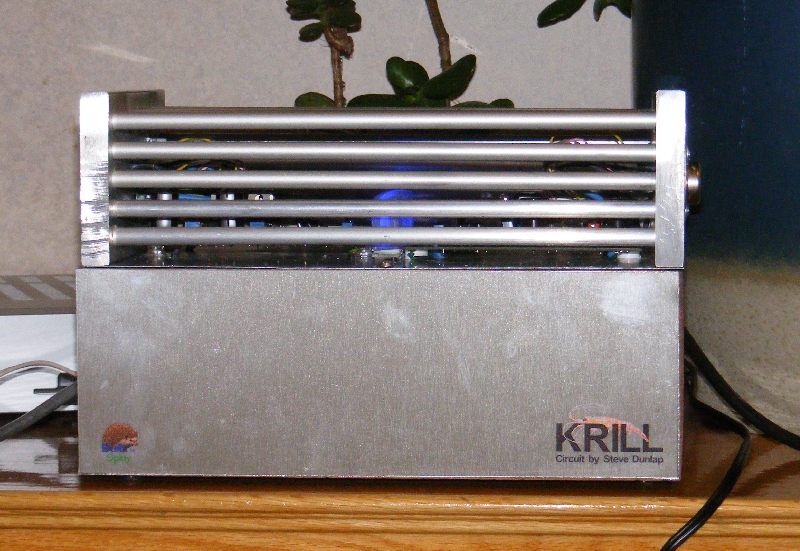

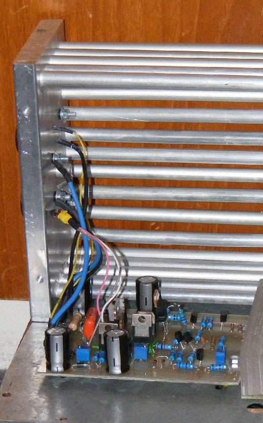

I'll drag the camera out tomorrow 🙂 the base is a wooden box with the PSU (transformer / boards) and connectors on the back.
the top is two 1/2" by 6" by 3" slabs of aluminium with 19 off 8mm ali tubes, compression fitted into holes drilled in the slabs, overall @ 10" wide. this covers the amp boards and lifts up for access / adjustment. Drilled for the T03 Darlingtons and the diode temp compensation.
Its OK as a heatsink for music power, on music no appreciable temp change after one hour at moderate (SHMBO turn it down!) levels - gets quite hot (50+C) when run during testing at full sine wave power (55watts/channel) into a 6 ohm dummy load . I doubt it would be any good on a 100 watt amp (2 by 100) instead of 2 by 50. Lot of labour but fairly cheap 😀

Here is a shot with the top open and one side showing. The ali bars are more obvious now

I've stuck a thermometer on it and run it at 40 watts a side (80 watts into 6.6 ohms)
after 15 mins the temp reaches 60 C at 30 mins 70C and stabilizes this appears to be the point the losses equal the heat input. temp measured on the 1/2" slab. At this point my dummy loads are running at 120 degrees!
Thanks Spiny. Those temps are in same ballpark as I measure. And nice enclosure.......but after seeing the projects on your website I'm not surprised.
