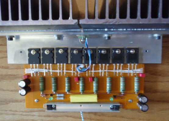

PH104 said:slowly and not so surely .......... the prototype Krill output for my amps. Q7, Q8, Q10, Q11, Q13 and Q15 are mounted on the bottom of the Al angle.
Darn it!! You have brightly colored caps - PLUS LED's!!!
Hey - looks good Phil. BTW you have email about the real mail.

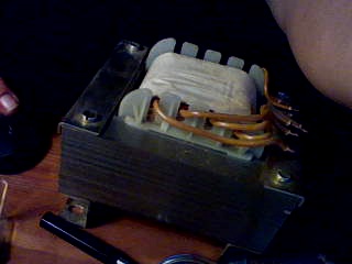

Thanks, I just got them, very cheap
Yes I will have to power them up, and measure, soon
btw, they are unobtanium now
Handmade by danish transformer specialist, but he has made the pensioner age
Have another pair recently made, and they work perfect, no noise
Anyway, I always lift them up on soft feet, and box ressonance is a no issue
Try to place a stick between your ear and box, and you will know
Even what sounds to be silent appears to be awfully buzzing
