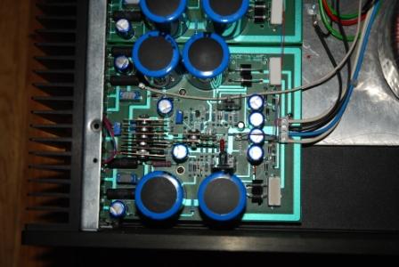

jmmartins said:A very big "thank you" to Steve,
This is an amazing amplifier.
detail:

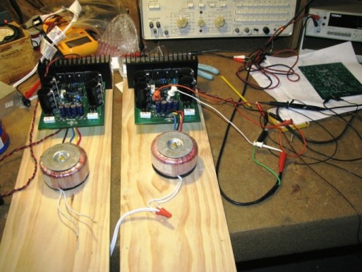

Went over to Steve's today and fired up the amps. The one's I built are 50W versions - but there are two of 'em so I figure that both of 'em together = a 100W "Krill".
These are in "test" stage and I still need to figure out what I'm gonna do for an enclosure to house them in - but give me time - it's coming!
So anyhow - no shielding and no real ground plane other than the circuit trace on the PWB's. Wires running all over the place - stuff just "clipped" together in terms of input and output signals 'cause Steve wouldn't let me solder the O'scope leads to the boards (well - I didn't actually ask him if I could do that - I just assumed he would sort of frown about such a request 🙄 ).
Here's a photo of the amps - I'll post some scope pictures in my next post.

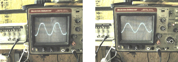

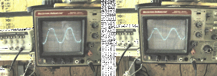

Ok - left photo is 20kHz signal being driven to soft clipping at around 23V (50W amp).
The right photo is 20kHz at just below clipping.

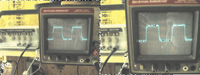

BTW - the amps ran fairly cool to the touch - even at full output. They did get hot when we ran a 100kHz square wave signal into 'em - but I'll show that in the next post.
100kHz signal - the left photo is the signal input (ugh) and the right photo is the output of the amp being driven at full output. After about 15 minutes of that little torture the amps were running hot - REAL HOT!

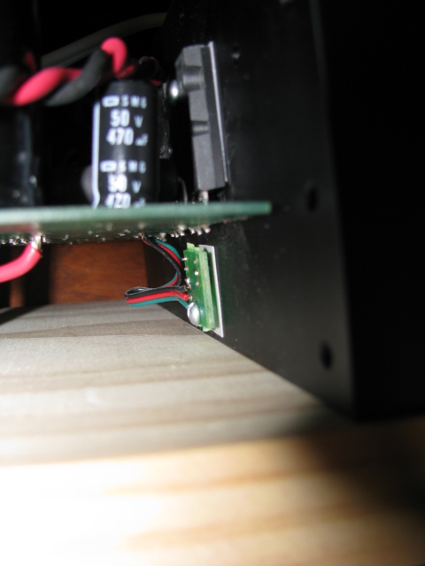

Attached is a photo of the thermal compensation PWB and diode string.
