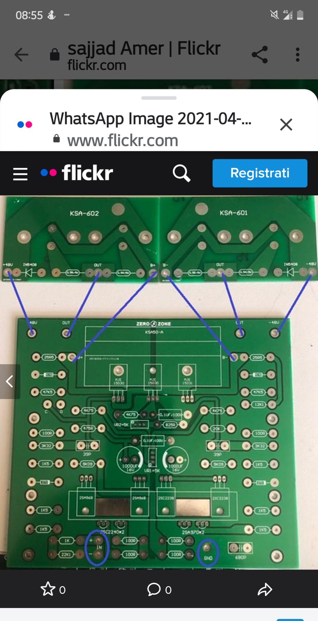

Hello everyone . Sorry if I ask questions that you have already answered but it is really a lot to read everything. I also bought the pcb from ebay clone mkII. I would ask if the values printed on the pcb are ok to realize? thanks
Ask the seller on eBay that you bought the PCB from to send you the schematic from which the seller created the PCB layout from. We can't help you with that as there are various KSA50 variations, and we do not know which one the seller used.

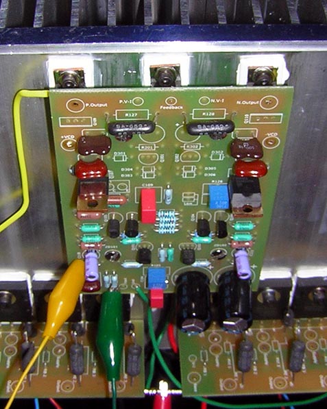

I've built a "forced air" KSA50 from a couple of ebay boards (they are excellent tbh) and I fancied building silent KSA50.
I assume the KSA-100 boards to just double up the drivers boards?
I am actually thinking about a water cooled KSA-50. All the 50's I built (8) were forced air. There was one driver board before Pinkmouse did his and it worked ok, but had a couple of errors that had to be jumped before hand. It was also a PIA to mount the drivers... but it worked out well once I soldered them to the back of the board. That amp is still in use by a friend today.

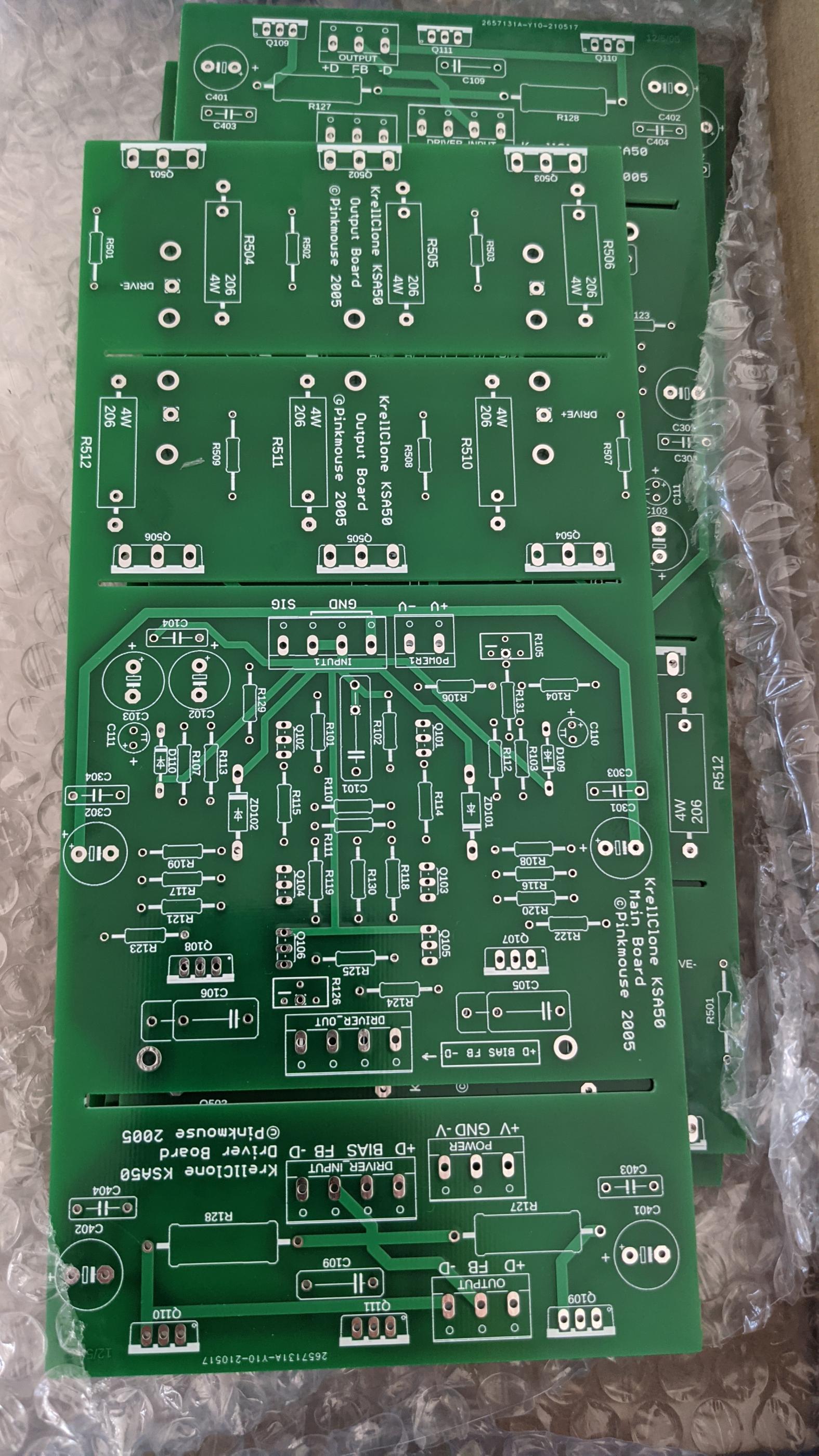

Ah, no. These are the pinkmouse boards, which is passively cooled, flatpack output device KSA50s. The Gerber files were posted just recently in this thread.Ahh! I'm guessing it was these.
The ones I bought from eBay are High Power Pure Class A amplifier PCB KSA50 mkii ! | eBay
