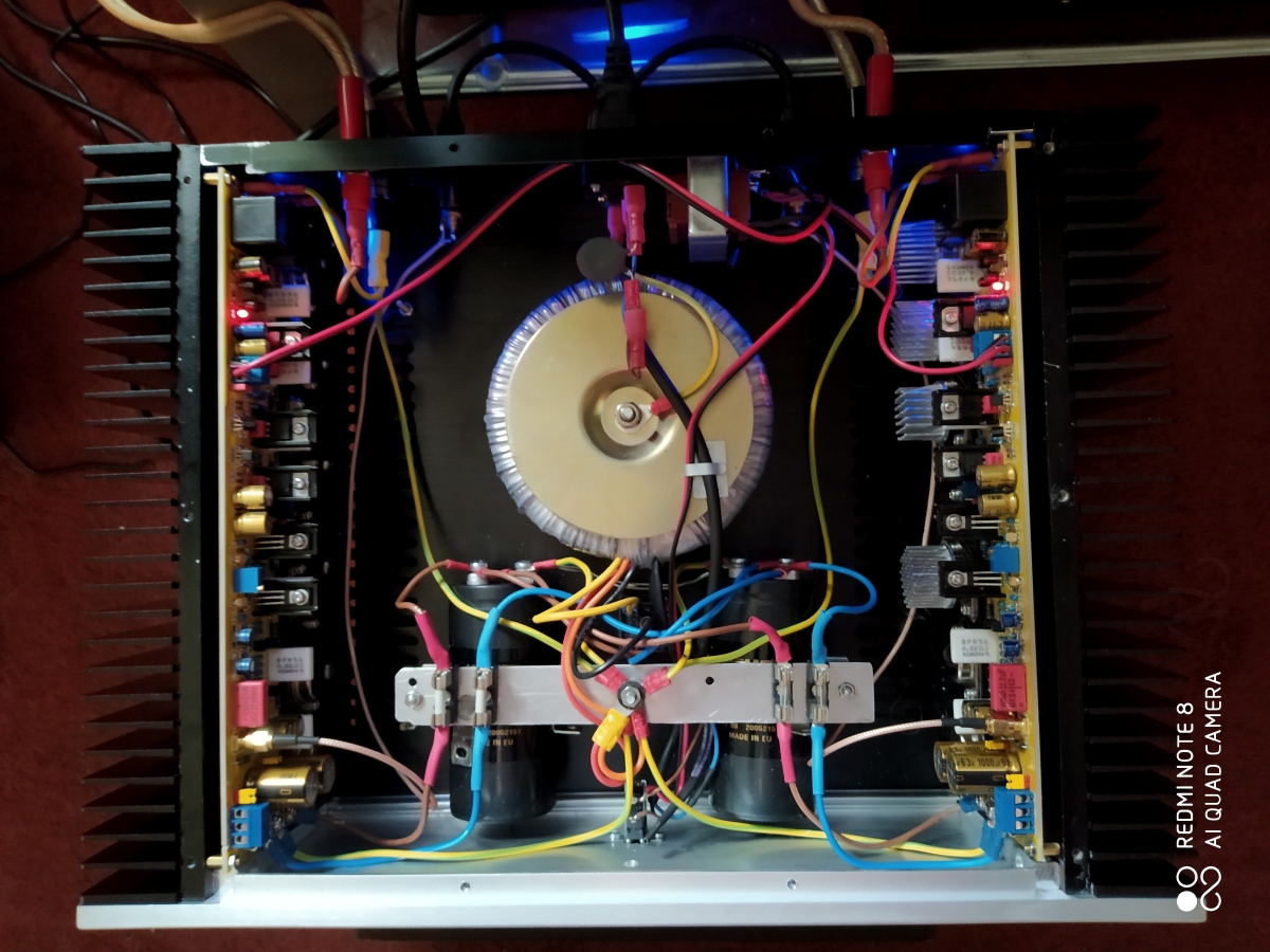

Mini Krell KSA50 (25w)
I have at last completed my mini Krell build using the pre assembled modules from ebay and a chassis from the same supplier.
Power suppy is 24v x2 250va, giving +-36.6v on load, with 47000uf reservoir caps.
The heatsinks are running at 50C and the TO3 cans at 70c and 63C for those with a finned heatsink attached. (more on order).
The SQ is a big improvement over the Pioneer AV amp I have been using but I will reserve judgment until they have been burned in for a few days.
I adjusted the standing current preset for 0.7a through each of the 3 pairs of output transistors and the output offset was set to 0v.

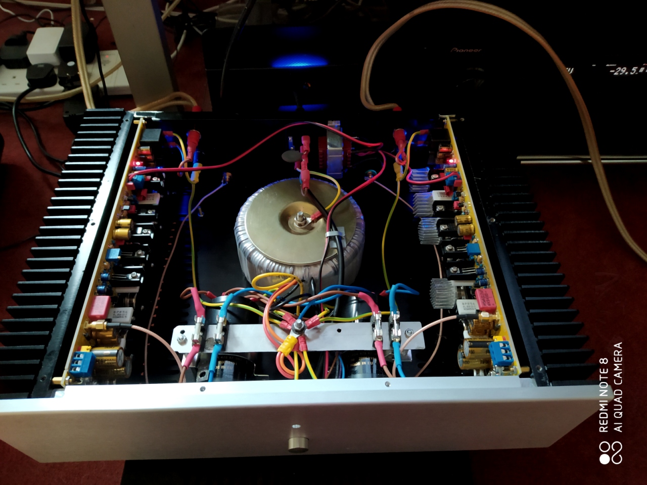

A bit more work to squeezing the KSA50 into an old Apple G5 case...
IMG_20201025_211526 by Garf Arf, on Flickr
IMG_20201101_111734 by Garf Arf, on Flickr
IMG_20201108_093812 by Garf Arf, on Flickr
IMG_20201108_093817 by Garf Arf, on Flickr
...a bugger to get in, but the case cost me £25 so I'm not complaining...
That all fits in quite well.

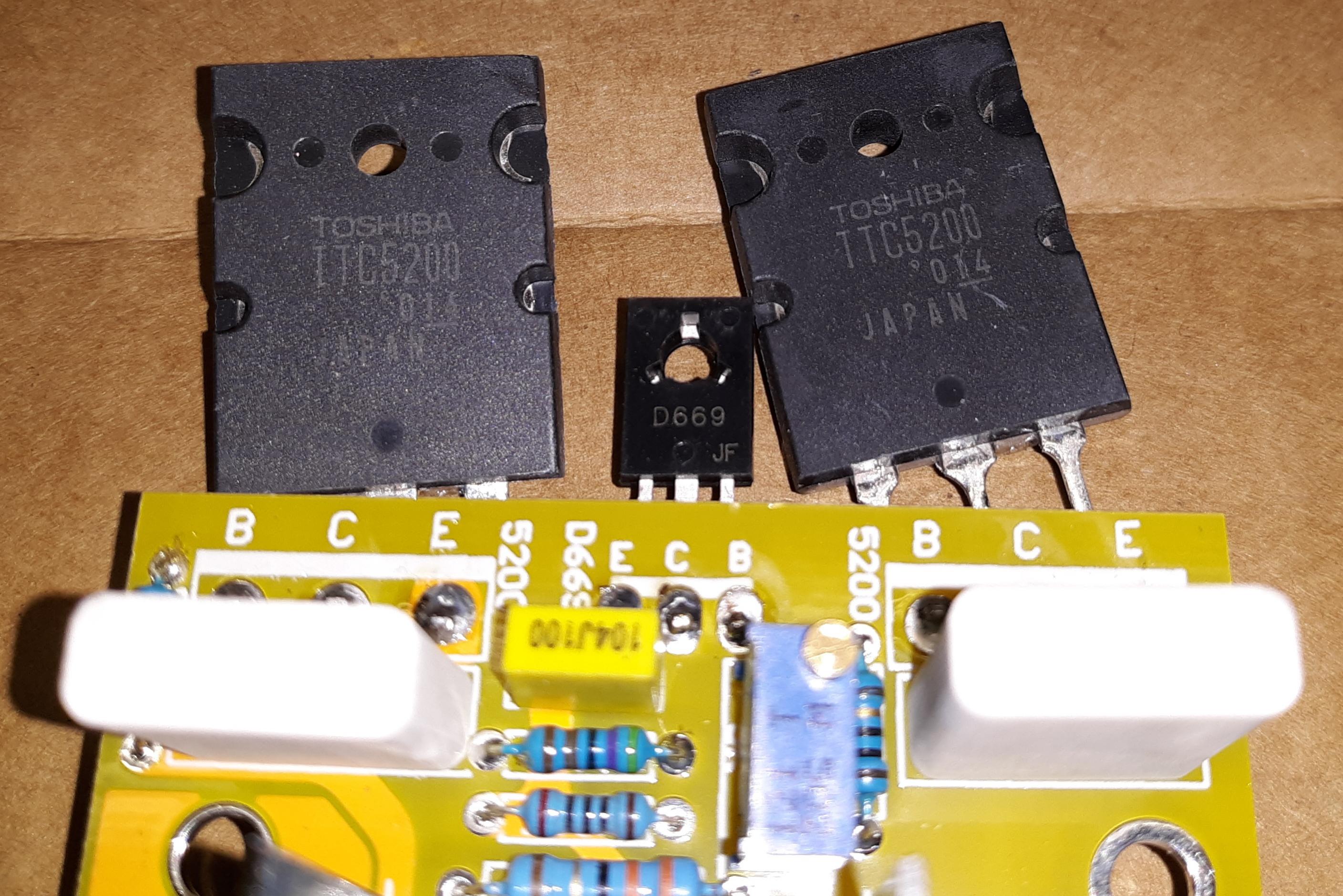

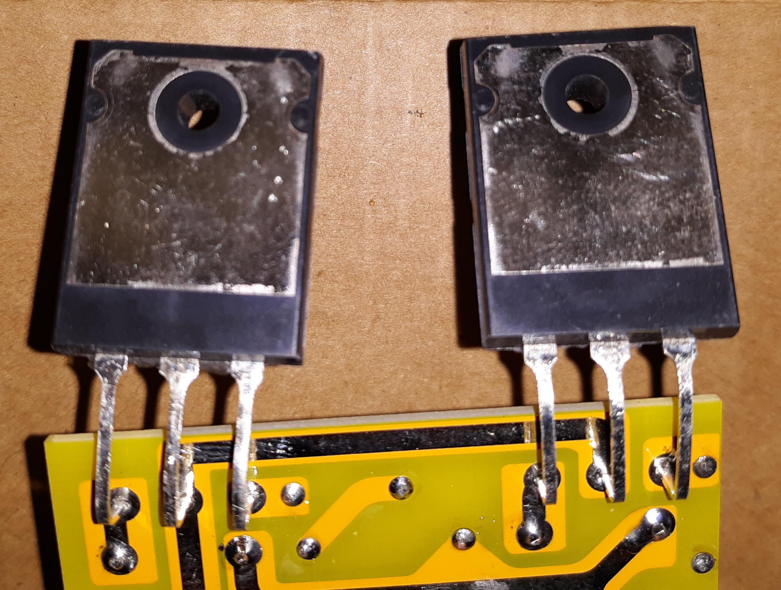

Has anyone else tried the pictured KSA50 board? Before first turn-on any advice? (I will be starting with low rails and large heatsinks. No speaker/load until I check bias, etc.)
Do the included (photographed) TTC5200 and TTA1943 look genuine? I ask since I have run into so many fake power transistors. Maybe I should just check basic function and assembly at minimum operating voltages and then replace the output transistors before going higher?
What is a good minimum operating voltage to test out such a KSA50 as safely as possible for first turn-on?
I missed this post completely. Very smart build indeed. How's the sound quality coming along?
I have been pleasantly surprised by the SQ.
Especially by the treble which is much clearer yet strangely, not being more prominent.
Also depth and separation is good and bass tight and controlled.
It shrugs off the tricky load of my ML Aeons.
Overall very smooth and unfatiguing to listen to with no glare or grainy coarseness.
My only gripes are:
Had the heatsink bracket been the same length as the pcb, I wouldn't have had to trim them down with a band saw.
The finned heatsinks were very slightly bowed so the 5mm bolts attaching it to the amp brackets had to be very tight to close the gap (until the heatsink paste was squeezed out).
So far so good.
I can't comment on that version but with the ones I used, the 10turn preset was adjusted to reduce the standing current to zero so I applied +-36v whilst monitoring the output. The offset was minimal - a few mv so I didn't have to adjust it's preset.
I then increased the current to about .7amp per transistor (2amp total)
Fans would be needed to go higher.

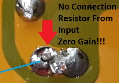

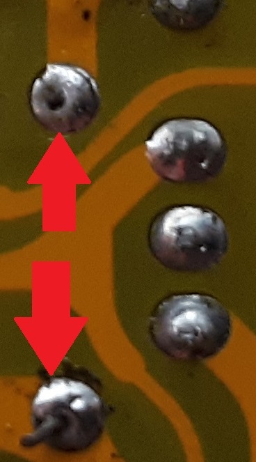

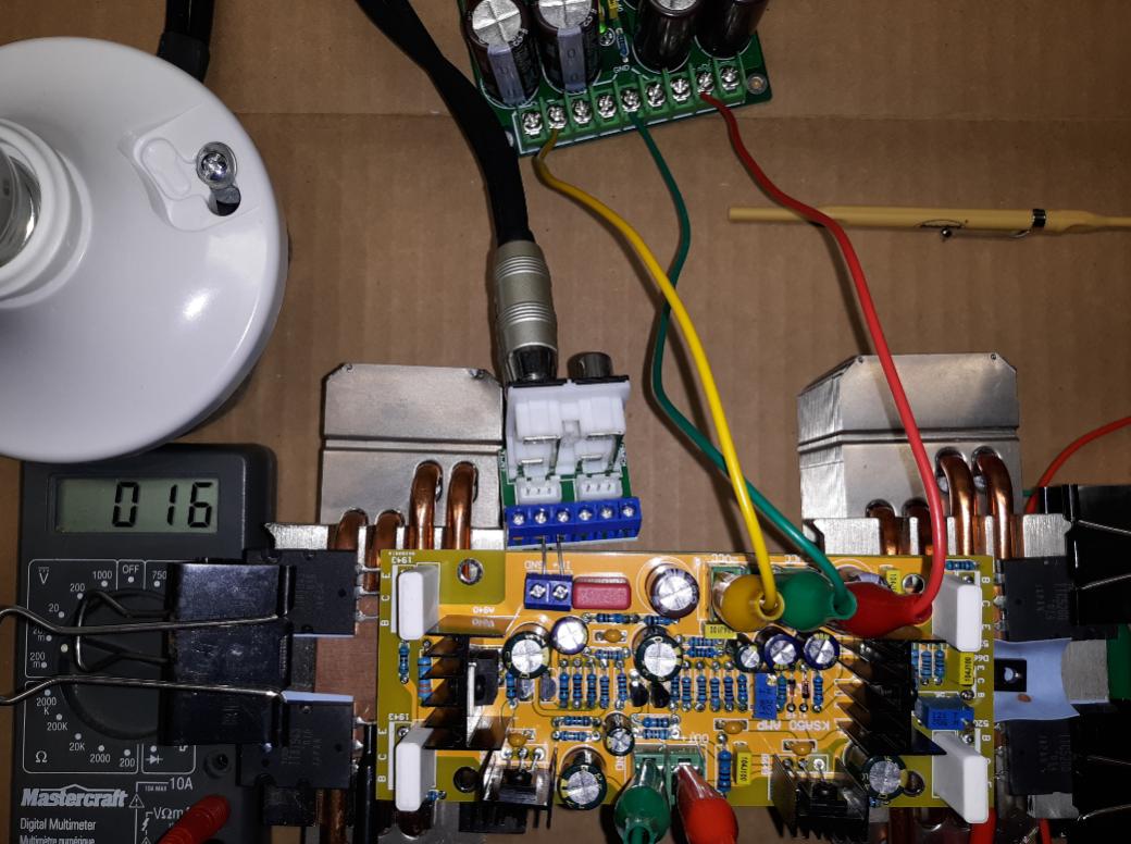

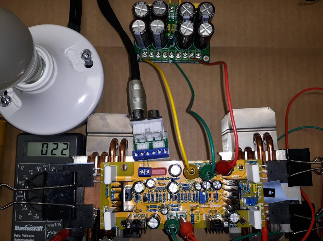

I tried my KSA50 boards with +/-25V (my lowest voltage transformer for a safer first power up) and a 60W Dim Bulb Tester.
One worked the first time while the other had no output. It took a long time but I found an open in the input section due to a bad solder joint on one side of the first resistor at the input. After resoldering both boards work. So if anyone else gets this version from AliExpress be careful and inspect the soldering with a magnifier and a bright light.
