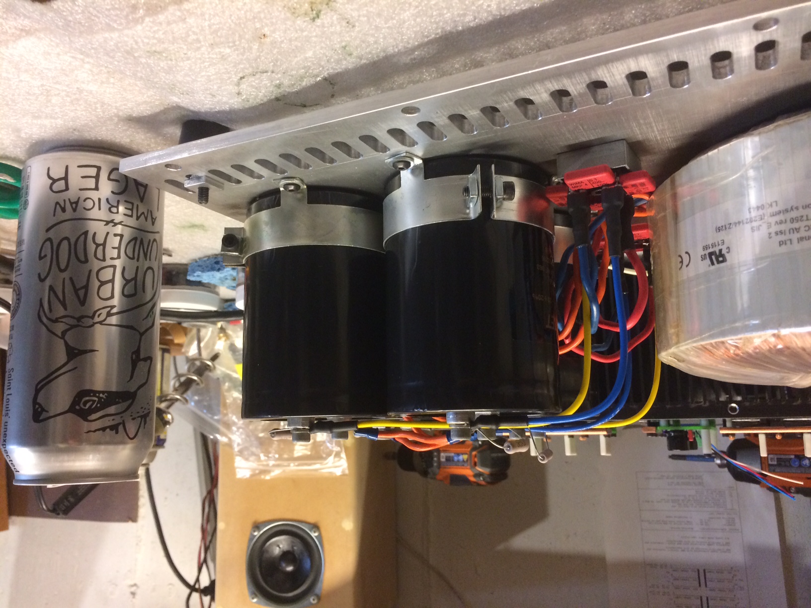

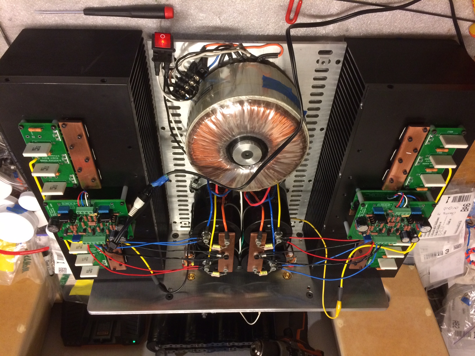

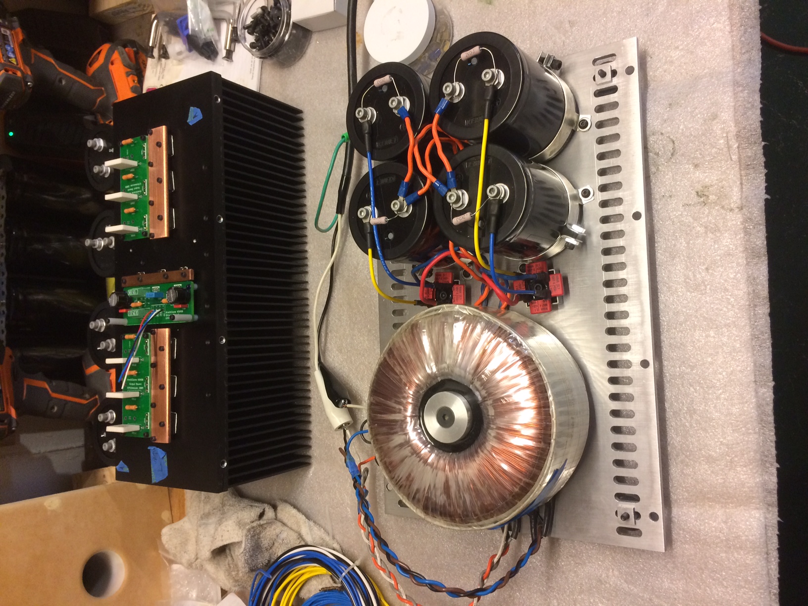

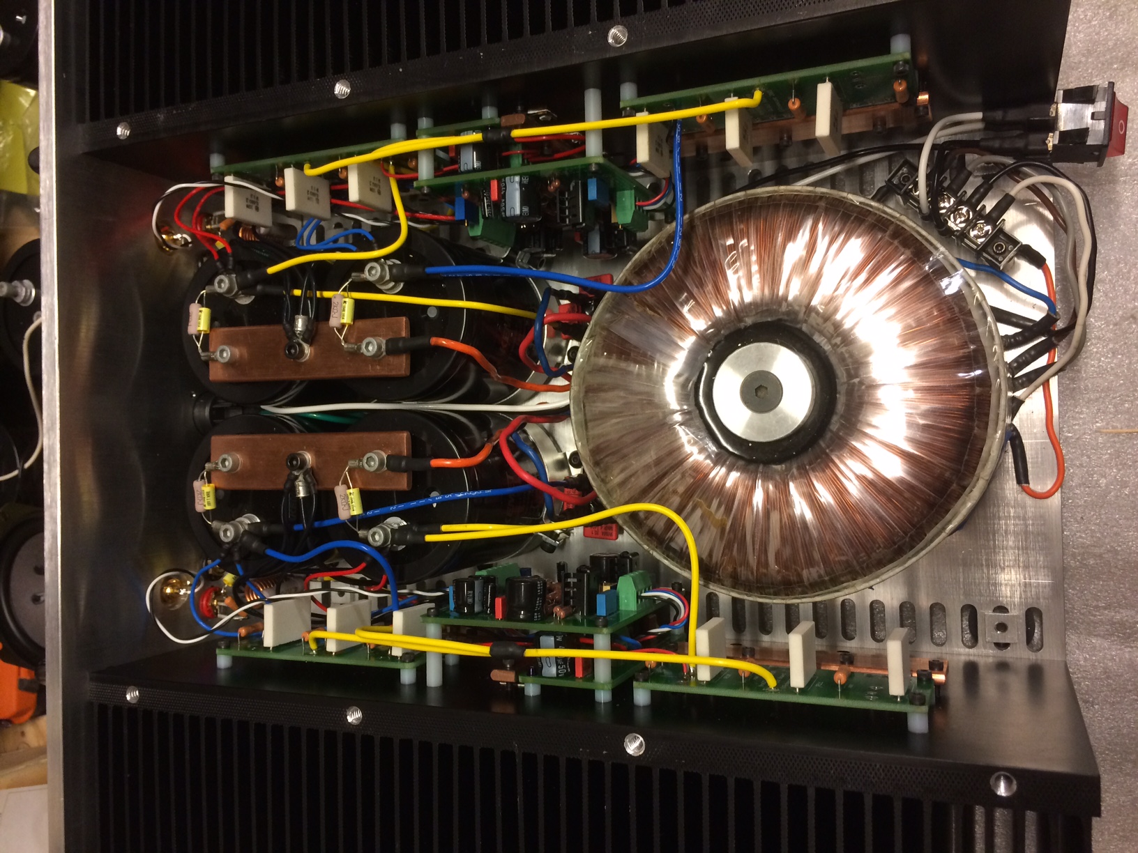

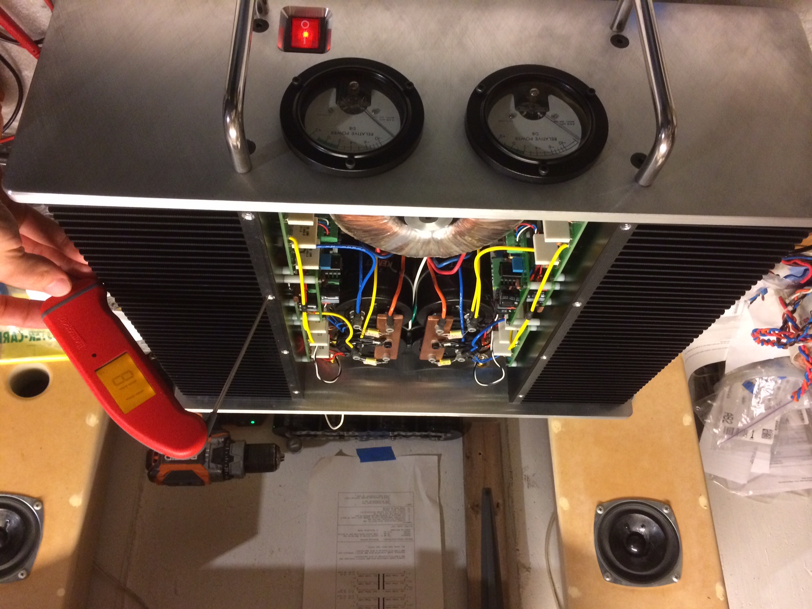

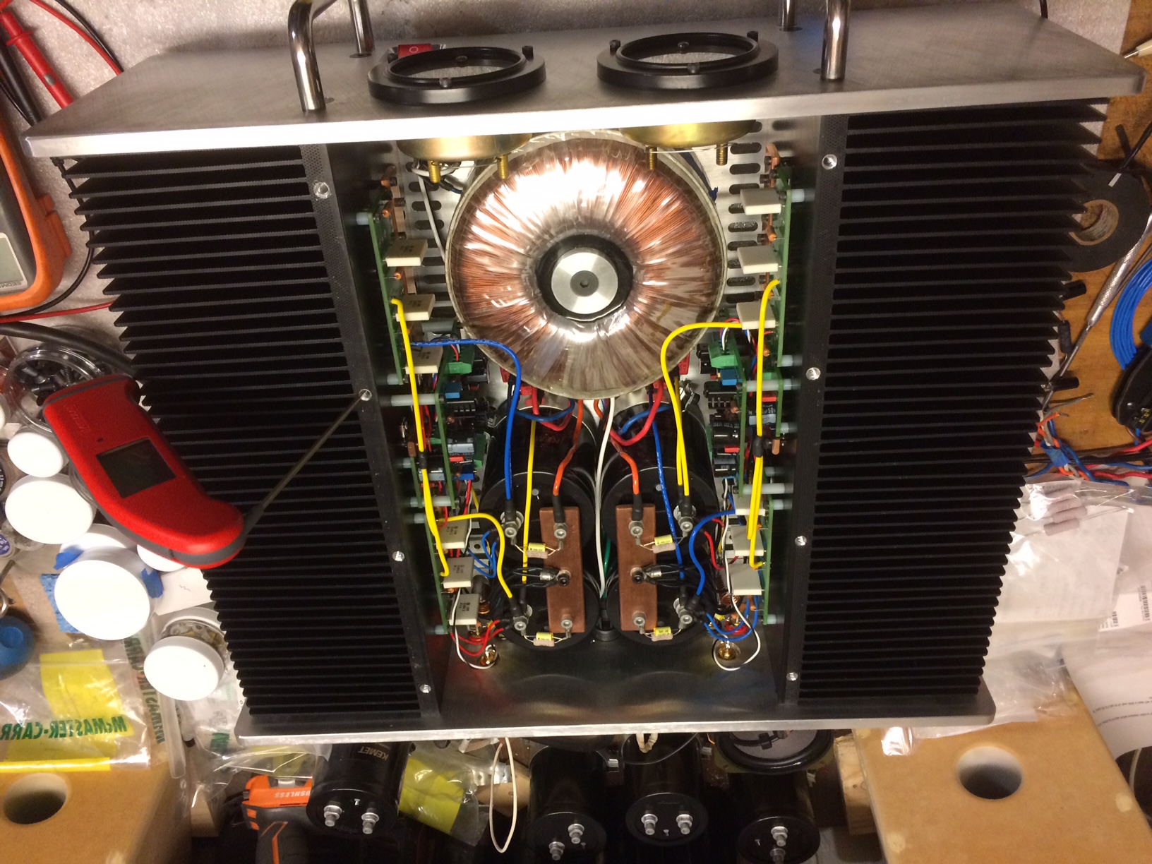

Lonnnggg overdue post here.
After about 15 years, I have found the time to go back and finish my passively cooled KSA-50 project. I just started testing it last night, slowly bringing up the bias. Running at 37.5v/rail, 3 output pairs/channel, bias currently at 620mv across .68R emitter resistors and stable at 122 degrees F/50 deg C so far, with plans to go to 750mv. The transformer is a 1.2Kw surplus item, with new Kemet 130000uF/63v capacitors being my most expensive parts. The heatsinks were a surplus item I cut in half, I believe a Mersen Fabfin product, and each measure 15.4"Lx5.5"Wx6"H. I had them hard coat anodized for electrical isolation, and mounted all semis directly with just thermal grease for best heat transfer. Chassis top and bottom are .25" plate, front and back are .375" plate. I've mounted some surplus meters for which I still have to add driving circuitry for, but I felt like the front panel needed something.
As you can see, the chassis layout is really tight, as I was trying to keep overall width at 20", means I only had 9" width inside, lol.
Thank you everyone who contributed to this thread and project, it was incredibly rewarding to finally play some music through it!
Enjoy the pictures...beer can for scale.
