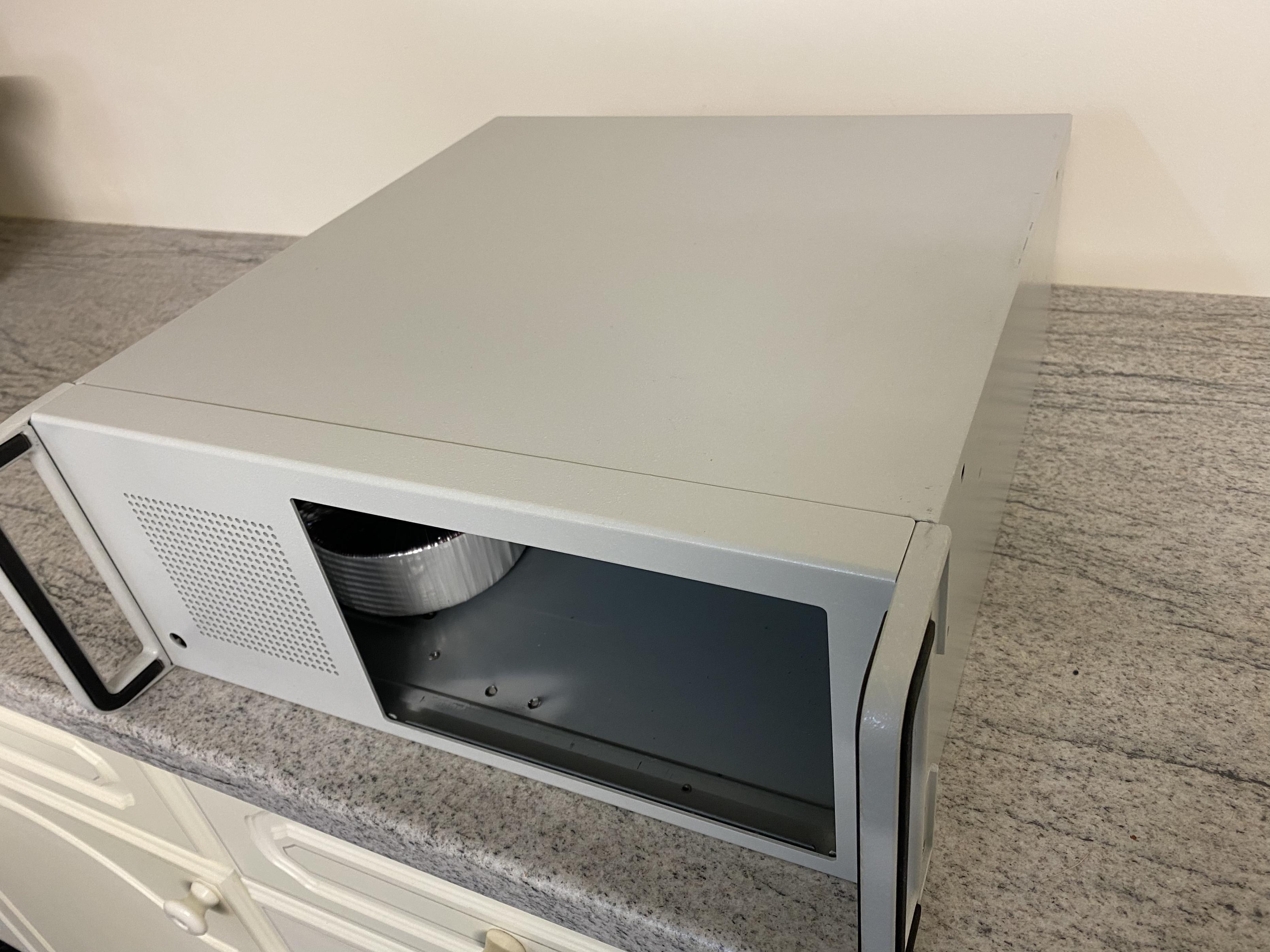

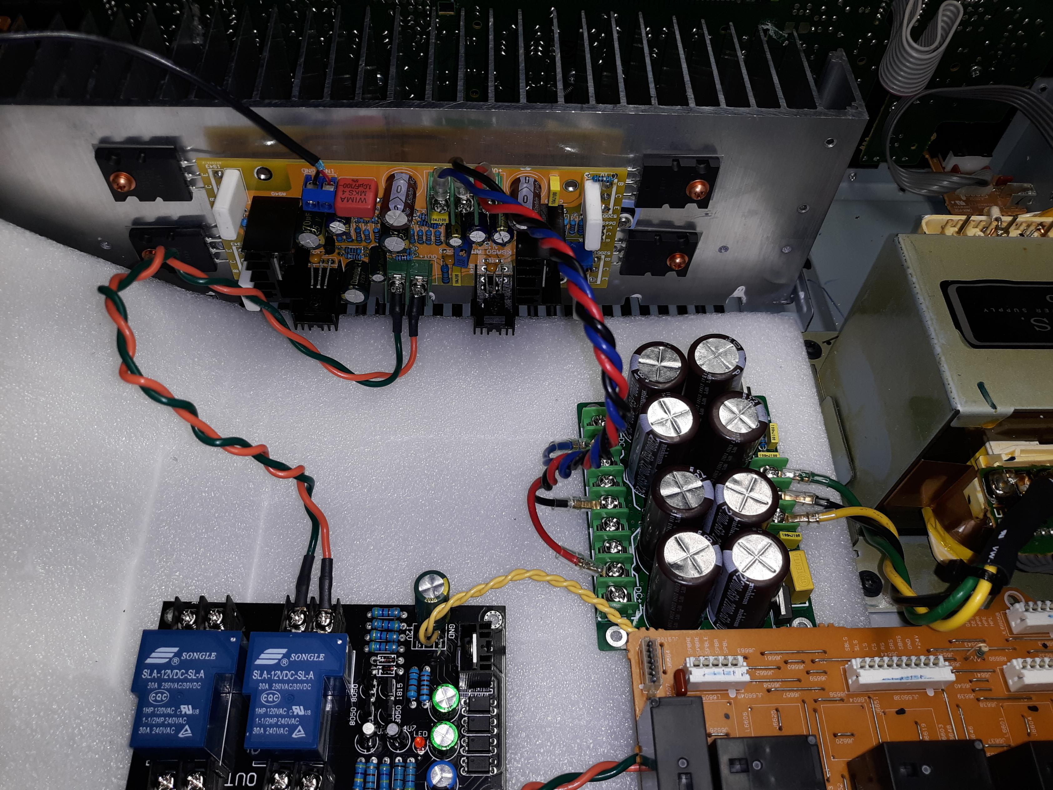

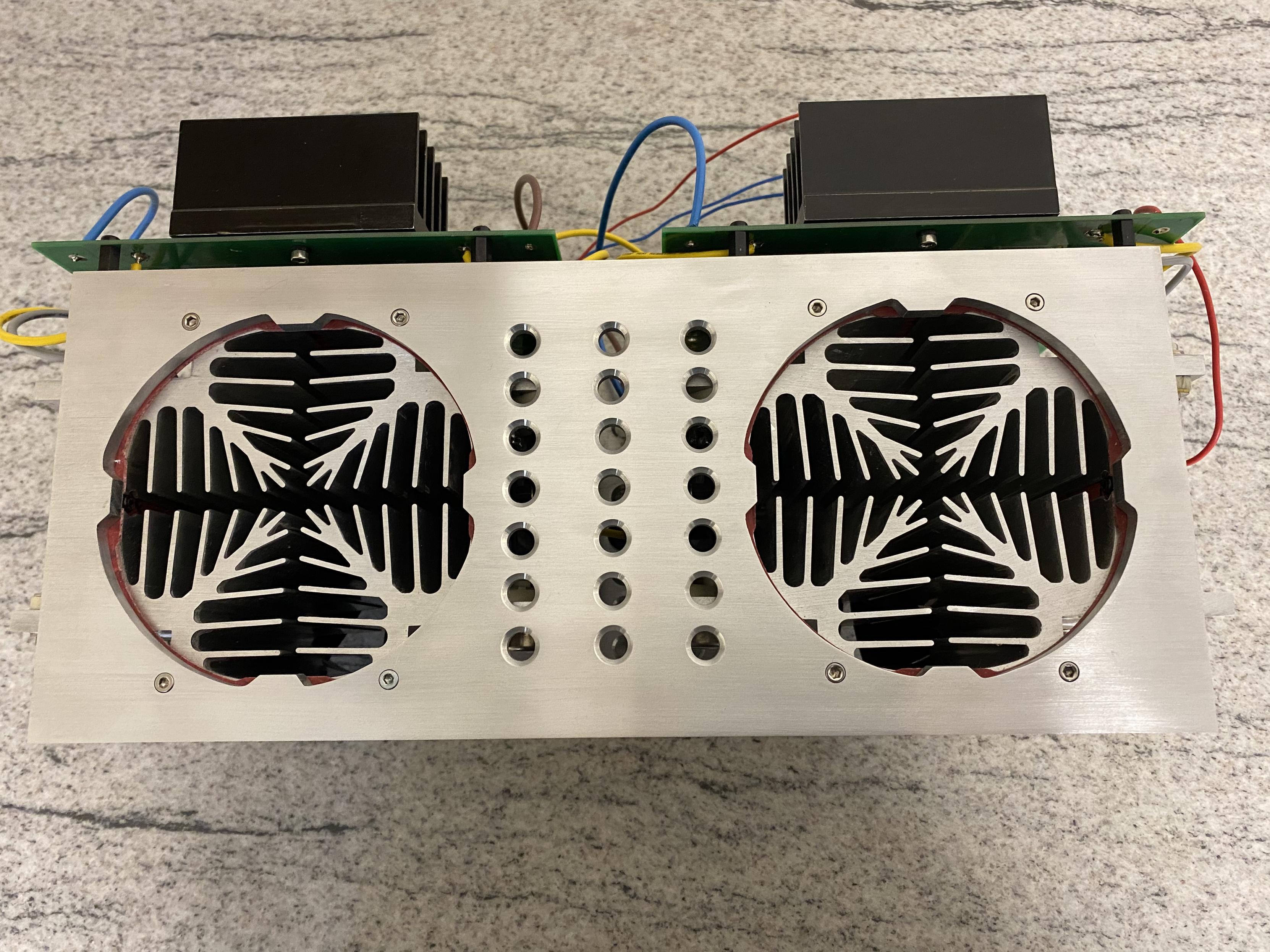

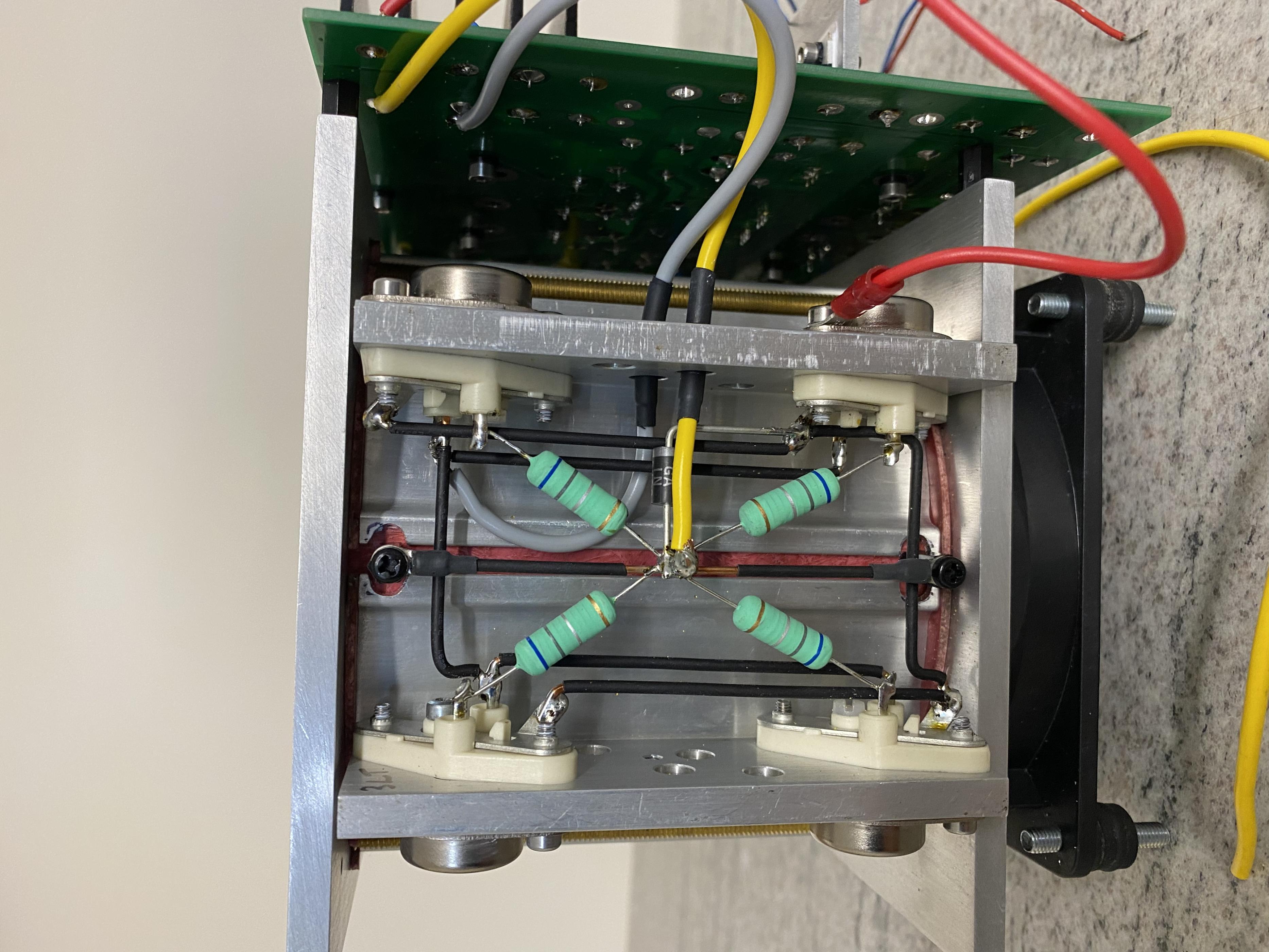

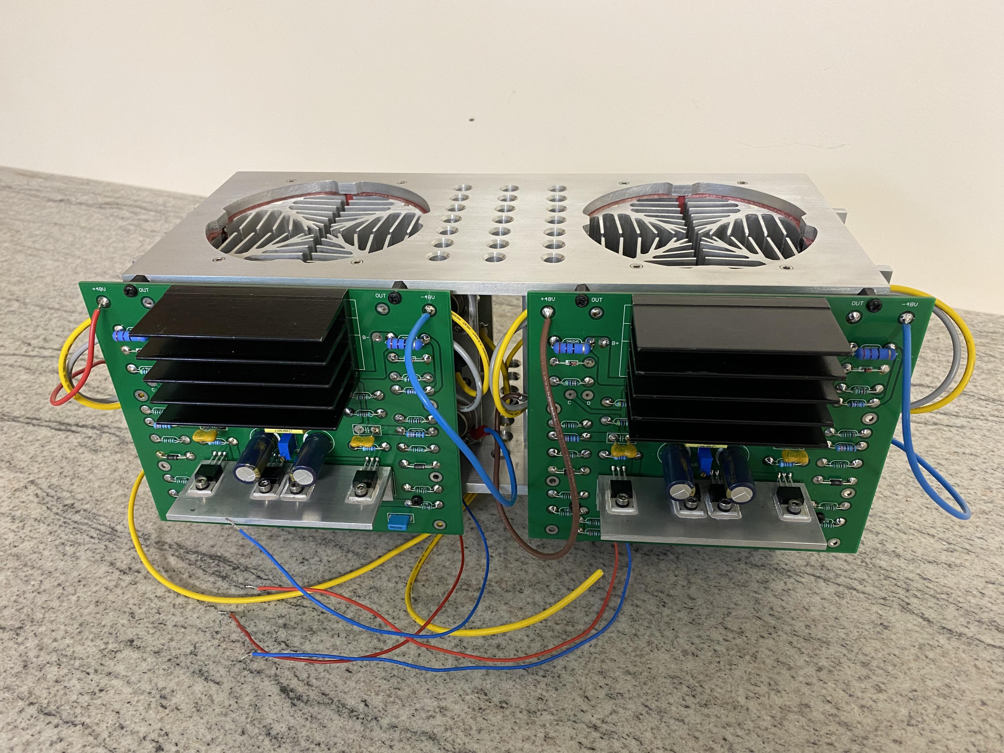

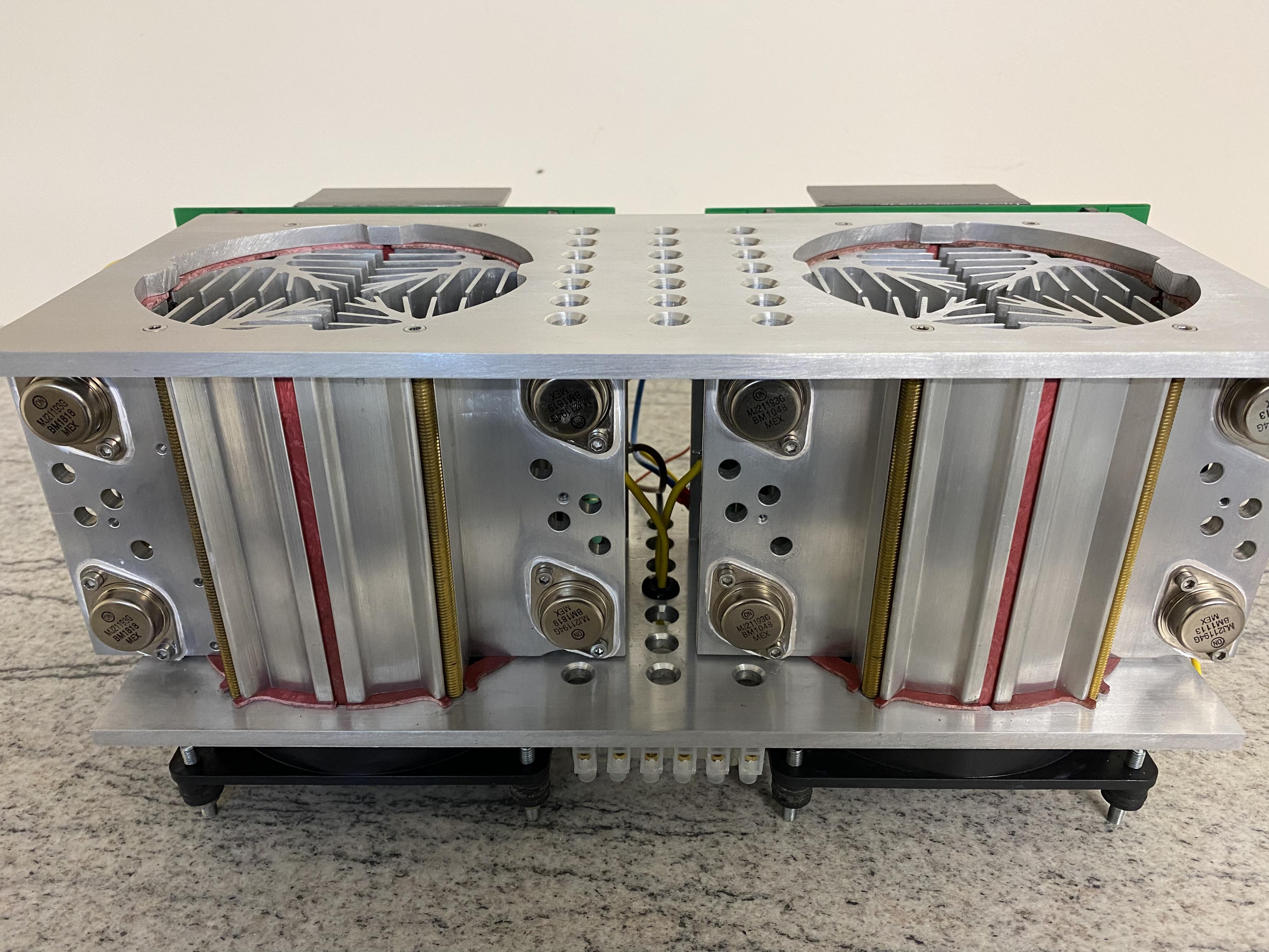

Hi everyone, here are some pictures of a project I started a couple of years ago. For various reasons I won’t be able to finish, so I have decided to sell.
As you can see, all good quality components have been used. The heatsinks are virtually identical to original Krell and I decided to use two sets as per the KSA100 even though I required only about 60W of class A. This allows the cooling fans to be run at a lower speed, so very quiet in operation.
Both channels have been tested and offset and bias set up perfectly.
Papst fans are new, as are the two 30-0-30-0 500Va transformers.
The case is from a server, in very good condition but will need finishing.
If anyone is interested in finishing this project could they pm me.

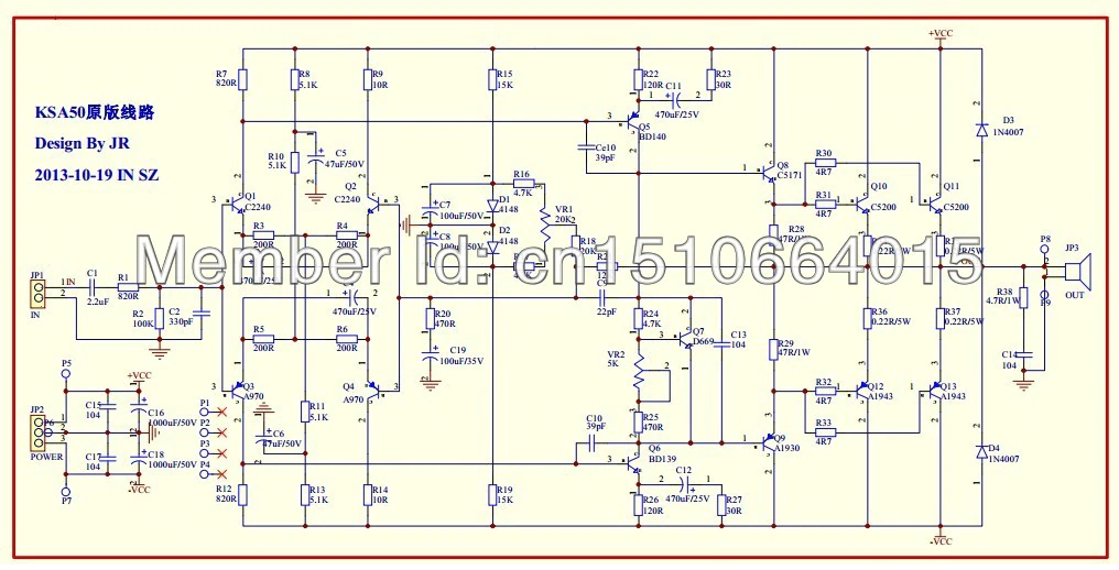

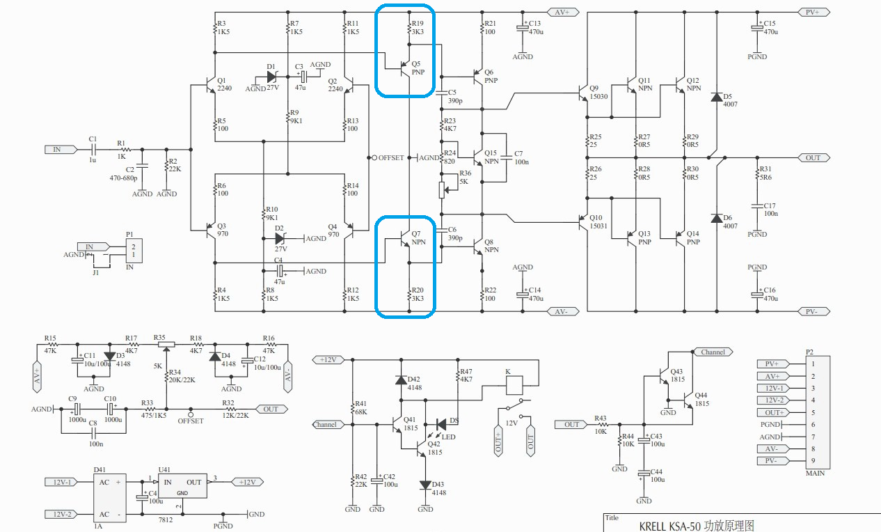

Attached is a picture of a KSA50 Monoblock that I am almost finished assembling (waiting on some mounting hardware for the boards).
I am quite enjoying listening to a pair of these. I was wondering if someone could point me to the "official" or "best" KSA50 (MkII?) schematic and orderable/reliable gerber files? I have searched and found the pink mouse boards as one example but it is not clear that those are the best ones.
I ask since the second attached image is my schematic and the third attached image is "another" KSA50 schematic that I found online which has what appears to be two additional transistors. (And various values changes plus two added Zener diodes.) Are those two additional transistors emitter followers to reduce loading? Which design is better? Which is the best/real KSA schematic? (And gerber file?)
So after lots of broken links (and the website from the first 300 posts which no longer exist) I found post #8815: Krell KSA 50 pcb
So should I conclude that the Pink Mouse boards are the best or "official" clone boards of this KSA50 clone thread? Are they considered KSA50 or KSA50 Mk II?
But I don't understand what posts #9310 and #9315 mean. Is something wrong with the gerbers or this version? Is it safe to go order the gerbers from post #9305?

Just looking at the cct in https://www.diyaudio.com/forums/solid-state/31077-krell-ksa-50-pcb-309.html#post6239875 it has the same extra transistors that you've highlighted in your blue boxes.
Ok. So I am concluding that the extra transistors are for a Mk II. That would make the boards in this thread (and my HM2S boards) Mk II variants. My existing KSA50 clone would indeed be a Mk I then.

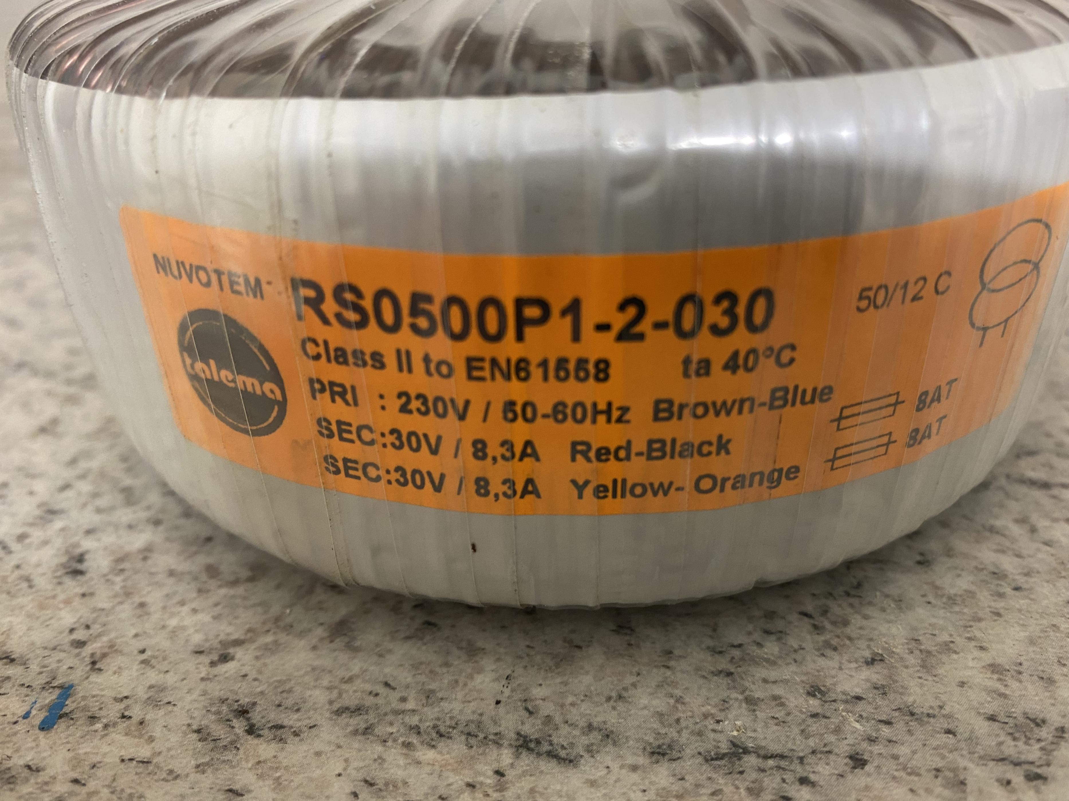

I managed to find a pair of 480V to 277V torroids rated at 300VA.
If I use a 120V input, my remedial math skills indicate I'd have a 69.25V output, which I think might be useful; and certainly leaves room for volt drop during filtering etc.
ANYWAY, if you could get said transformers quite inexpensively, would you? I mean, for less than $40 each, it seems prudent to make them work to me (but I'm not an EE, and why I'm asking the question.)

On eBay Antek sells new 300VA for $35 with free shipping:
300VA 45V 3A + 45V 3A 90VCT Power Transformer Antek AN-3245
300VA 36V 4A + 36V 4A 72VCT Power Transformer Antek AN-3236
But for Class A make sure you get a large enough transformer and do calculations for the supply voltage, bias and heaksinks depending on your speaker impedance. (Are they 8 Ohms or 4 Ohms?)
Main speakers are rated at 8 ohms but drop to around 6 at some frequencies (Thiel CS 2.2)
I’m not sure I’ll even use those with this amp but most likely the most critical listening will be with those.
I probably need more current. I’ll check the ones you suggested, but continue the search for meatier ones. The ones I found are not suitable I think.
