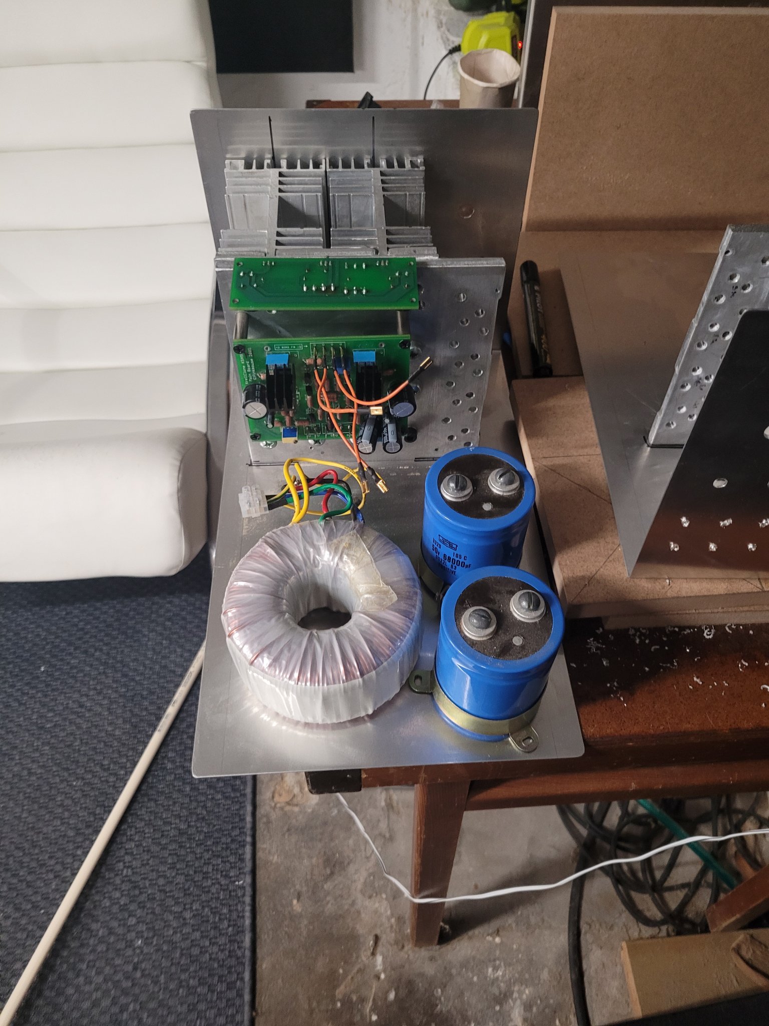

Yesterday an old friend gave me his pinkmouse "kit" to assemble. Chassis, PCB's, Toroid, and components.

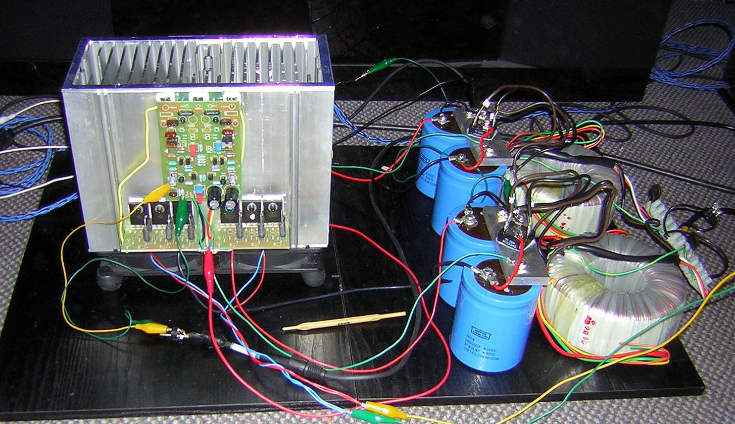

I just found the gerbers for both KSA50 boards. But I don't really recommend using the old one. Just the Pinkmouse board as it is much easier to mount. Not going to post it as someone else already did.
Here are is an image I found of the very first KSA50 I built using the original boards. This image IS DATED March 20, 2005. I will post more of my final build of the KSA50 as I find them.
