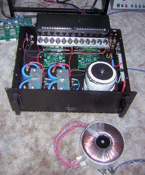

Here are is an image I found of the very first KSA50 I built using the original boards. This image IS DATED March 20, 2005. I will post more of my final build of the KSA50 as I find them.

This was my version of the KSA50 MK2 that I ran for a good 10 years at home, driving a pair of Dynaudios. The amp was driven from a Pass Aleph P line stage.
I had a bad AB systems six channel amplifier that I stripped out. Although it doesn't look like much heat sinking for a Class A power amp the heatsinks worked really well and there were two 4 inch fans running at half speed under that rear cover over the sinks. The amp actually never over heated or ran hot. It only ever ran warm when biased correctly. The two 400VA toroids were replaced by a 1200 VA dual secondary surplus toroid. This definitely gave the amplifier a bit more kick than the two smaller toroids offered.

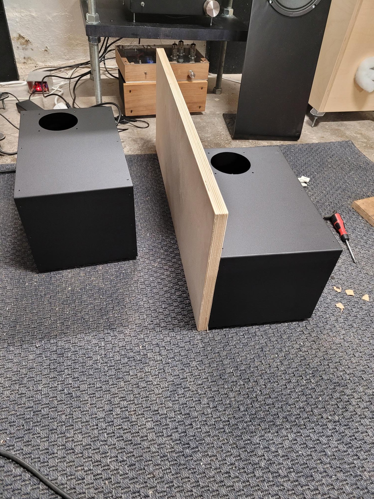

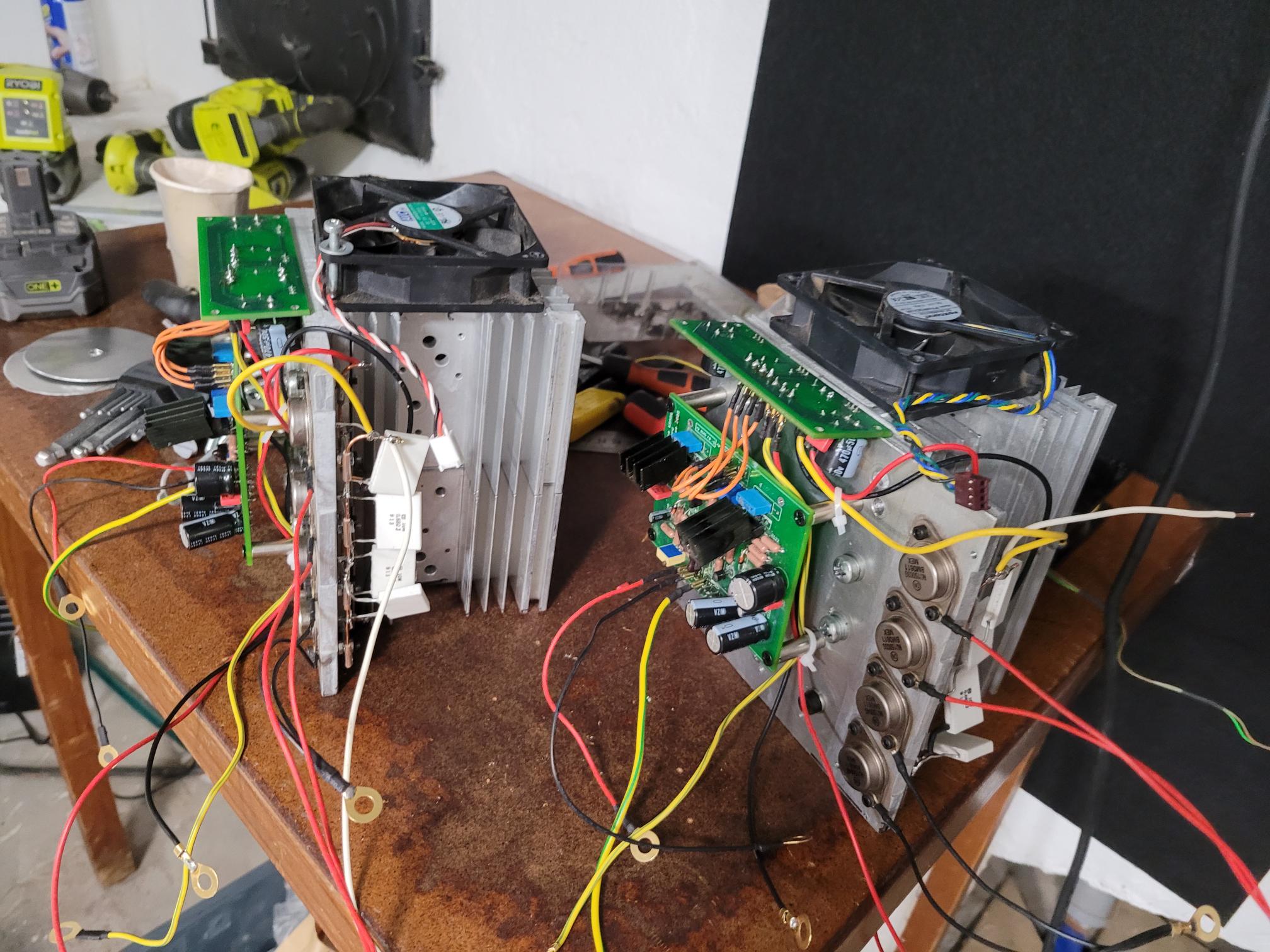

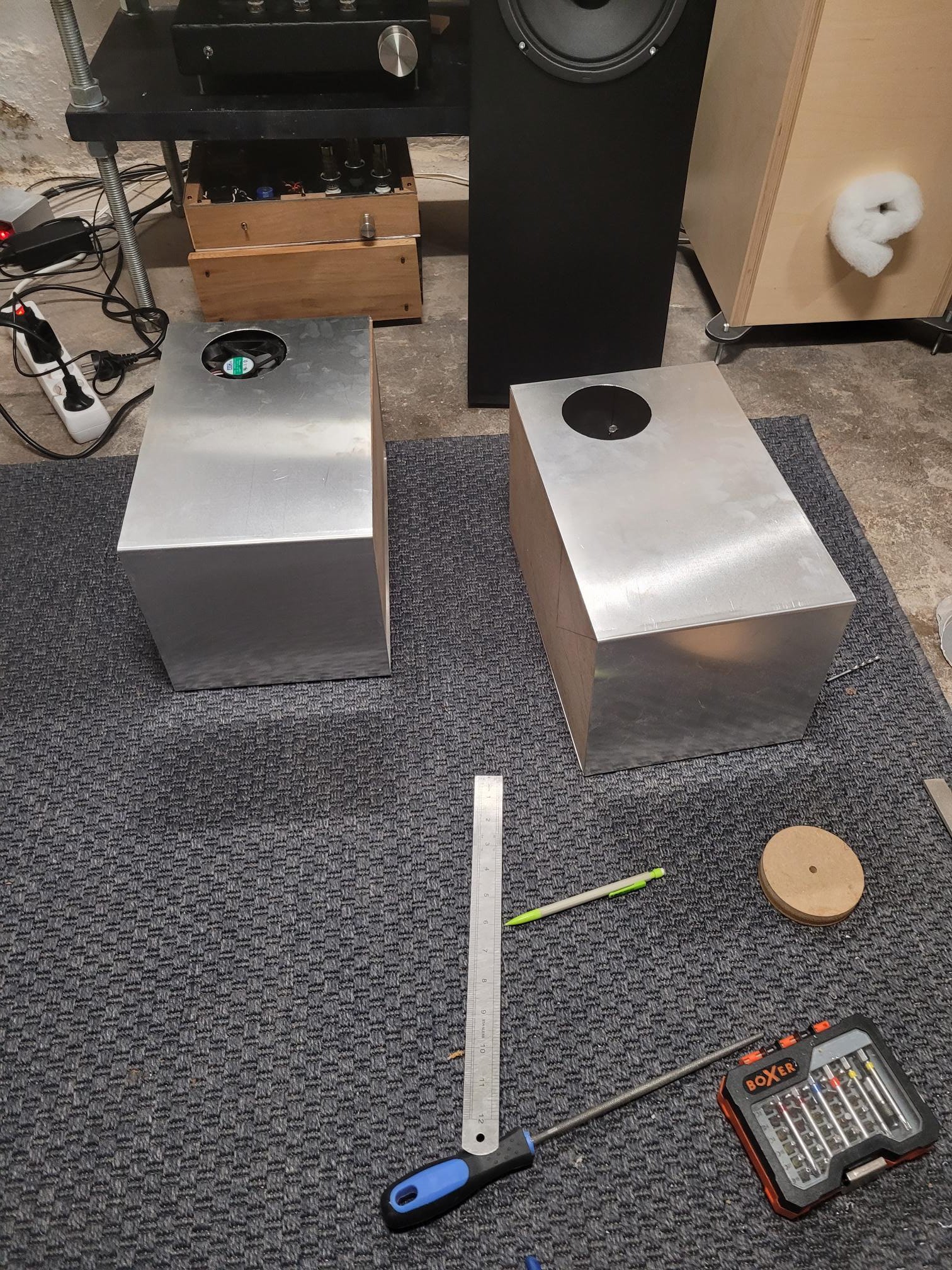

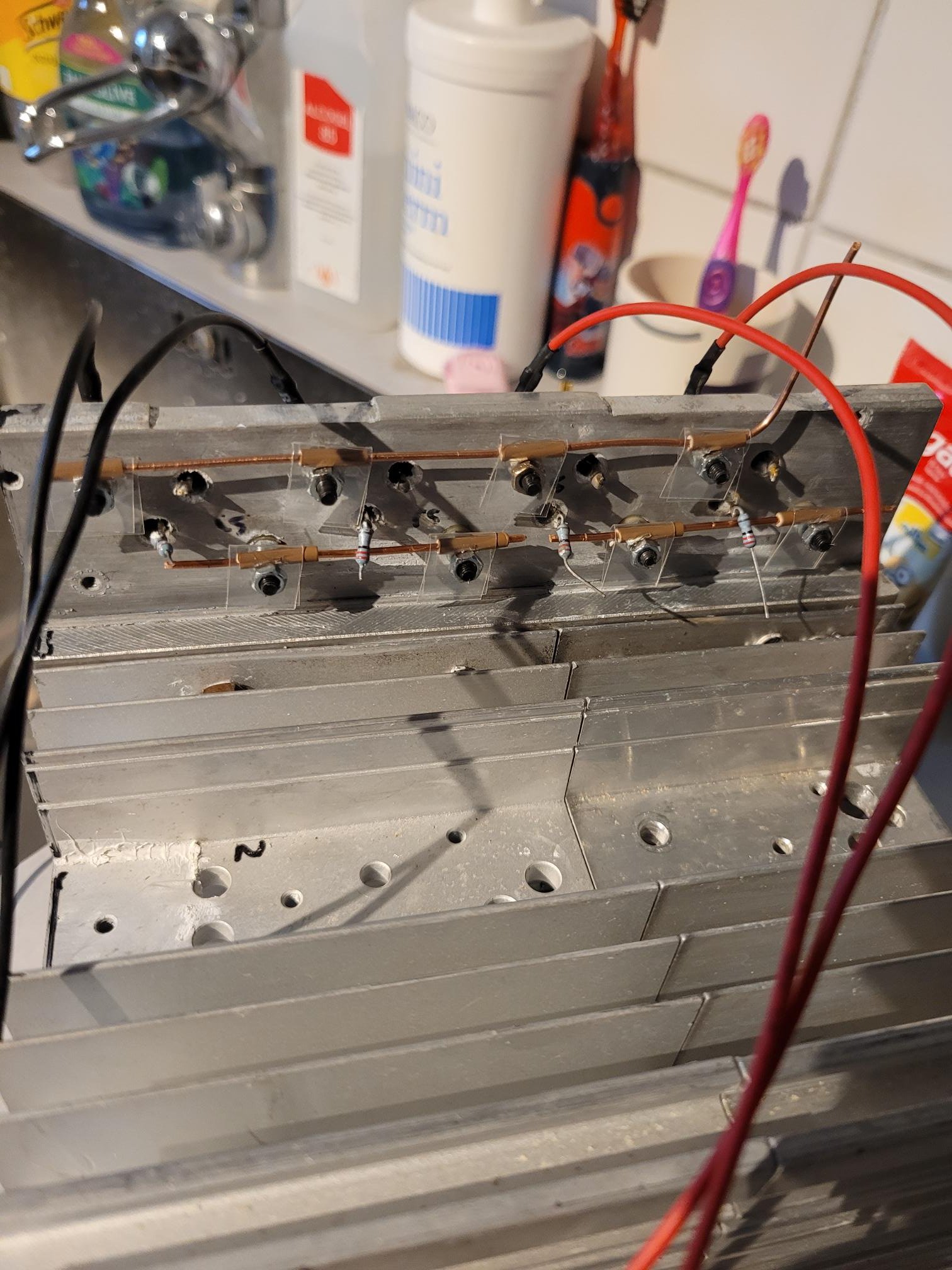

Ohoj everyone!
My friend found his old clone in the garage, forgotten and dirty. He gave it to me and I started to convert it to monoblocks. I am almost ready to fire them up and the nerves are starting to act up.
The amp was assembled using Pinkmouses boards and the parts from the group buy. It was tried running +-42VDC rails with a pair of MJ15003/MJ15004 per channel.
The only thing changed is that I replaced the massive 1kW 2x30V transformer with a pair of 200W 2x18V transformers for the mono configuration.
This will of course give me less power but that isn't a problem.
Now, I haven't changed any settings when it comes to the bias since its initial startup so I was hoping to get a few questions answered before I flip the switch.

Is it possible to first power up with a low AB bias (even though it is a KSA) using a dim bulb tester? Those are low cost and easy to build. Then test it out with a low bias? When satisfied that everything is right remove the dim bulb tester (DBT) and bias higher as per normal KSA?
I did not use Pinkmouse boards so this is just a suggestion to consider.
I really feel as though one pair of output devices is not enough. You also need to beg, borrow, or steal a variac. One flip of the power switch could destroy your work. And yes, turn the bias all the way down. Put a voltmeter on the output and see if you measure any DC as you slowly turn the variac up. If you see any voltage at all start to show up, then you have a problem to sort out.
I wrote it wrong.I really feel as though one pair of output devices is not enough. You also need to beg, borrow, or steal a variac. One flip of the power switch could destroy your work. And yes, turn the bias all the way down. Put a voltmeter on the output and see if you measure any DC as you slowly turn the variac up. If you see any voltage at all start to show up, then you have a problem to sort out.
I ment 2x MJ15003 and 2x MJ15004 per channel
Oh, that's ok then. But you should still get yourself a variac.I wrote it wrong.
