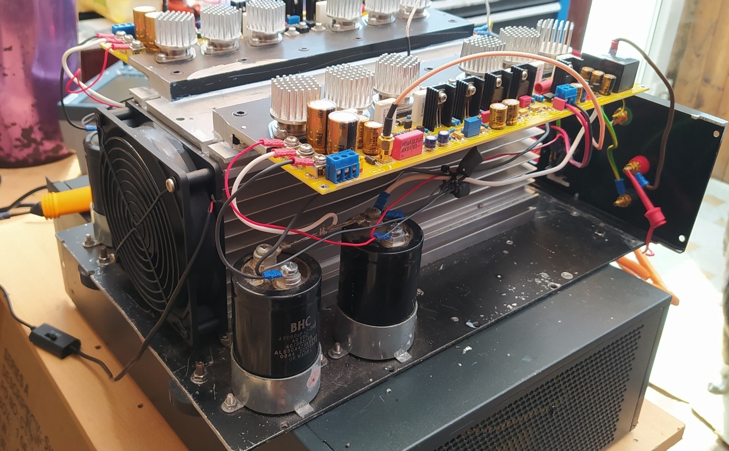

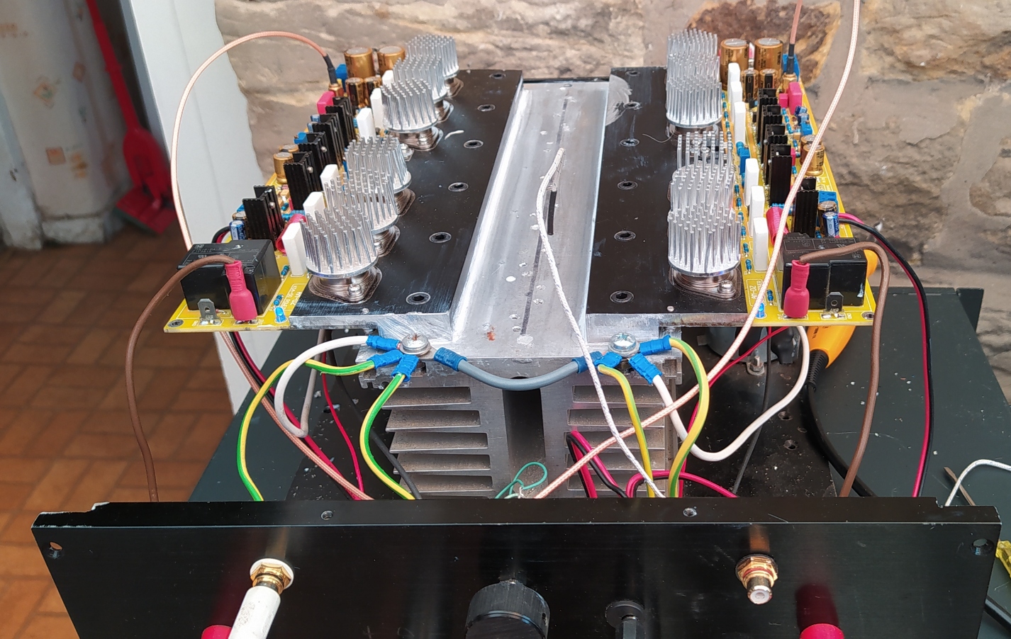

I have also resurrected my KSA50 Chinese copy monsters.
I found an old heatsink from a failed Aleph 5 and built the psu into the lower box.(25vAC)
The cooling fan is usb powered and on the lowest of the 3 speeds drops the heatsink temp by 20C.

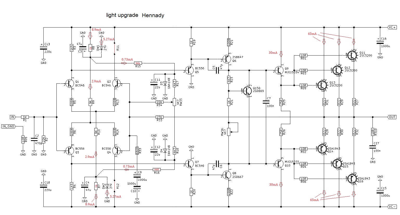

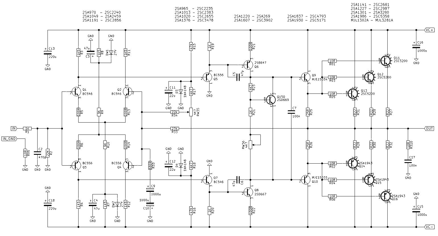

I suggest:
1. put jumpers instead of R11R12 - this balances the operation of the input differential stage when working with a difference signal, and also reduces the effect of the Miller capacitance of the input transistors on the input signal.
2. reduce the resistors R7R8 to 1 kOhm - this will increase the current through the zener diodes DW1DW2 and, accordingly, improve the stabilization of the input differential stage.
3. reduce R15R16 to 36 kOhm and reconnect them to the zener diodes DW1DW2 of the differential stage - this will reduce the penetration of power ripples to the inverting input of the amplifier
4. Disconnect the connection point of the R25R26 resistors from the amplifier output - this balances the complementary output stage in terms of current and significantly (at least twice) reduces amplifier distortion, as well as crossover distortion.
Everything can be seen from the visualization in the attachment:

I don't need maximum possible output as it's only driving a pair of GRS planar mid-tweeters in my reworked ML Aeons.
This amplifier is very good for this, Den Dagostino added Q5Q7 transistors to the Leach circuit model, due to which he eliminated the influence of C5C6 Miller correction on the input stage, thereby making it very linear before NFB coverage.

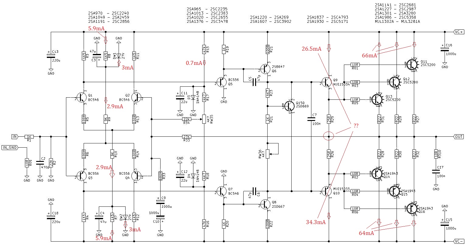

Why only 66ma through the opts? I'm running at .5amp per transistor.
I deliberately made the current smaller, tk. in this case, it can be seen that in Dena Daggostino version, the connection of the R25R26 resistors worsens the symmetry of the complementary output stage, and therefore it is necessary to increase the current through the output transistors in order to increase the linearity and reduce the effect of crossover distortion.
if R25 R26 is disconnected from the output, the driver stage starts working in class A and becomes more symmetrical and there is no need to additionally increase the current through the output transistors. Please note that as the temperature of the bipolar transistor crystal increases, its transfer coefficient decreases, and for the PNP transistor this angle of inclination differs from the NPN transistor - this leads to an increase in the even harmonic, but not to an improvement in the quality of sound reproduction.
P.S. with the RW36 you can wind up the output stage current to your liking in terms of sound from the speaker system.

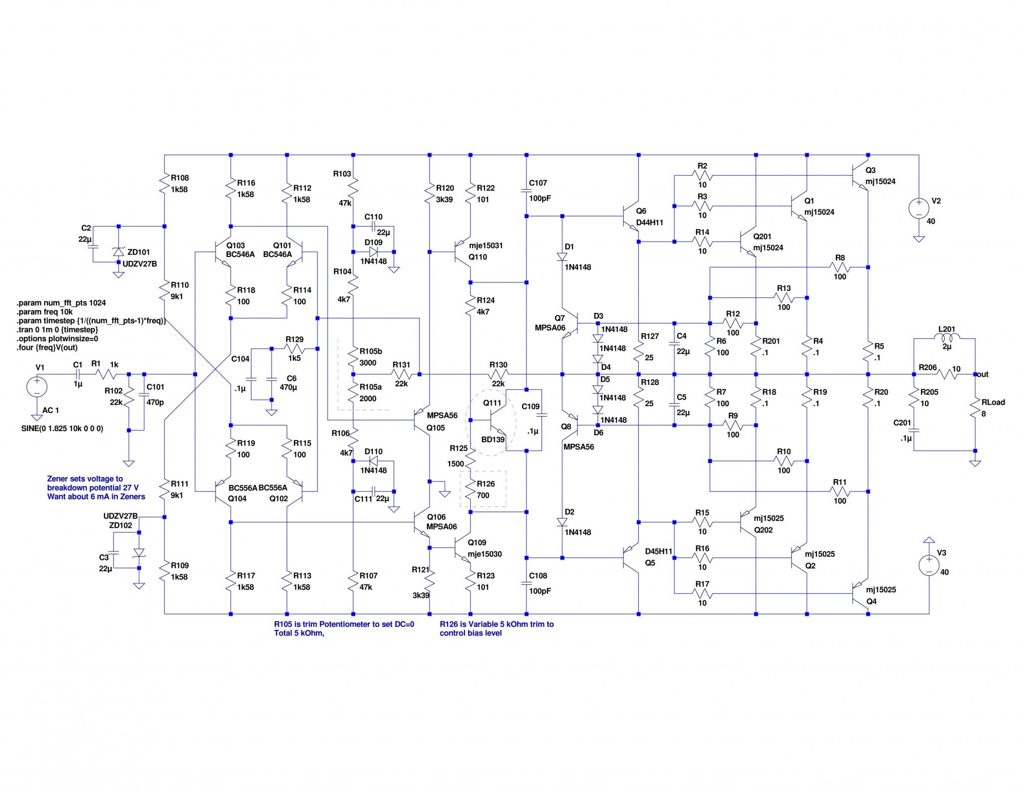

Sorry I posted the wrong schematic. The one below is closest I can find since the seller didn't supply one.
I have removed Q7 & Q8.
Why would you think an amp with three pairs of output transistors would be used in B or AB? Obviously it will run in pure class A until the current exceeds the quiescent current of 1.5a.

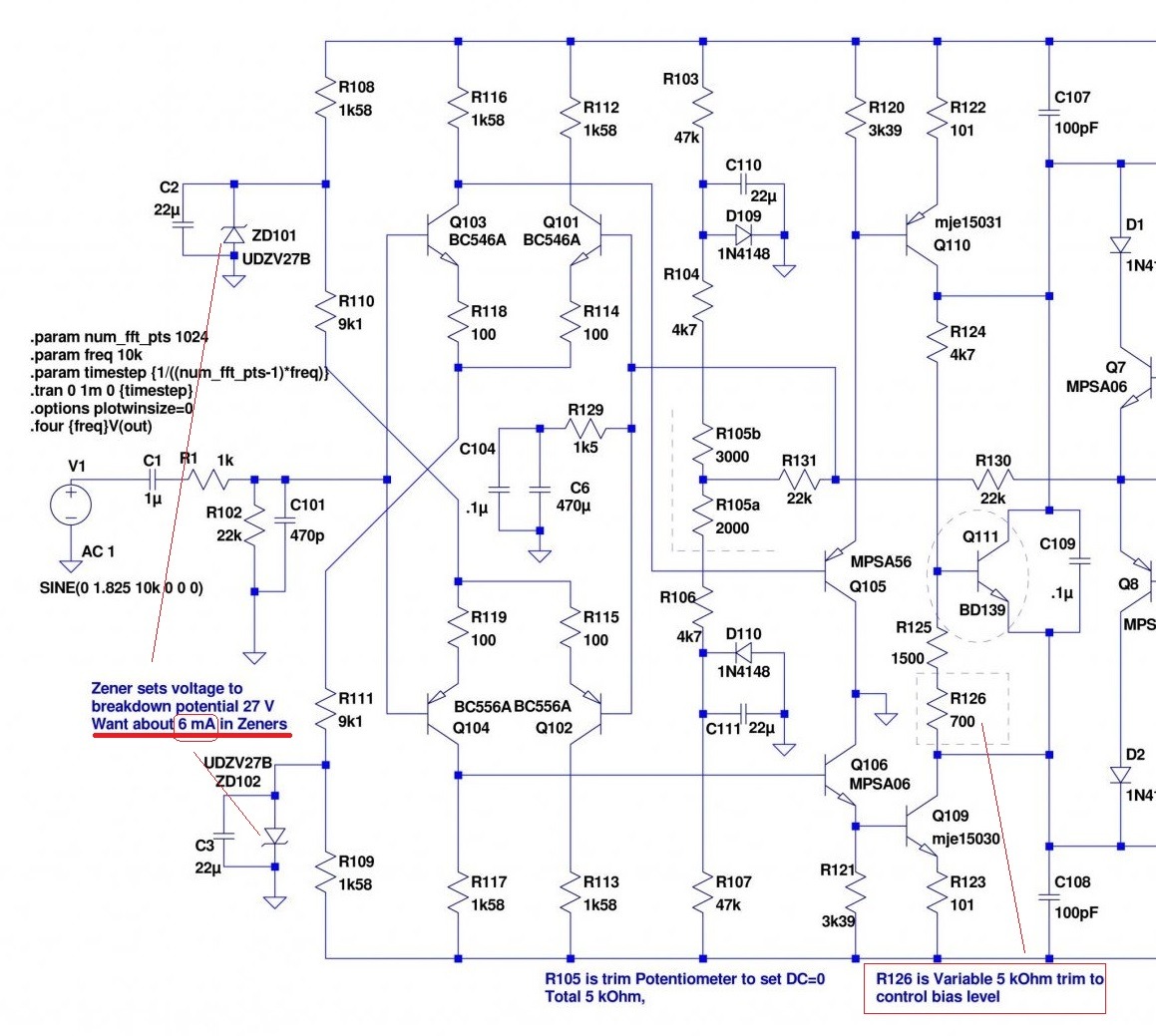

ok, not quite clear Q7 Q8? from what scheme?
Now we look at the scheme that you now have in the attachment:
1. I indicated the value of the current through the zener diode, which is indicated on your diagram, but this value is obtained at a supply voltage of + - 40 volts, and you have + - 36 volts, therefore the current will be much lower, and it is important that it is not lower than the consumption current diffcascade, otherwise it makes no sense. To do this, you need to reduce R108R109 - see my current map posted earlier.
2. R112 and R113 instead of them, it is better to put jumpers, the reason was also previously voiced, and Den himself reduced these resistors to 10 ohms in later versions of the circuits.
now by class of amplifier - in class B or AB, an amplifier is needed to get a lot of power for powerful speakers,
For the rest, in principle, it is, if your current on 3 pairs is 1.5A, then the amplifier will work in class A up to this current value, and then it will switch to class AB ...
Also pay attention to the location of the correction capacitors C107 and C108, since this is a clone, the clone developer intentionally rearranged these capacitors to get rid of the Мiller correction, but at the same time unsuccessfully placed them shorted to the power rails, where there is a lot of interference that can penetrate the input output stage. I don’t really like this arrangement of the correction - it worsens the transient characteristics of the amplifier, because additional current is required from the voltage amplifier to pump these capacitors in the high-frequency range.
