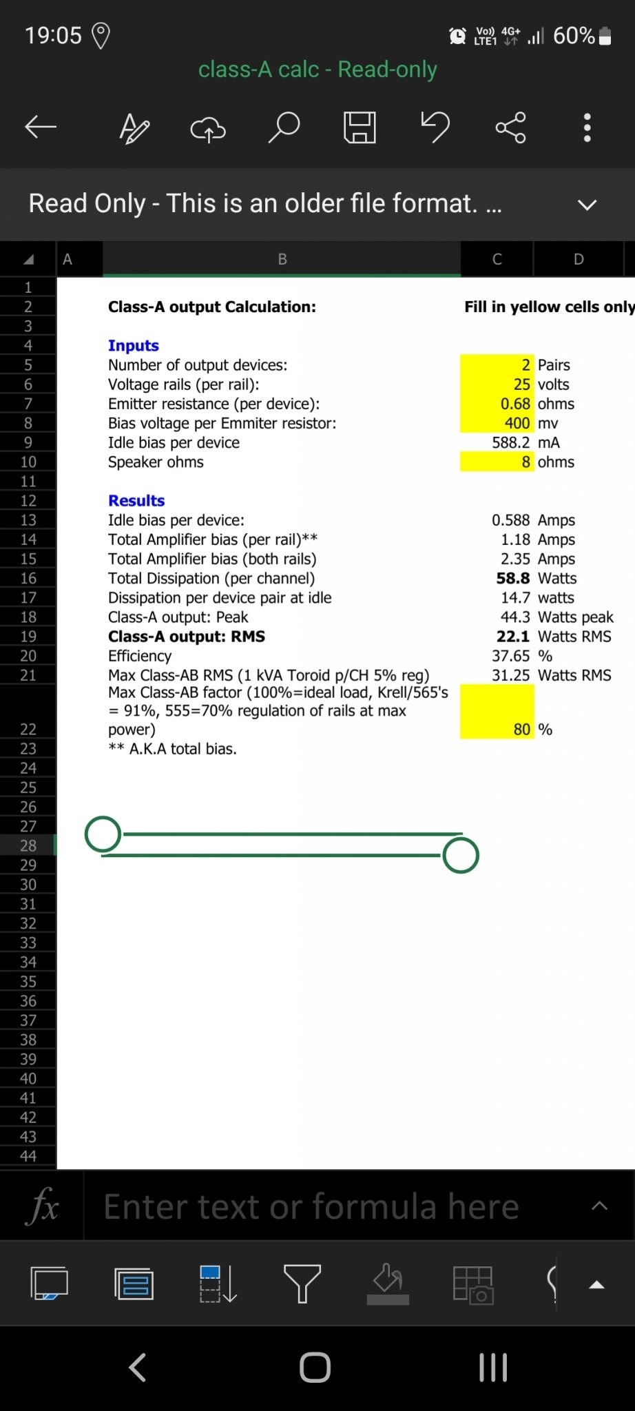

I guess that I'll have to find a light bulb to put in series with the primary winding for starters, connect a speaker and kepp my fingers crossed.
No takers on what mV to aim for?
What are you emitter resistor values? Mine were .649 ohms...shoot for lowish .250mv per emitter? I can't remember where I landed, but original KSA 50 had two output pairs, .9mv and .5 ohm emmitter resistors?
0.68ohms, I forgot about that.What are you emitter resistor values? Mine were .649 ohms...shoot for lowish .250mv per emitter? I can't remember where I landed, but original KSA 50 had two output pairs, .9mv and .5 ohm emmitter resistors?
You don't need a speaker attached for the first power up test. At the very first powerup with a dim bulb tester you should look at basic things like the bias current, bias current control and the output offset voltage.

As far as what bias point? There is actually a calculator chart posted within these almost 600 pages somewhere.
No, in turns of the circuit functioning correctly before biasing up to class A and connecting a speaker. To check for problems or faults.
Nope, no protection.You don't need a speaker attached for the first power up test. At the very first powerup with a dim bulb tester you should look at basic things like the bias current, bias current control and the output offset voltage.
See if the voltages in the circuit make sense.
Do you have a speaker protection board?
Found it. Post 1426.As far as what bias point? There is actually a calculator chart posted within these almost 600 pages somewhere.
Around 400mV for 22W.
Did I fill get it right?
Two pairs, 25v rails, 8ohm speakers.
I spent a while looking for that and never could find it. Thanks for sharing the page number.Found it. Post 1426.

I have an acquaintance who has a bunch of 300VA 2x24v Transformers but he is not easy to track down or get to reply. I plan on upgrading the Transformers to a pair of these if he ever replies and if I get the Amp to work.I spent a while looking for that and never could find it. Thanks for sharing the page number.

By the way, I take the response as I got it right 🙂

Glad to see the file I created is benefitting folks 18 years later... I did it in this build (Pinkmouse boards) as I did not understand how to bias Class -A amplifiers. Interestingly enough, it was papa Pass who walked me through the calculations, and I built the spreadsheet. I was forever in his debt that day forward 🙂Found it. Post 1426.
You and a lot more people 🙂Glad to see the file I created is benefitting folks 18 years later... I did it in this build (Pinkmouse boards) as I did not understand how to bias Class -A amplifiers. Interestingly enough, it was papa Pass who walked me through the calculations, and I built the spreadsheet. I was forever in his debt that day forward 🙂
