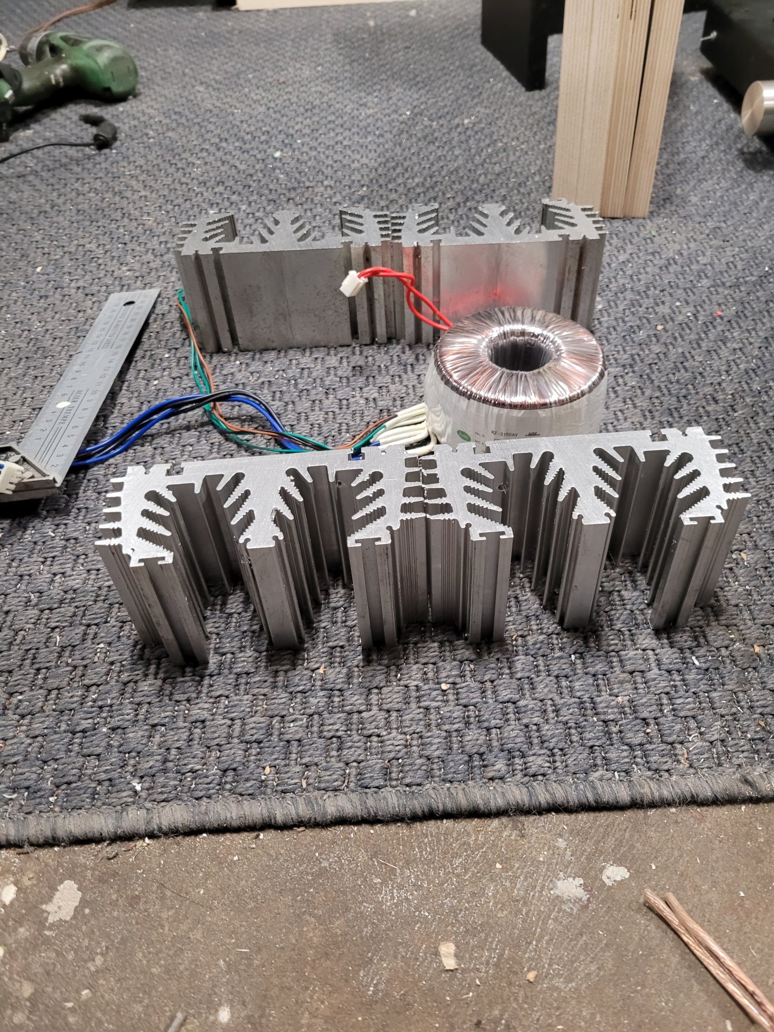

Now, after I made the chassis for my mono blocks with heat tunnel and fans I got these sinks cut from a larger part.
The sinks are about 130x75x60mm each and 10-12mm at the base.
My plan was to use them for a class-AB amp (Greg ball gb150) but seeing the result I am starting to wonder if these are large enough for the KSA-50.
What do you guys think?
I have think angle bars available to attach the TO-3 transistors but what about the heat?
Any qualified guesses?

Depends on the output power you aiming for but I would say (way) to small for a class A amplifier.

You could do what I did on my F5...bias up the amp until your sinks are consistently around 140F (I like to use Nelson's "hot hands" method).
I think you may be ok with your heatsinks at your set bias, but unfortunately, if the sinks are not already made for TO-3 transistors, anything you build onto the heatsink will add a lot of thermal inefficiencies, reducing the overall cooling capacity of the sinks...
Way too small unless you run at low bias.Now, after I made the chassis for my mono blocks with heat tunnel and fans I got these sinks cut from a larger part.

My heatsink for a pair of clones is 30cm x 12.5x12.5 with a 4" fan and TO3 cans run at about 60C & heatsink at 54C with a bias of 0.5amp per transistor for 36w (according to the calculator). With the fan turned off, the temperature shoots up to over 75C.
It would have been better to use a heatsink drilled for TO3 cans.
