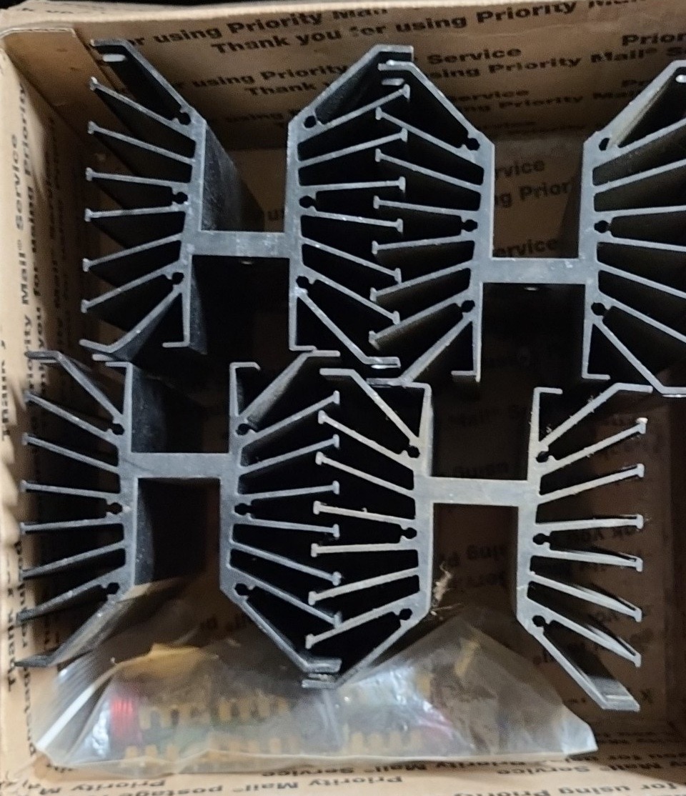

Hahaha ... yes that's the one... since I got a nice pair of 1KW transformers, a bunch of electrolytic caps, KSA-50 MK II boards (same KSA-100B) .. it was an easy decision.. my KSA-50 project stalled by not having a cooling solution which I liked to use .. been looking for cooling tower for a while .. and now better with a pair .. I hope the original circuit boards can be refurbished.

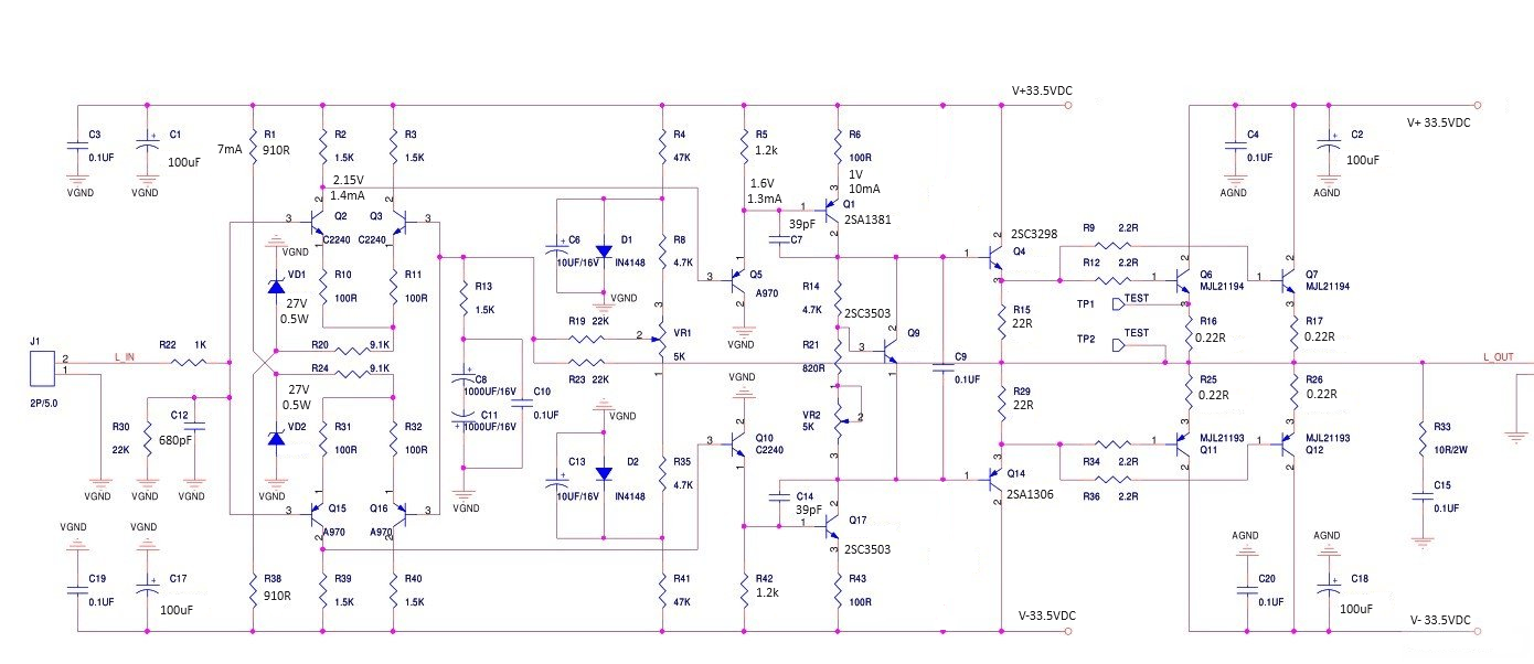

Here is my KSA50 schematic with voltage references if anybody is using a similar voltage. I am getting right at 50 watts/RMS/8 ohm load.
My KSA50 amps use +/- 33.5VDC, so in order to keep the zener diode circuit from possibly falling out of regulation, I am using 910R instead of 1k5 for R1 & R38. This allows approximately 7mA to flow through the circuit (3mA for the LTP and 4mA for regulation).
I also replaced the emitter follower (emitter resistors) R5 & R42 3k3 with 1k2. This allows approximately 1.3mA instead of 425uA to flow through the emitter follower.

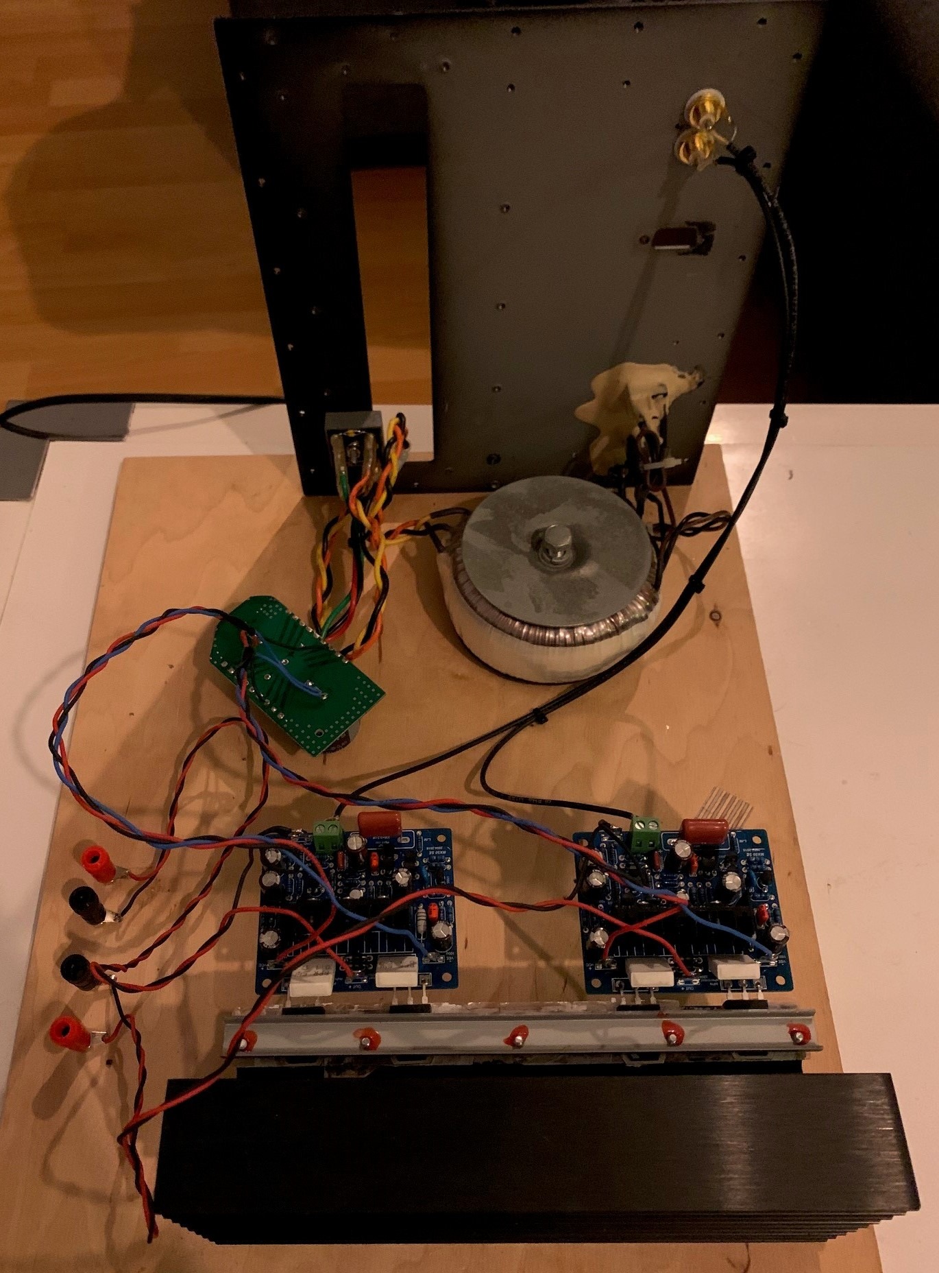

Been a long time since I've been on here. Was involved with this thread back in 2005 and did two large group buys of the PCB designed by Pinkmouse. Most of us back then also used six output devices per channel with an extra large power supply. My finished KSA-50 easily handles 2 ohm loads, and after all these years it still sounds magnificent. In case any one wonders, the open chassis prototype I built up in 2004 still exists and runs fine. A friend in central Illinois has it at the moment. I have lots of pictures from back then if anyone is interested, just let me know. Also, my amp was built in another manufacturers chassis as it had sufficient room for 12 O.P. devices, plus it already had forced air cooling.

I am going to keep one Z-5500 because I actually like the deep bass I am getting from it. The other two Z-5500 are ready for disassembling and feeding a KSA-50 lower power version clone. I already disassembled two Z-2300 and indeed they have a nice 21Vac toroid transformer (200VA?), 2x 10.000uF caps, large rectifier bridge and a nice large heatsink to which you can easily clamp any semiconductor formfactor. See attached test rig build Z-2300, feeding a LJM MX50SE stereo kit (which is great for the money and worked flawlessly on first power up). That 21Vac give me 27.8V unloaded, about 26.5 loaded and about 26.0V unppon clipping into 8R2.
