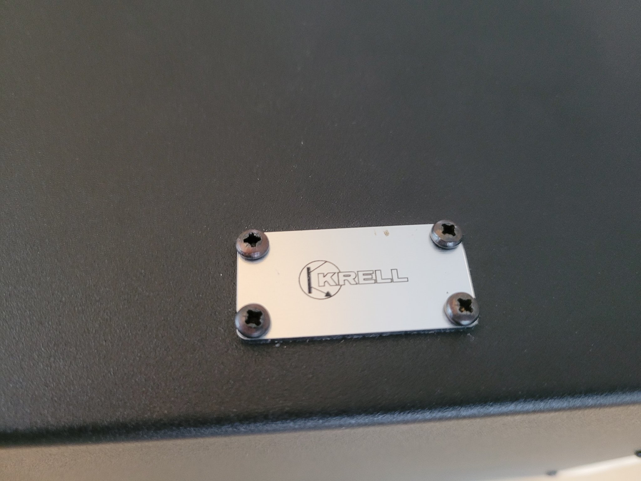

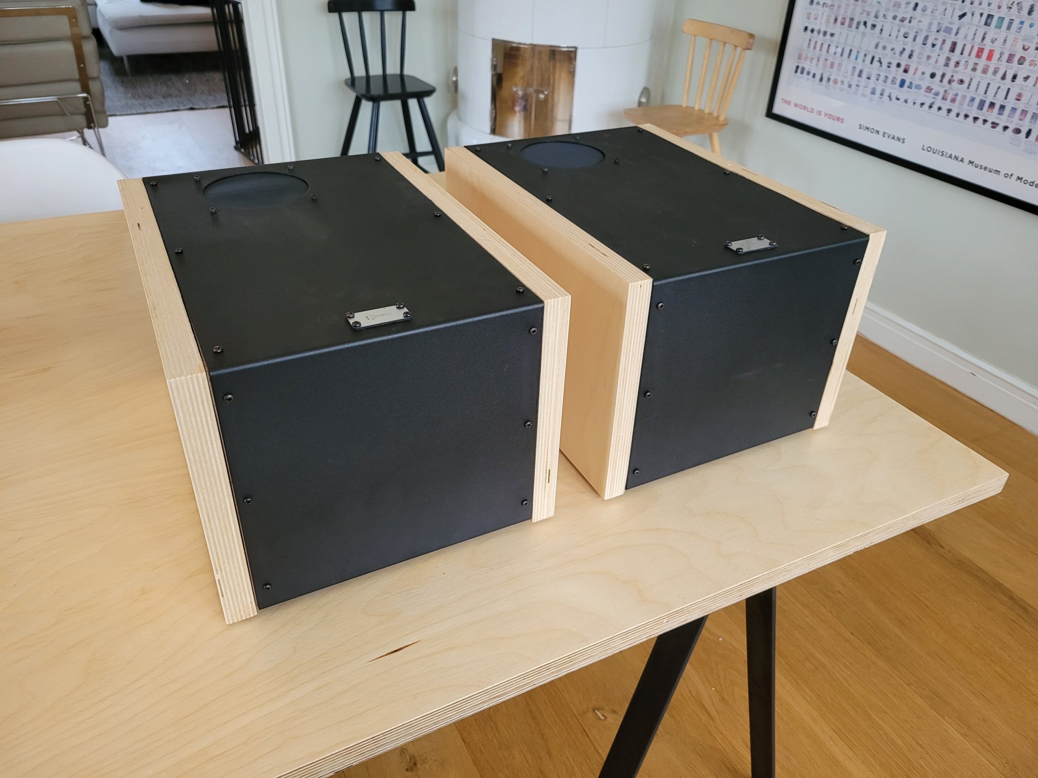

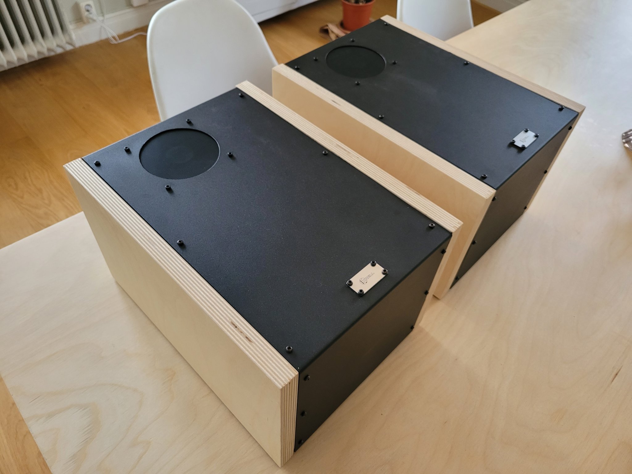

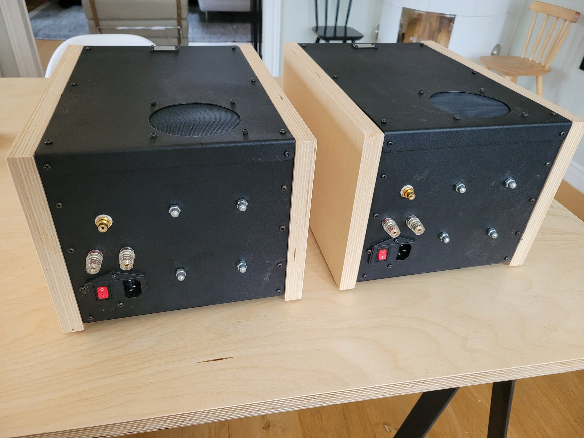

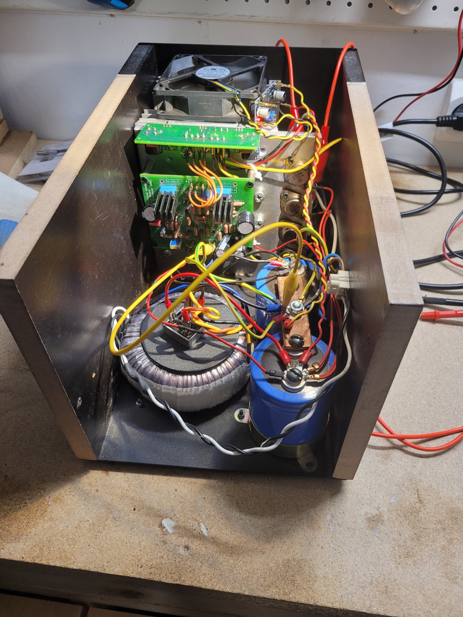

Ok, it took a decade or two but mine are finished.
2x Monoblocks, each with the following properties:
-1x Power transformer 2x26.4v at 300VA
-2x 68.000uF capacitors.
-1x Tunnel heatsink with 92mm fan.
-2x Pairs of MJ15003/15004.
  • Dimensions: 350x260x210mm (DxWxH)
  • Biased to 630mV per device.
20230206_092715.jpg 20230206_092751.jpg 20230206_092824.jpg 20230206_092729.jpg
Cable management, what is that?
