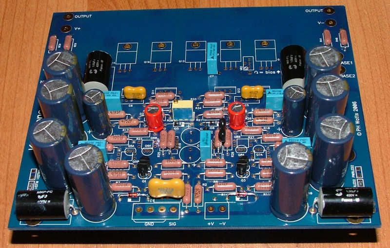

First Krell PCB completed.

I am very impressed with the work Pierre has done on this project. The finished product looks simple but it has consumed more time that meets the eye.
It will be interesting to see if there are any difference in the sonic character of this board versus a board assembled with ordinary run of the mill components ?
I have a niggling suspicion that one of the main reasons why the KSA50 was so popular was the fact that it had very short wirelengths between the PCB and the main output devices. I would not therefore not be surprised if the wiring layout is possibly more crucial than the actual quality of the board components. If so it could have drastic implications on the preferred heatsinks one should use with this project.

Here's some voltage's on mine so far
Board only, no output's
25v (+-) for device safety check
I'm using,
Q 1-4 2s#2240/970 GR hfe 320 all
Q 9-12 2sa968/C2238 Toshiba's
Q 5-8 ZVx2110A
Drivers, same as BOM
No cpx caps yet, except cp11/12 (.47uf Wima MKP10)
At 25v (+-) rail (across resistor) Star grd. the 1st or 2nd pad next to the sig. entry (note: silkscreened side cpx caps GND not connected)
R7= 2.1v R9 = 2.14v R 22= 1.37v R28= 1.39v
R8= 2.1v R10= 2.15v R 23 = 1.26v R29= 1.26v
These should be close when bringing up on a Varaic- if not then you have Q1-4 in the wrong location's like this DA did..,.. :xeye:
R38-41 adjust VR2 to 1.0v for now
C7= 3.1v
Full rail voltage (1 monoblock)
Avel 800va 40+40
AC 117v = 59v unloaded
TO-3 MJ15024/25 outputs
Bias set for .250v (for now) across any 1 emitter (.47ohm)
PNP (4) 11mv +/- NPN (4) 26mv +-
54.4v loaded at (.250v ) bias level
R7-10 all 7.65v
R22=1.2v R28= 1.3v
R23=1.18v R29= 1.18
R38-41= .900v all (at .250v bias)
Output dc= less than 1/2 a MV wander
Heat sink temp- Each measure 8"x 8 1/2"x 3" (4 TO3 outputs) on each is 58C (bias .250v) without fan
At full bias (.580v+) these will have to fan cooled for sure.
No issues yet (3hours running) 🙂

PWatts said:
OK here it is, a fully populated PCB... there are 5 Black Gates, 6 Panasonic FC, 2 Mundorf, 1 teflon-film and a motherload of Riken resistors per board.. and of course blue LED's 😀
Damn, & I thought PRP, IRC and Holco resistors were expensive! Good job on the board! 😎 Save those gold plated cut off leads for use as jumpers on other projects?

This is where I am so far on the component side.
Regards
