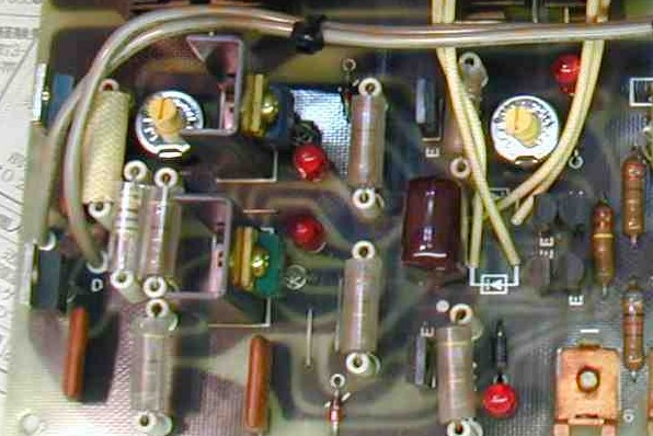

the teflon sleeving is serious, it requires a medical/watchmaker magnafying glass/light to get the resistor leads in the sleeve. The sleeves and stand-offs make the soldering easier, peek some pictures of older Mark Levinson gear or big buck Japanese amps.
Here's a pic of an IKEA beaded Burmester power amp board, Toshiba RET 2SA1095/2SC2565 drivers and triple Sanken RET 2SA1216/2SC2922 output stage. Twice the MSRP of a KSA100.
(B&W pics allow for a decent picture size on a file size limit of 60Kb ! )

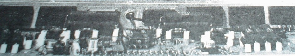

The Miller caps should work fine with 47pF or 100pF, I doubt if it would make an audible difference. Going on memory, many people used different values on the KSA50 without problem. Easiest would be to check the 10kHz squarewave response with both values, smaller may ring a bit, larger will round it off slightly. Otherwise go for 33pF and another one tack-soldered on the bottom; you'll have to do that with the 20pF cap as well anyway.
The NFB was wired as follows: The boards were mounted on the heat tunnels, with four NPN's on the left and PNP's on the right. The TO-3's were mounted along with their emitter resistors on small PCB's, and the back pair's wires were simply passed through the front pair, with each pair having its own base wire. The cable lengths were therefore not nearly the same. They were wired into the boards exactly as mine are, with the output the large fat trace at the top connecting the two pads. The speaker output was taken at the front pair of the NPN for the left channel and PNP for the right (to keep it at the chassis's edge), so the length of the transistors to the speaker terminals also differed by over 20cm from the opposite back pair.
You can therefore say that the NFB joint is on the boards in the top centre, and the path is (for the left channel) NPN back pair, NPN front pair+spk out, board, PNP front pair, PNP back pair. For the right it's NPN back pair, NPN front pair, board, PNP front pair+spk out, PNP back pair.
In conclusion, a pretty horrid scheme so you're likely to only improve on that. With faster transistors e.g. MJL4281/4302 it will perhaps not work too well though.

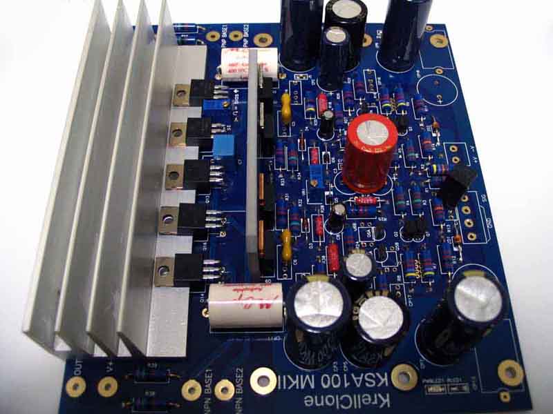

OK here it is, a fully populated PCB. It's safe to assume that this is the most exotic Krell ever component-wise, those who know Parts Connexion's catalogue may recognise most of them - suffice to say there are 5 Black Gates, 6 Panasonic FC, 2 Mundorf, 1 teflon-film and a motherload of Riken resistors per board.. and of course blue LED's 😀
- Krell KSA 100mkII Clone
