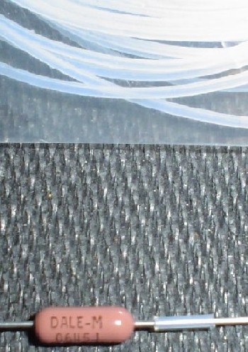

Houston, we have a go on the Krell space project but Weird Jaccowitz is wearing teflon socks again. 😴
Hit it, boys
