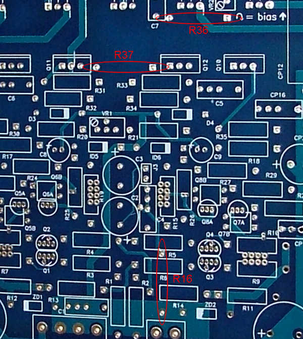

Thanks AVWERK. Must be something like that because there's no space foreseen on the component side. It's possible that this question was raised before but the thread is becoming a bit long to go back and search for it. It's also not mentioned in the "Everything You Need To Know About The KSA100 Clone Was But Too Afraid To Ask section", or I didn't see it.
Regards
Regards
GeWa said:where R16
C4 goes on the top, therefore R16 is on the bottom.
There's a vacant pad between R5 and R6.
It's nice to see people at last starting to build the amp, was wondering when the questions would start coming about the resistors I've placed at the bottom
And yes, there's no support for the 20pF cap since there was no space on the layout when I saw it on the original (not present on the schematic), so it has to be tack-soldered at the bottom too. All mentioned in the FAQ, but I guess the phrase "afraid to ask" should be replaced by "lazy to read"

PWatts said:It's nice to see people at last starting to build the amp, was wondering when the questions would start coming about the resistors I've placed at the bottom

if you have not yet bought VR2 then I suggest some lower values for R36, R37 & VR2.
R36=430r
R37=2k4
VR2=1k
The bias current through Q13 is about 17mA and the resulting base current will be about 0.2mA.
The current through the resistor string R37 VR2 R36 is of a similar value. Ir36=0.65/R36~=0.65/1k5=0.43mA, when bias is set to maximum. Resistor current falls to just 0.2mA when VR2 is set to 1k75.
A small change in Q13 base current will have a very significant effect on the current passing through R37 and the resulting multiplication ratio will swing (unstable?) when Q13 base current varies.
Using reduced values for the resistor string will help to keep the multiplication ratio nearer to a constant value. Reducing R36 from 1k5 to 430r increases the maximum resistor current from 0.43mA to 1.5mA. This is still well within the current limit of a 300mW 1k multi-turn pot.
There may be an advantage to going even lower with these resistor values.

Yip that's right. On the later iteration of the board (which unfortunately reached Mark too late for manufacture) I made it better laid out. Depending on your predriver heatsink you can mount R37 on top, but if you use foldback type heatsinks as in the original then they'll be in the way.
