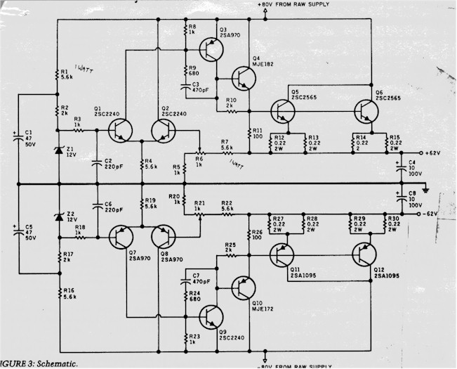

Let's see now if I got it right. I used the PCB CAD file that's on that website, but with rectifiers and filter caps offboard so omitting that left section. I actually have CRC before the multiplier, and both the ground from the second pair of these caps, and the output ground, I wired to the two large holes in the middle of the multiplier half's star ground on the PCB drawing.
A few transistor shunt regulator on the front end may make an excellent regulator to complement the Krell PSRR. It could even have a lm317 or tl431 current reg upstream to reduce dissipation in the shunt and improve the rejection characteristics.Crowbar said:........If I were to use separate regulation for the rest of the amp (than the output stages), why not go all the way and use a good shunt regulator? Efficiency is really only an issue with the output stage anyway.......
Even a cascode reg might work (Walt Jung's recent paper posted on the Forum may help)
There are many options when we are dealing with <40mA @ 52Vdc.

rjkdivin said:Linesource,
Your thumbnail link for the schematic is not functioning.
Robert
Regulator...

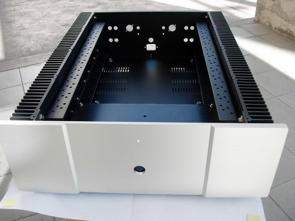

ATI chassis
Folks, I think this was discussed here but I'm not certain. Does the "big" ATI chassis attached have adequate cooling capacity to chill-out the KSA100?
Front plate: 482.60 w (19") X 165.10 h (6.5") ( 6mm thickness )
Body size : 355.60 w (14") X 162.56 h (6.4") X 596.90 d (23.5") ( 2 mm thickness )
Solid aluminum feet
Heat sink included
Switch Power on-off and knob included (Aluminum)
Thermal rating per side of the heatsink = 0.279 C/W
Shawn.

I have a similar size amp to yours, only you have 4 sections of sinks down each side mine has 3. I use one of these for an aleph 2 monoblock which disipates 300 watts of heat, It has 8mm aluminium l;id and front plate, 4 mm base. It could easily dissipate 350 watts in our cool climate but wouldnot want to get hotter. I would say your case would be good for 400 to 450 Tops. A second one would be nice🙂

Re: ATI chassis
is that for a monoblock or stereo?
Each channel has to dissipate Iq*Vrail*2. For a standard single channel biassed to 2.6A and running from +-52V that equates to 270W.
deltaTsink=270*0.279/derating factor. If DF=1 then one channel mounted on one side gives dT=75Cdeg. Add on ambient, add on Rth c-s, and you will have Tc~110degC.
Putting 270W through both sides gives Tc~72degC. Still a bit hot.
What would be the derating factor for 135W into these sinks when deltaT is 37.6Cdeg? Sinks are usually specified for 70 to 80Cdeg.
I think that the sinks are too small for a monoblock, they may also be too far apart and the long wiring could be a problem (I have this same problem to address).
I would aim for <=0.1C/W before derating for each monoblock dissipating 270W. If you change the rail voltage or the bias current, the operational dissipation has to be designed for.

This post states the two heatsinks of the ATI cases are rated at 0.075cw.
I don't kown what is the correct cw. Comparing the ATI-639M to the 4HE depth 400mm pessante dissipante from Hifi2000. They are both comparable in height, but the ATI is almost 20cm deeper. And if I recall correct the Hifi2000 has a cw of 0.22.
So the Hifi2000 is 20cm shorter, is looks otherwise comparable, but is more efficient in dissipating heat???
If the 0.075cw is correct, the case just becomes a whole lot more intesesting.
If it's any help: the ATI case is a close copy of the 1986 Jeff Rowland monaural Model 7 chassis, with the front plate design pinched from another big US audio boy.
The ATI also has 26 TO-3 mounting positions, just like the Model 7.
24 TO-3 output devices + 2 TO-3 driver devices on the M7
(or JRDG, or Rowland Research as the company was named back then)
The Model 7 run partly in Class A and was very modestly rated at 350 watts in 8 Ohms. (the actual power level was 450)
Some data and dimensions of the Model 7 should still be at Jeff's company site. (Jeff is turning 56 this year, just as big daddy P)
The ATI should handle 300 watts of dissipation with ease.
Don't believe it, go feel a model 7.
0.075 C/W should be on the spot.
