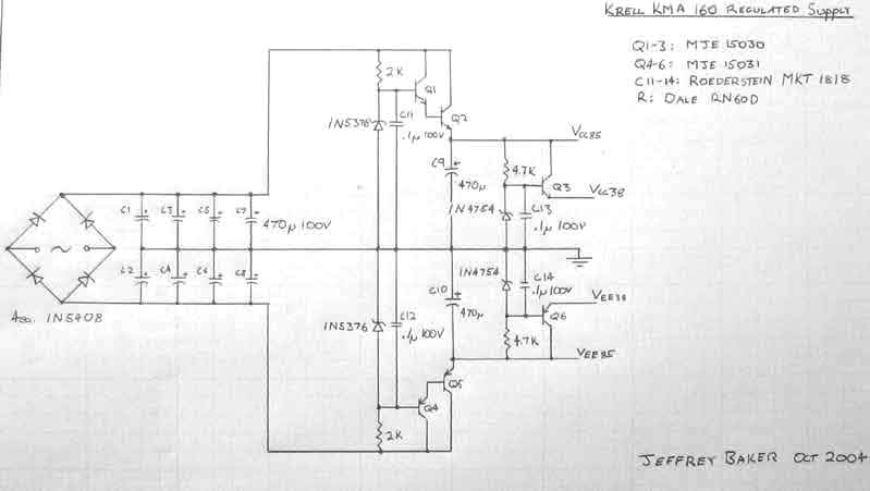

Regulated supply
I've been thinking about my build attempt at this amp and I really think the pre/driver board from Watts/Gulbrandsen should have a regulated supply for optimum performance. I'm not certain I can draw up a good performance circuit for this task. I'm not even certain of the power consumption of the driver board on its own?
So I'm wondering if there is someone out there that has a schematic up to the task. Also, is there trouble if the pre/driver board circuit has a separate power supply including a separate transformer? Any advice to would be great!
Shawn.
Shawn.

Re: Regulated supply
Shawn, this could be a starting point to go for. This regulated power supply did Krell use in the KMA160 and could easilly be modified to suit the KSA100. Guess there is a simple task to switch the zeners for to get lower voltage for the drivers (60-70V)
Regards 😎
TomWaits said:I've been thinking about my build attempt at this amp and I really think the pre/driver board from Watts/Gulbrandsen should have a regulated supply for optimum performance. I'm not certain I can draw up a good performance circuit for this task. I'm not even certain of the power consumption of the driver board on its own?
Shawn.
Regards 😎

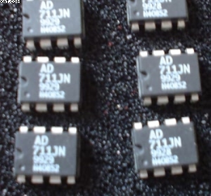

Package received
Mark
I received the boards and diodes today. Many thanks for the excellent packaging. I do appreciate it.
