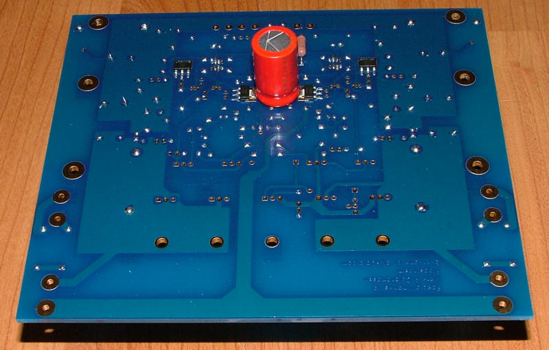

Q9 & Q10 run hot.
I have slightly low voltage on the rails (+-48Vdc) and just 770mW being dissipated.
I fitted 20C/W clip on sinks and delta Ts is about 30Cdeg indicating that the advertised 20C/W is nearer double that.
I am going to remount these two transistors on the reverse side to give more room for a larger sink to dissipate 900mW with a delta Ts of about 20Cdeg resulting in Tj of about 50degC. They are just too far away from the driver sink to bolt on there.

Today, 28th of June, I finally received the heat sink for the drivers (6 pcs of AAVID OS499, black anodized).😀
I also intend to mount two of the pre-drivers (Q9+Q10) on the same heat sink (on the back/solder side, the same as Mr Andrew intend to do/have done?)
I will post pictures when the heat sink has been mounted to the board so you could see how this could be done (6 drivers + two pre-drivers including Q13 on the same sink).

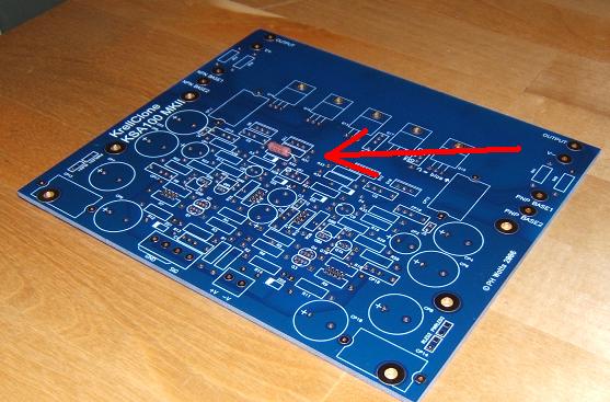

Hi Jozua,
can you confirm what Thiele network is fitted?
Where is the NFB taken from? The standard PCB location?
NFB standard PCB location as on the clone; with Thiele I assume you mean the snubber at the output, which is 5R6 and 100nF.
Thiele network=series C+R in parallel to the load and parallel R//L in series with the load. Some or all of these components are often omitted without any deleterious effect, but equally can make the amplifier feedback circuit susceptible to reactive loads. Changes in the sound as the cable is swapped could fall into the reactive load problem.
I have not had a chance to experiment with the NFB location yet, but the Klone location which I believe copies the Krell location is plainly wrong in engineering terms, but this error may have no effect on the resulting sound.

Hi Pwatts,
like I said, omission of some of the Thiele components may cause no deleterious effect on the sound. Krell may have deliberately used the Zobel alone to develop a "KRELL" sound. Does anyone know?
The NFB tapping point is not decided in my head. I would appreciate comment from both theoretical and practical viewpoints on moving the tapping to the output emitter resistors or even to the Zobel located on the speaker terminals. The problem I have is that both of these more technically correct locations have a LONG wire connection from tapping point to inverting input location. The introduction of that long wire with a 20k resistor in it may introduce much worse effects than simply accepting the standard location.
Experimentation may offer a solution.
What if the output Zobel were arranged as a cap to the ground terminal and a resistor to the live terminal and the junction between these two becomes the NFB tapping point (as Dr Cherry proposes)?
