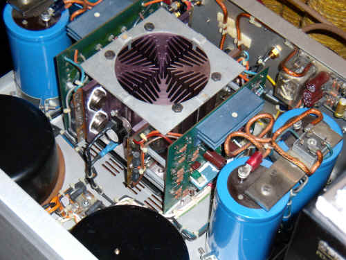

Hi
Here is a picture of the yellow van Den Hul cable that was added between the output devices. It was done simply as a test and the other side of the output devices cable's were left untouched as the whole heatsink block needs to taken out to gain access to the solder joints.
The Black wires running from the PCB to the output devices are CS18 Van den Hull wire.
After a weekend of listening I switched back to my 50.2 and suddenly the 50.2 sounded thin compared to the rich and full detailed sound of the 100.2. It is incredible to think that such a short piece of wire could have such a great impact on the sound.
Suddenly I am beginning to wonder how my Clone 50 will sound if I change the wiring between the output devices to a thicker multistrand cable?
Jozua
Hi
Jozua

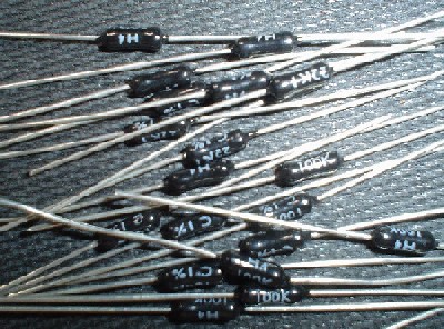

In the meantime, some Holsworthy hollow copper lead resistors, Debbie Krell does England.

PCB Hookup Hint
Hi
Have a look at how close the PCB is to the output devices of a KSA50 and what short hookup wires was used compared to a KSA100 or 80B.
My gut feeling to all the potential clone builders is that
the shorter the hookup wire between the PCB and output devices the better the amp is going to sound.
Jozua
Hi
Jozua
