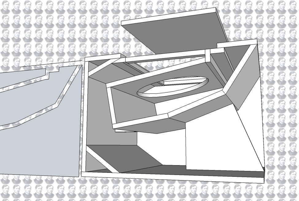

@apex
Yes your right about that 150hz and it does not go low down the sub domain (40Hz below).
i use to have this subscoop 218 with infrasub 218... ss218 doin the passband 50hz to 120hz and highpass at 50z...this will be couple by a is218 50hz xing at 50hz(Example Drawing below)...this will be a 4 way active system. That was about 10 years ago.
today we only use a WSX clone and a 12"x2 + 8" + 1" for the Horn loaded tops for a simple 3 way setup...it will do Live and Dance.
Have a nice day,
jojo
Have a nice day,
jojo

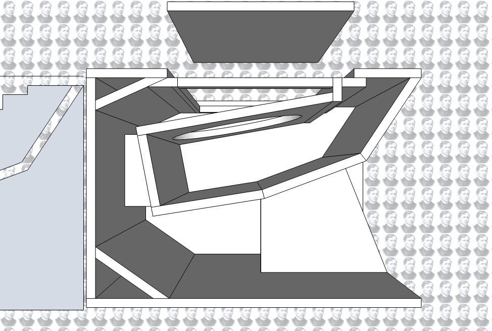

@dj_jojo_md
sir what si the depth of the box. I forgot my trigonometry in determinig the adjacent side. I mean from front to back.
thanks,
watosi
thanks,
watosi
@dj_jojo_md
thanks,
watosi
i am very sorry i forgot that one...it's 24".
my bad.
have a nice day,
jojo

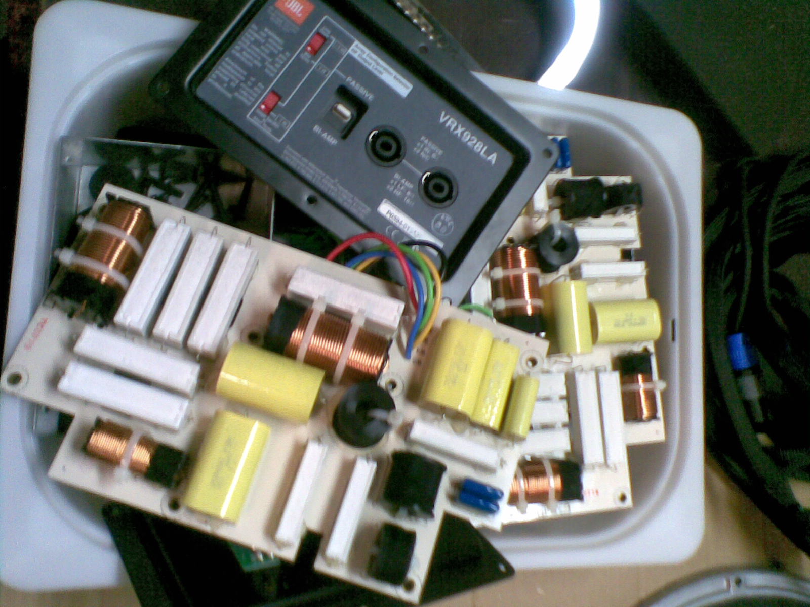

Hi guys, it's been a long time since i got here. I Have a questions to all you masters 🙂 i'm planning to build a dual 15 midhighs like the SR of JBL and nowadays Kevler. my question are, are those SR's has a crossover inside? if so, what kind of crossover they have? and does it mean that 1 cab is already 4ohms? because it has two 15 inch woofer.
Any answer are appreciated, Thanks in Advance
yes they have passive crossover inside, mostly 3rd order on highs and 2nd order on lows, they are complicated, see the attached schematic of sr4733 and the picture of vrx network we dismantled

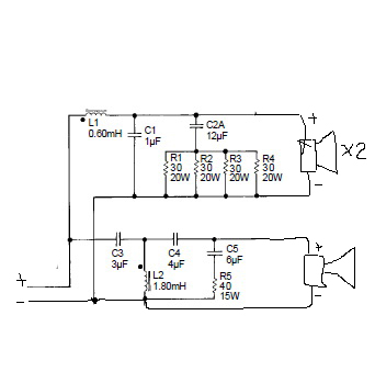

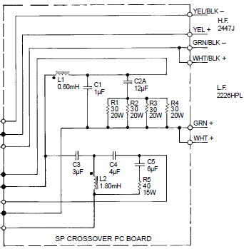

JBL SR4733X
SPECIFICATIONS
ACOUSTIC & ELECTRICAL SPECIFICATIONS:
• Nominal Impedance: 4 ohms
• Power Capacity: 1200W Continuous Pink Noise
• Frequency Range: 35 Hz – 18 kHz (–10dB)
• Sensitivity: 100 dB SPL, 1 Watt @ 1 Meter
• Crossover Frequency: 1.2 kHz

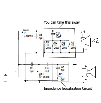

OK lets make it SIMPLE...JBL SR4733X network is a very straight forward design very simple...what's making it complicated is the switching circuit from Bi-amp to Full-range.

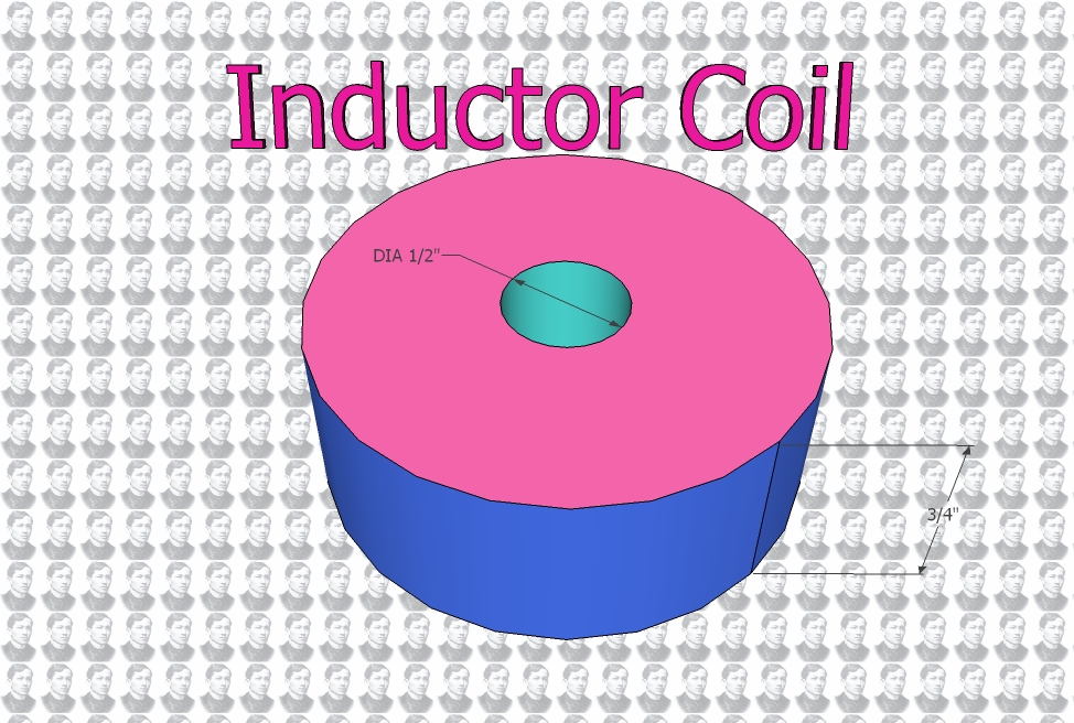

First we dissect the passive network itself...then will make the inductor coil below.
Inductance 0.6 mH
DC Resistance 0.18 Ohms
Wire Gauge 16 AWG
Wire Diameter 50.8 mils (1 mil = .001 in)
Coil Length 0.75 in
Coil Inner Diameter 0.5 in
Coil Outer Diameter 1.72 in
Average Turn Diameter 1.02 in
Wire Length 45.07 feet
Copper Weight 0.35 pounds
Turns 168
Levels 11.38
Turns/Level 14.76
Inductance 1.81 mH
DC Resistance 0.33 Ohms
Wire Gauge 16 AWG
Coil Length 0.75 in
Coil Outer Diameter 2.23 in
Average Turn Diameter 1.28 in
Wire Length 81.6 feet
Copper Weight 0.64 pounds
Turns 243
Levels 16.46
Turns/Level 14.76
Then follow the circuit in the pics...
Enjoy...
jojo

you cannot just scale down any box...it's a mathematical equation to do that.
But i can share you this C horn for 15" driver...
I will post the dimension if want it.
have a nice day,
jojo
have a nice day,
jojo
ok thank you sir...
i'd like to see the dimensions sir...
regards
ees...
