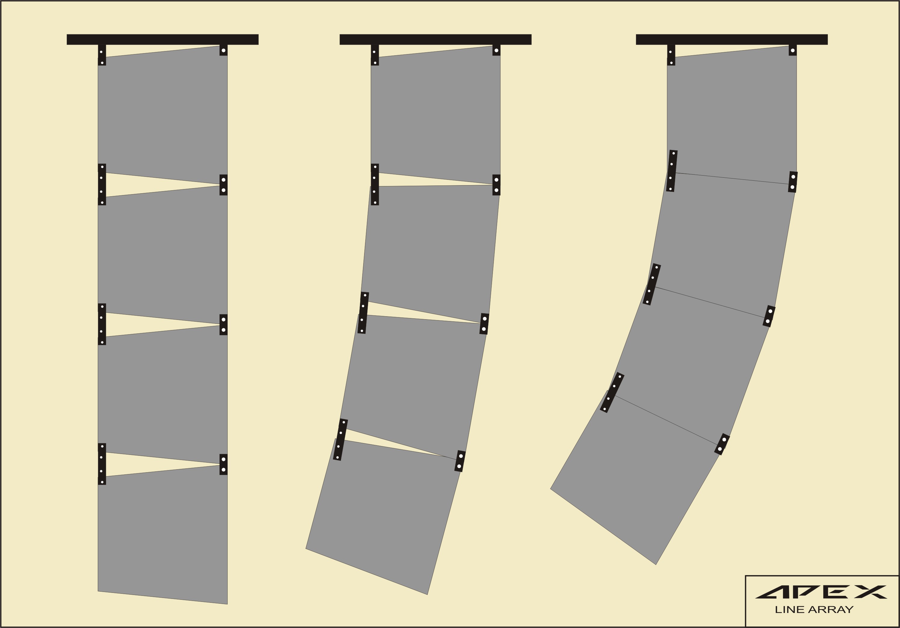

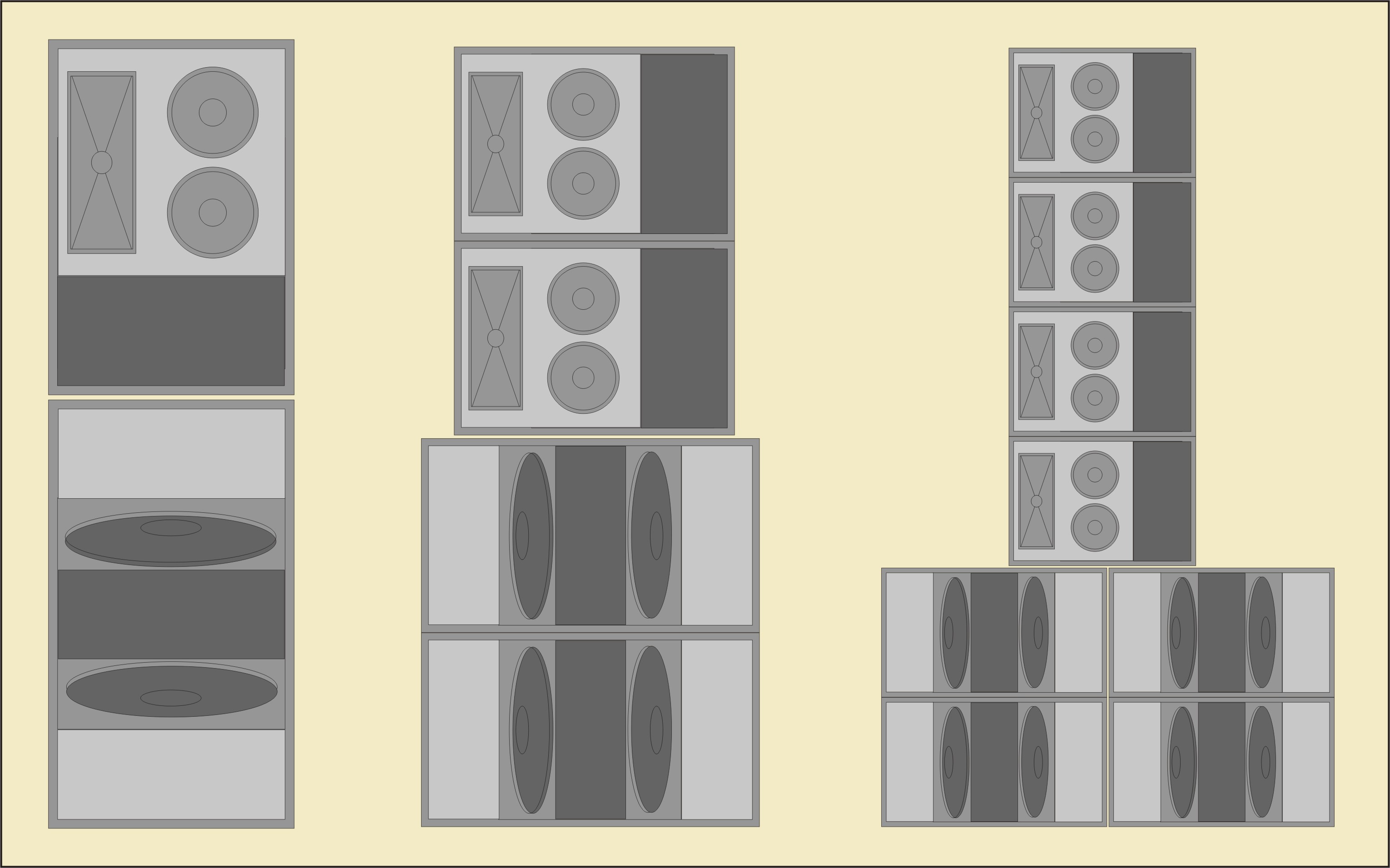

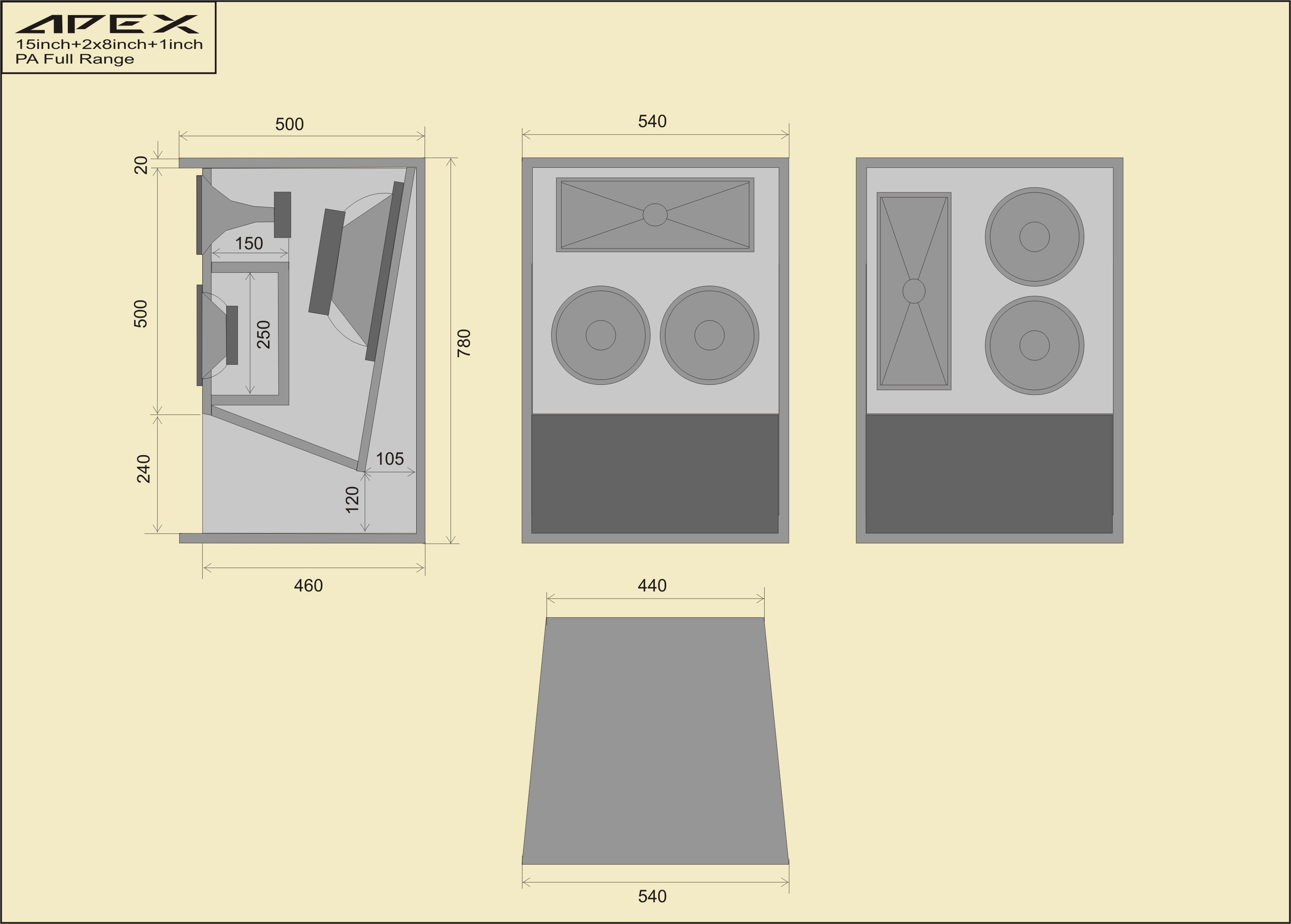

@apex

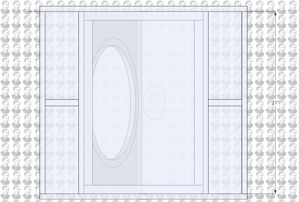

very good configuration...but this will require the following...
1. loudspeaker Management Processor...to correct the time alignment issues...in the Mid/Hi Tops section you will notice that the 15" horn is long, so there is a delay, again those 2x8" front loaded and the CD horn is horn loaded again a delay...the CD horn vs the Mid Bass 15" horn is also delayed...a lot comb filtering is happening...corrective action is to use a DBX DR or Behringer UltraDrive.
2.CD horn looks too wide to be use for Line Array configuration...it will cause cancellation...use a horn with a constant directivity horn for line array, Beyma has a good one.
3. Rigging a Line array is very dangerous and expensive...observe safety precautions.
other than the above, everything looks good.
just my thoughts,
have a nice day,
jojo

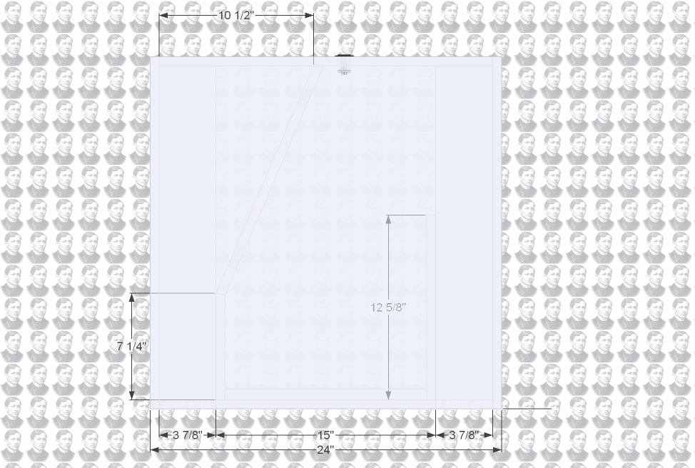

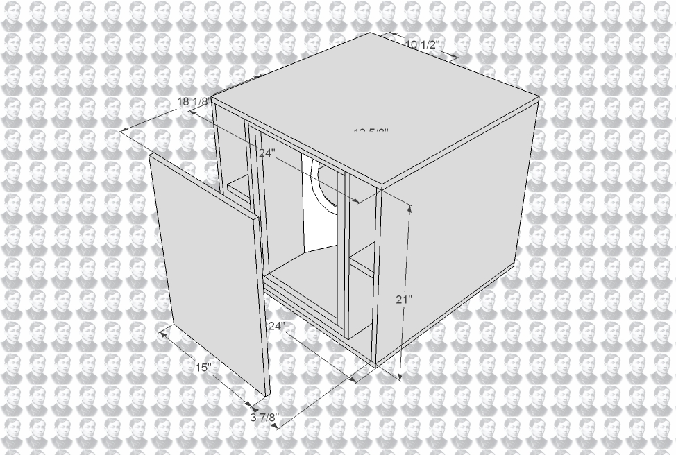

@dj_jojo_md
Sir jojo, i'm a new member in diy forum. I'm planning to build a 15 inch subwoofer for home use only. I'm tired of small home theater set up. I bought a lexus la 6000, samson gate compressor, sonic maximizer, distribution amp, and 31 band eq. I already have a pioner and technics receiver, but they are in no way can create a mini earthquake. I've got 2 pairs of 15 inch 2 way speakers. I'm planning to buy a crell CA16 or maybe a QSC GX5 or the new lexus series.
what I need sir jojo is a sub that can seriously cause a chest thumping sound tuned at 50Hz. I know that you are a pro in enclosure design for i have seen your previous thread.
Thanks in advance

@watosi
Those 15" tops of yours can easily handle chest thumps freq,but here is a simple 15" BP subwoofer for HT...
have a nice day,
jojo

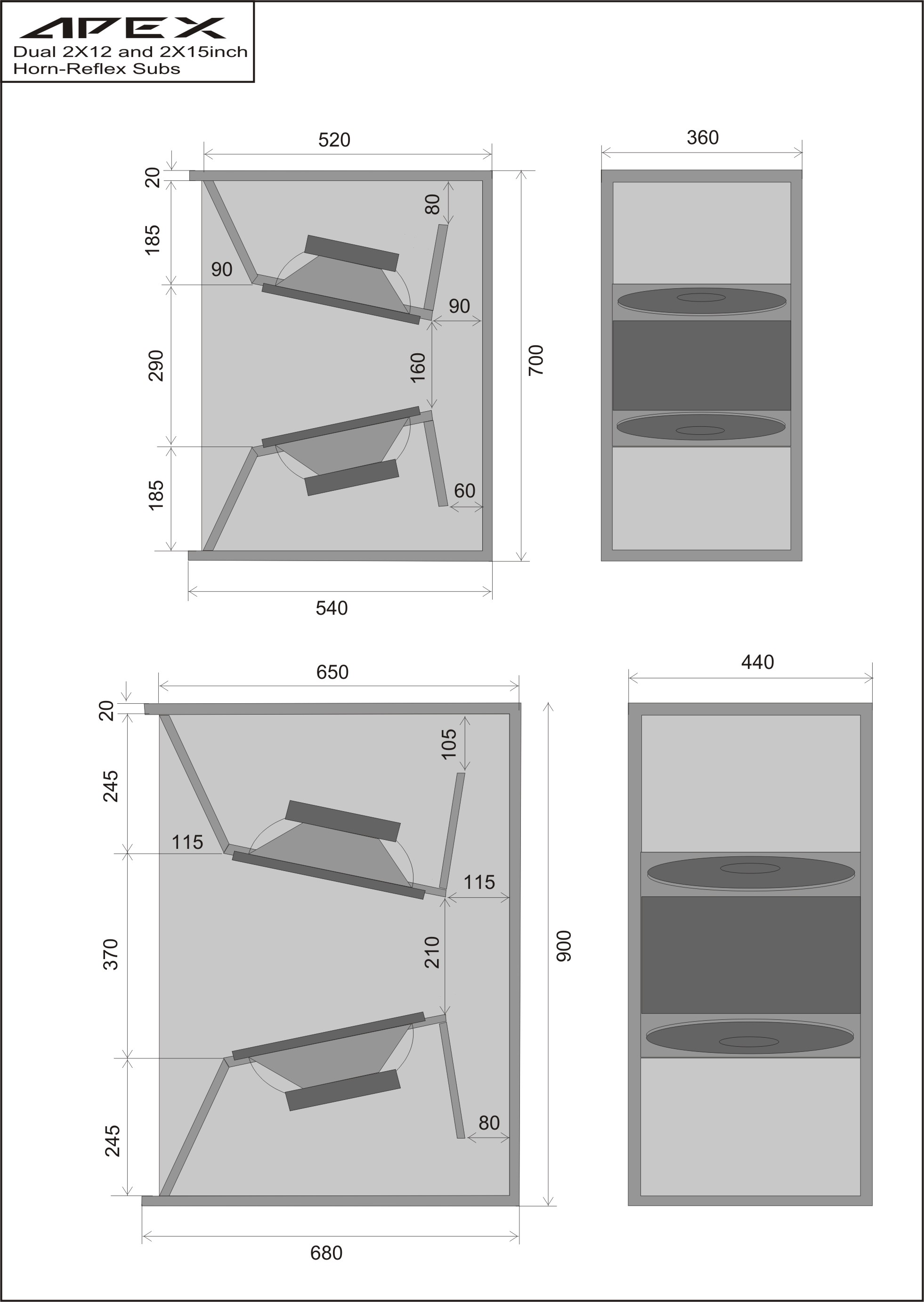

Looks like X1 from speakerplans, is it for 18"?
http://www.speakerplans.com/index.php?id=x1
@apexaudio
Yes Sir they look the same...this one is for 15" driver...but this one cannot outrun X1...X1 is a 18" bandpass and BIG enough to shake your house.
Your 15" Hybrid bandpass is also a good example of small footprint subwoofer...it is almost the same with EV mt subscoops, Beyma and Cubo15.
have a nice day,
jojo
