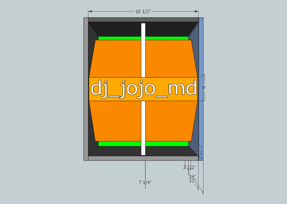

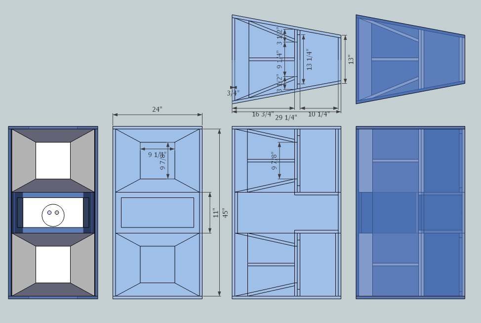

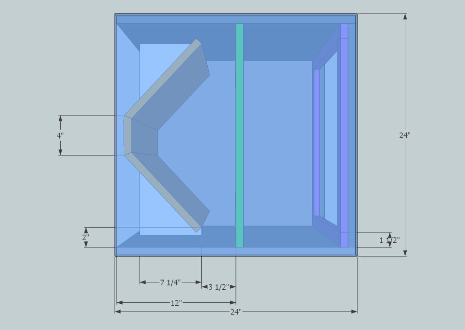

Yes i will post it as soon im done with the drawing...WSX no need to put some damping materials...its long wave so no standingwave inside the box.
