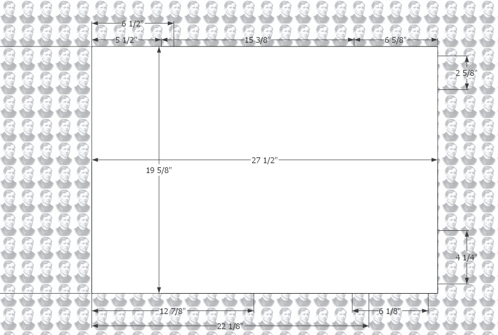

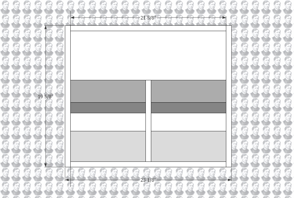

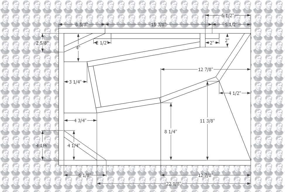

I hope you find this useful...it's a kick bassbin so this may not go very low...
enjoi...
