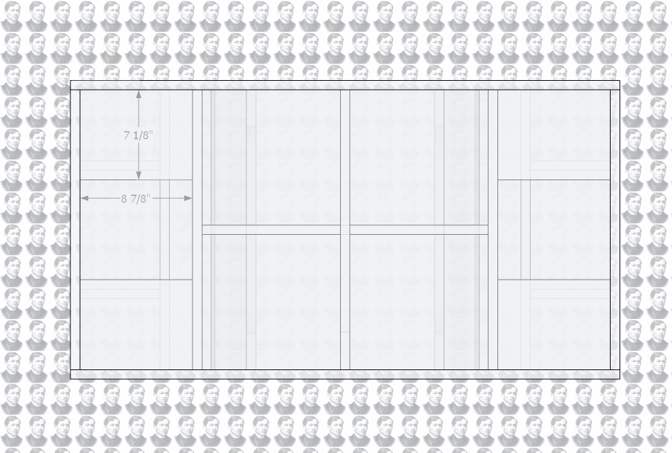

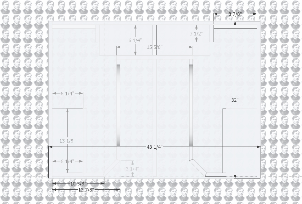

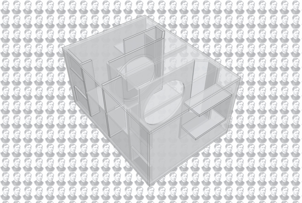

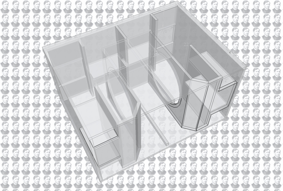

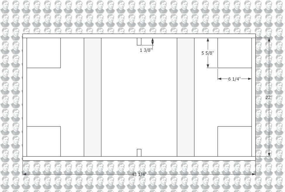

dj jojo md
sir do you have plans for manifold 2x18?
does this throw farther low's as w-bin does?
i heard this once in closed spaced but how about in outdoors?
and is it easy to tune?
speaking of w-bins popularity,what is the most compact design for low's these days that can throw as far and as pure low,deep low that can feel in chest ''not in the head'',
low's like pounding your chest (right into listeners heart),
is it the wsx?
sorry sir too many query
dj jojo md
is it the wsx?
I will post the plans...
Horn loaded(WSX or Wbox) speakerbox are far more efficient than any type or configuration of speakerboxes (Vented Bass reflex, Sealed or Bandpass).
But, horn loaded boxes are big and required to be used in groups.
The throw or SPL will depend on your setup...the more stack you have, the more power directional control you get...and also it depends on the venue.
Chest thumps...this will be around 50Hz to 90Hz.
Flapping pants...50Hz below.
WSX is one of the most efficient horn loaded i have experience next to Tappedhorn.
All was based on a Cloned version...imagine if it was real thing!

dj jojo md,
i found this at horn plan,
check this out
Plan WSX Martin
the plan you post,(wsx,)
another contruction detail of wsx plan
@engel dela pena
Yes Sir...I know the site...they are new site and just updated their archives.
my copy came from the guy who originally post it first in his web page 10 years ago or more...i think...to old to remember correctly...but he is a good Australian guy...he shared a lot of things.
the plans are authentic and correct...only some parts are missing.
