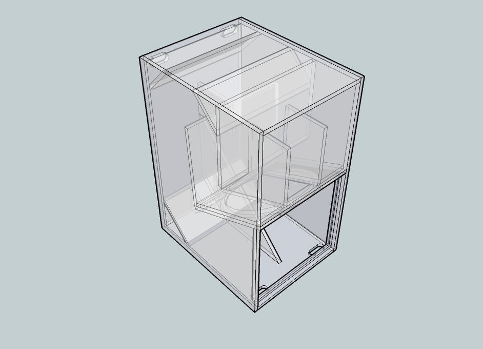

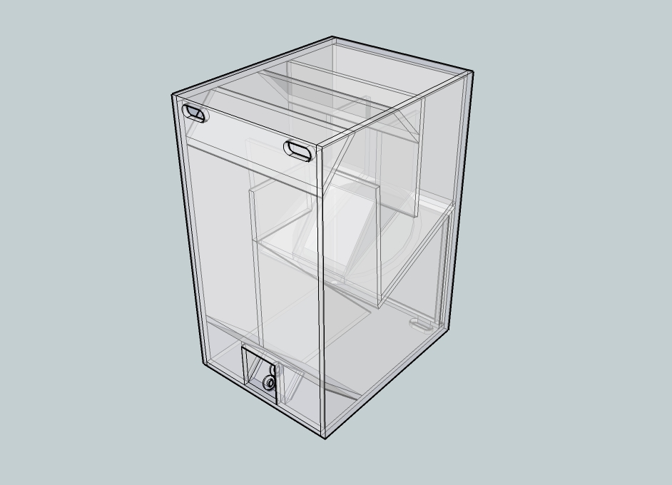

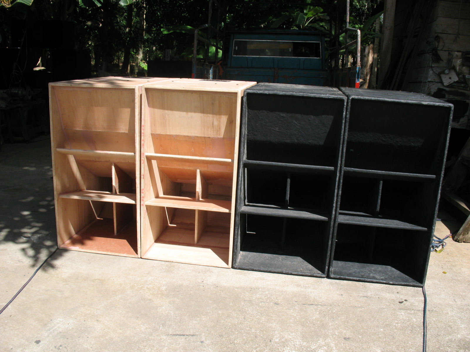

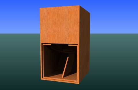

jayroe...they are not perfect since they are clone and drivers t/s are with no respect to the original. but, they did sound better, i was not able to record the quick smaart test we did 3 years ago...i will post as soon as i finish may new tappedhorn...im trying this new mcbean to model the box...i hope i got everything right this time...i will post the plan too...exited na ako to start saw dust, pera lang ang kulang para bili na ako ng kahoy and other materials.
drivers are...Crown 1860 and JH186. eto lang local.
have a nice day.

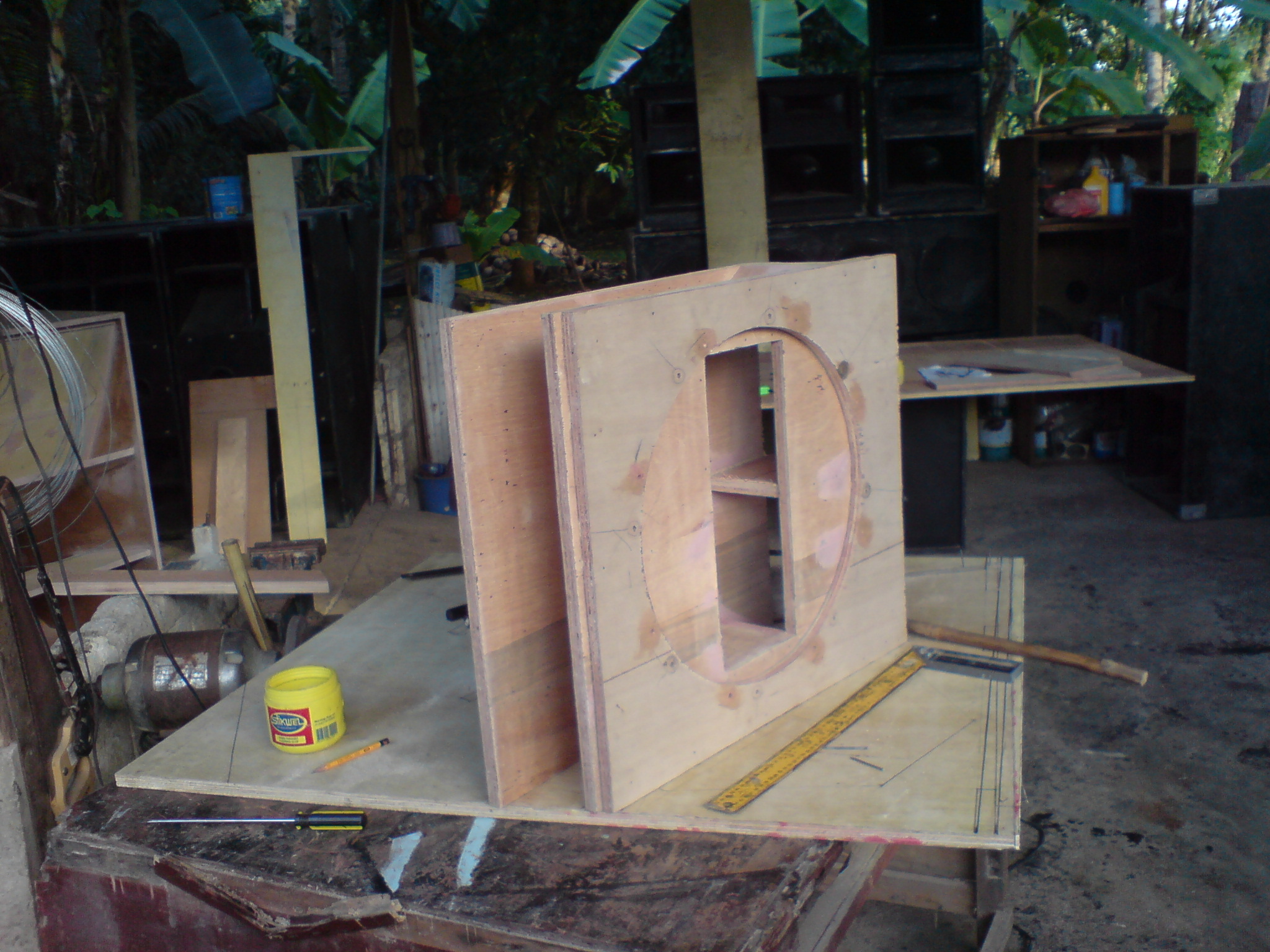

gud day gentlemen. i would like to share with you the Titan 48 i just build, using 1/2 plywood and a 15" live subwoofer per box. build 4, powered by a bridged 2-1,400watt amp @, calibrated at 100-70hz. you can check billfritzmaurice.com for the plan. great sound
wbin is not a bass reflex ..😕

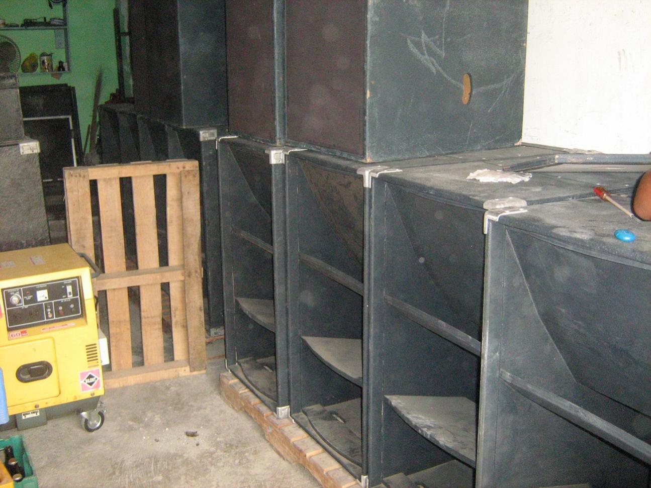

what happen to your WSX cabs?
qts, qes and BL are 3 main parameters you need to consider on this SL36 and WSX horn. you can play with the hornresp to fine tune the 650EL on WSX or SL36.
i cannot help it.😀 i always call the wbin a bass reflex... it should be hybrid horn, but maybe too much reading from speakerplans makes me think that way.
i wish i could show here the hornresp results i did out of the P Audio drivers. but i do not know how to copy-paste the results here...😕
i'm trying to look for other drivers.. especially the ones from china. but there are no parameters provided. that is why i tend to ask others who have experienced using them. there is nothing to play with the hornresp in the first place!😀

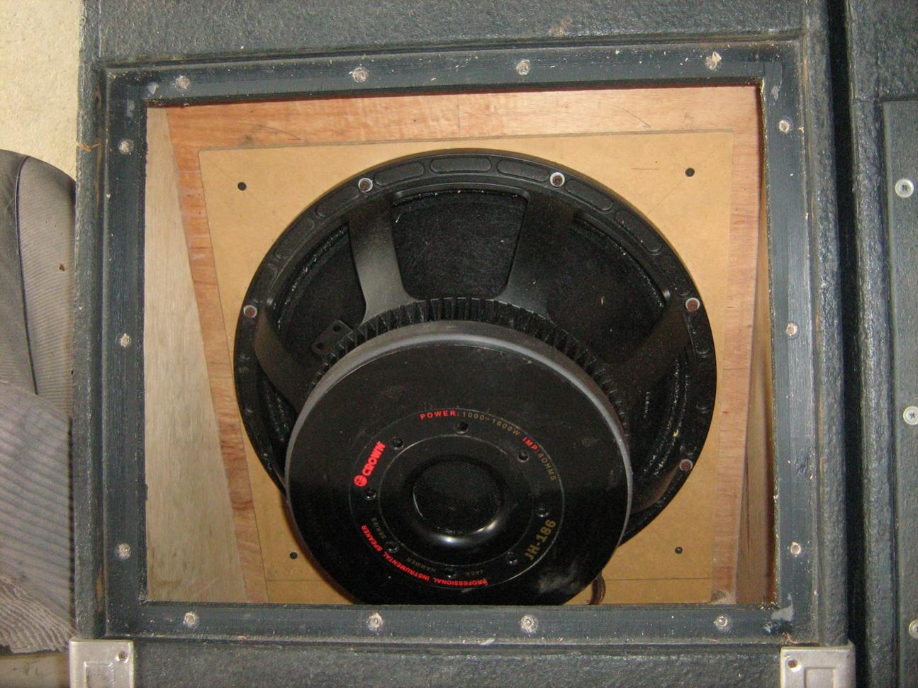

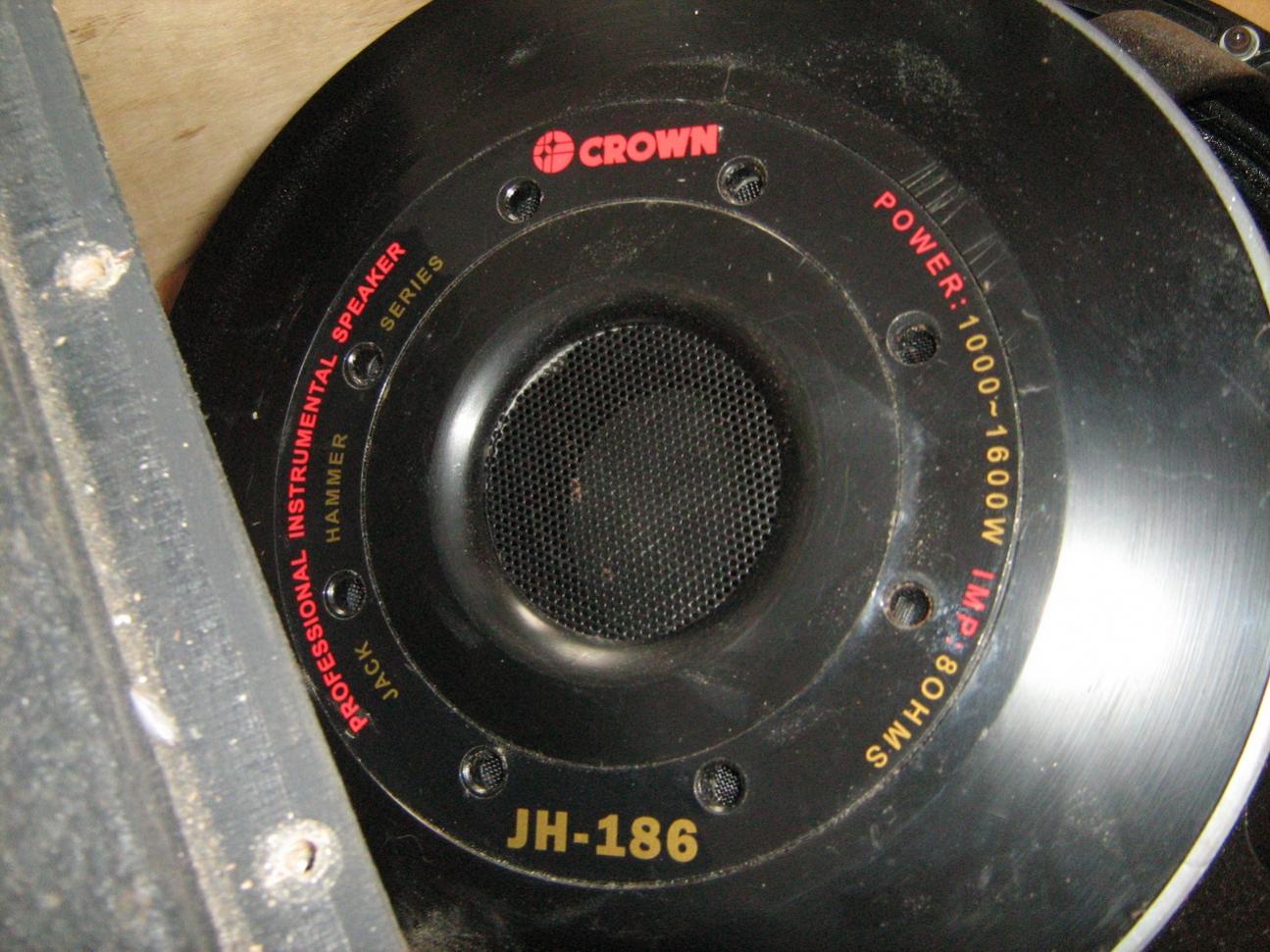

cheers dj jojo, that sounds interesting, excited to hear new developments.
Currently i am in the process of building my own design of hybrid bandpass but with longer horn path, (X-tro loading stylee) they are still on papers right now and pretty good simulation. 🙂
with the crown drivers, seems they don't have T/s parameters published🙁
leinad61...lol...magnet and voice coil of the JH186 beats the pa1860 (sensitivity) lots of fluxes and almost 6" VC, whilst the 1860 reaches first its power compression.
ang kinakabahan lang ako sa 186 ay cones na manipis at medyo malambot...but so far wala pa namng nabigay...
stay tune...post ko pag may nasira...
