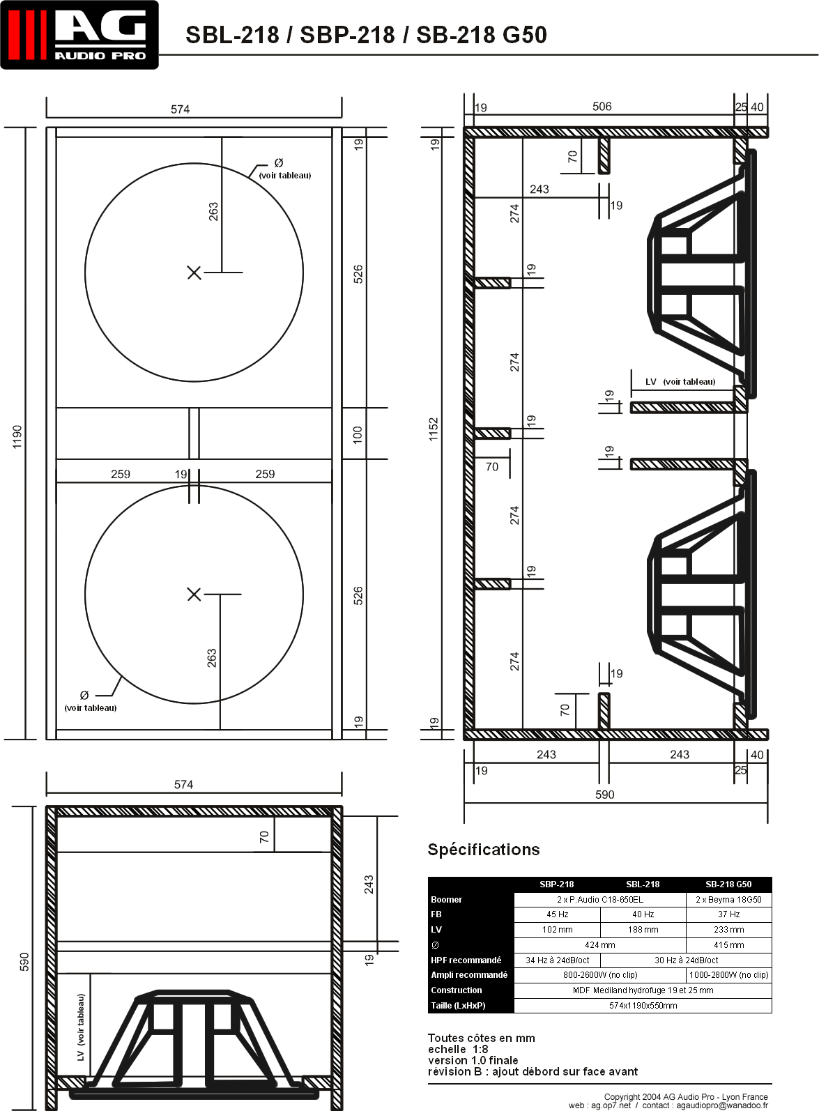

with the above given...here some successful projects for 650el (not anymore in production) ask thailand for challenger II direct replacement.
because of the mechanical compliance limitation of the 650el (Q(Qms)) you must safeguard it by a high pass filter at 40hz, thus, helping your 650el not to over-excursion and save you a lot of money.

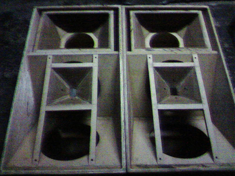

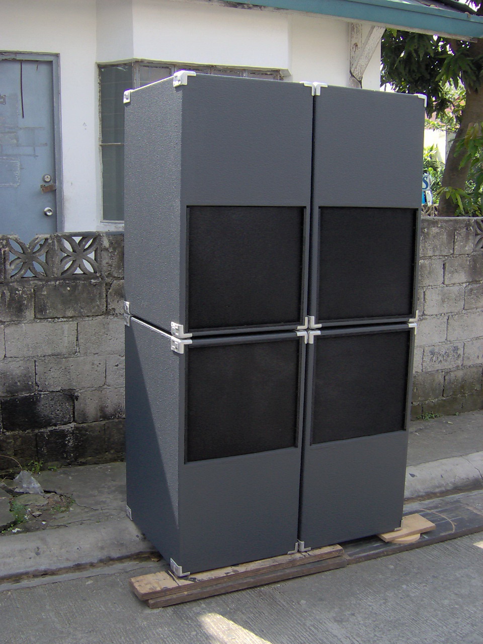

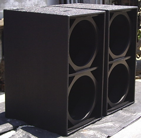

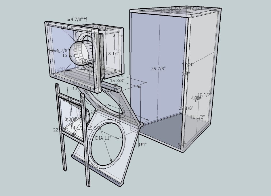

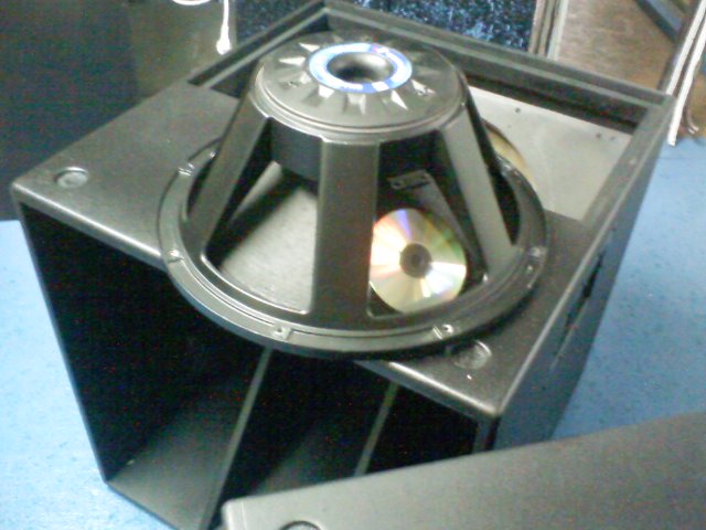

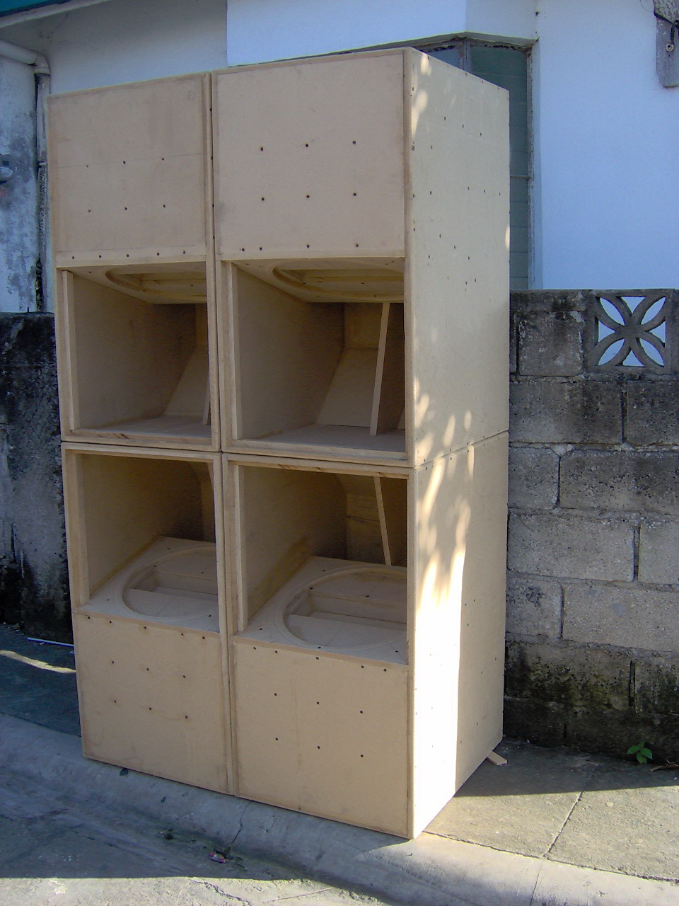

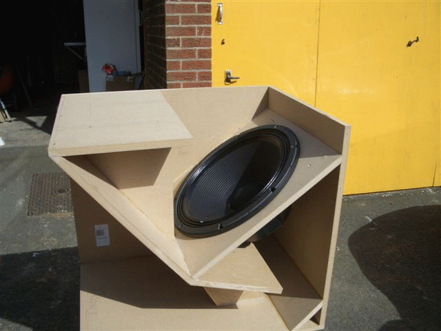

we are using clone copies of Martin Audio's...Tops- W8's...Sub-WSX...and Danley clones...Tops-Unityhorn...Sub-Tappedhorn...but really it depends on the venue...small venue we just use our good old drum monitor for FOH...CSX57II. Our boxes are all home-made from carpentry to passive network.

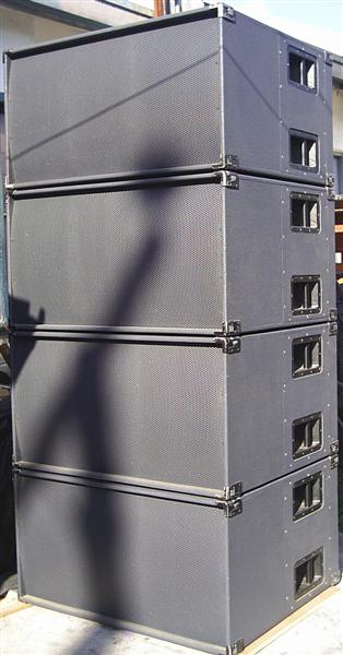

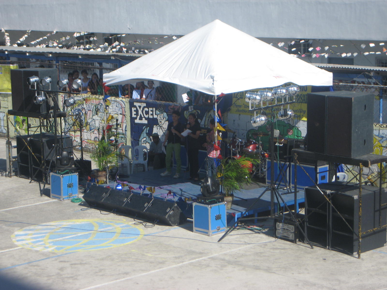

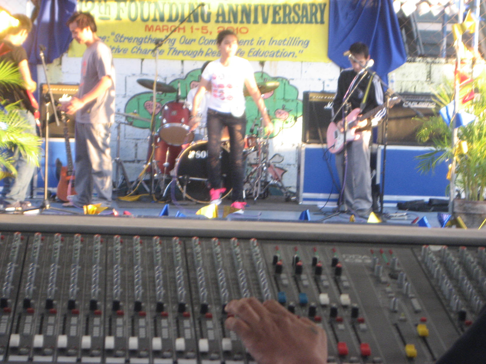

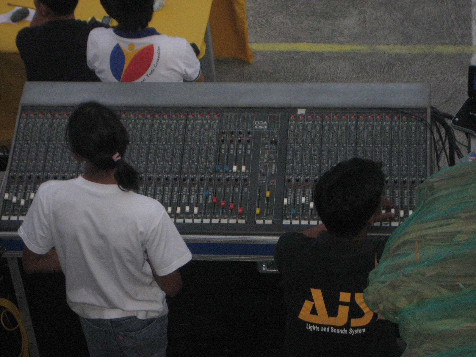

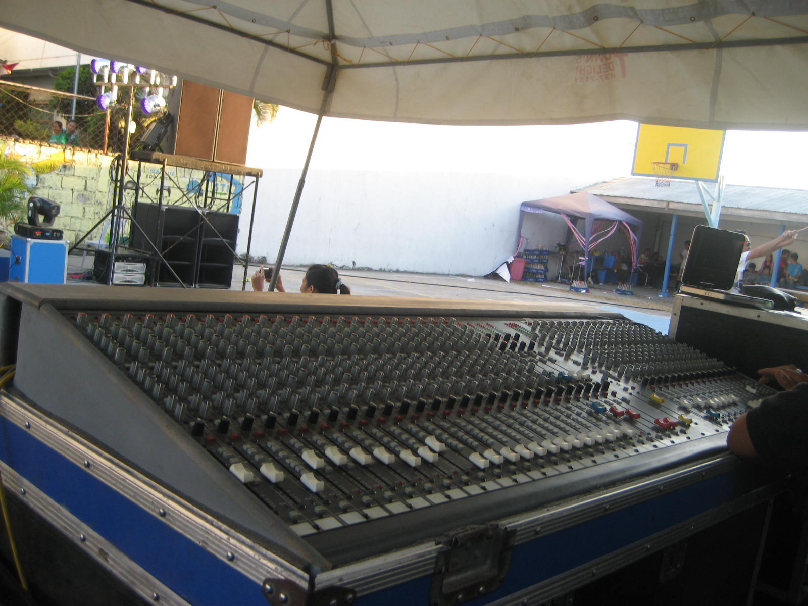

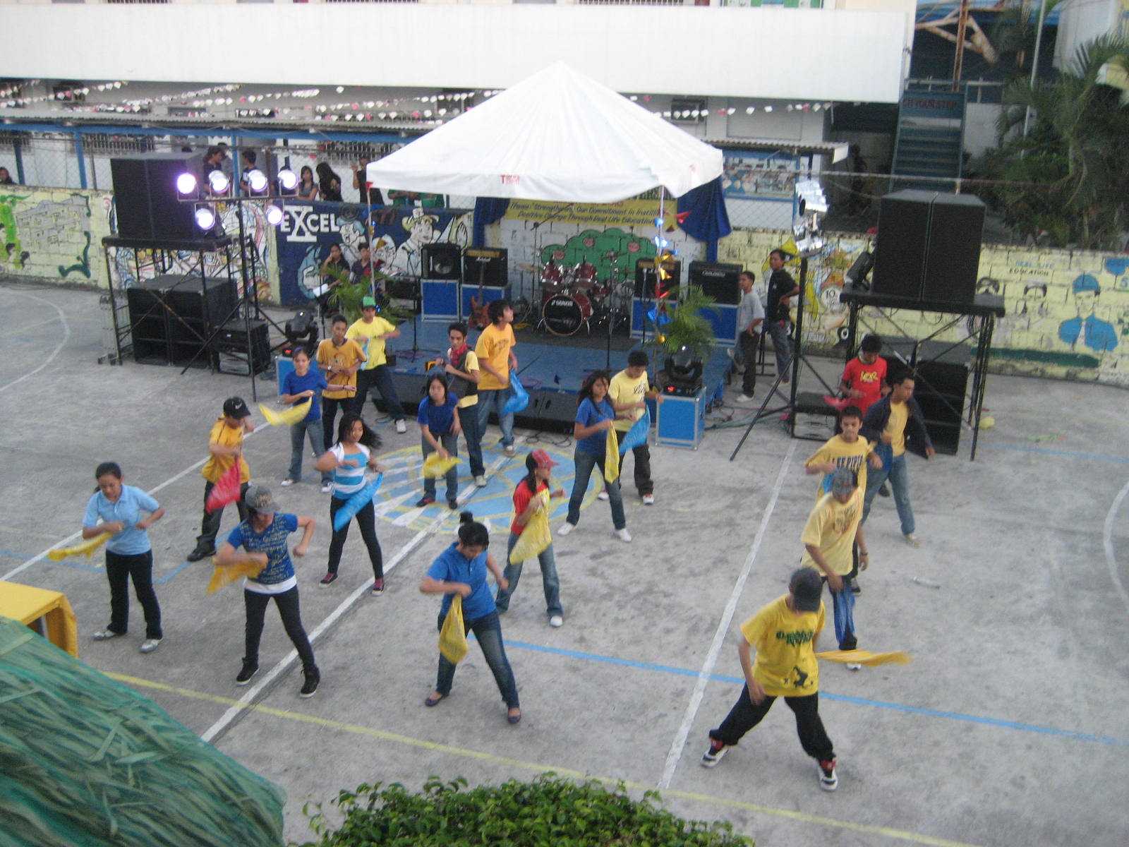

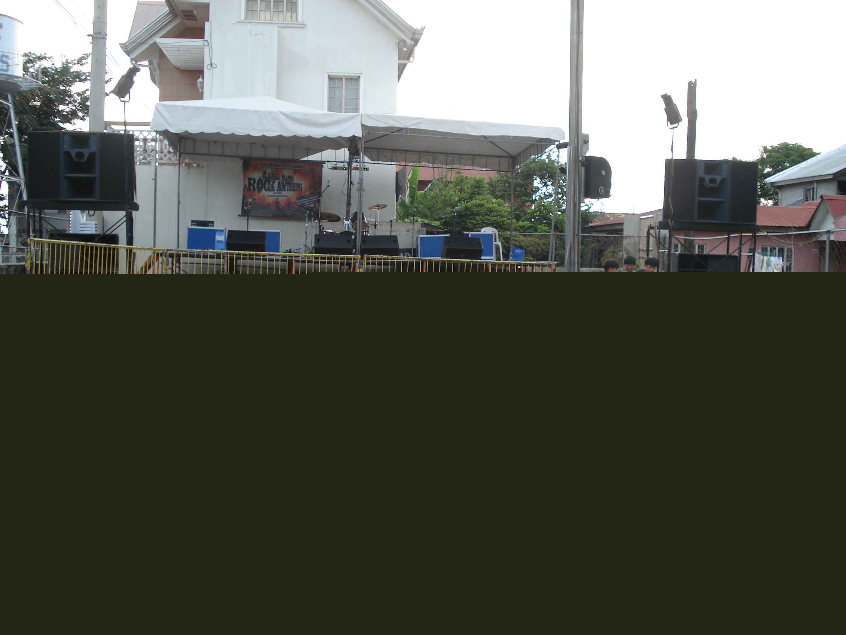

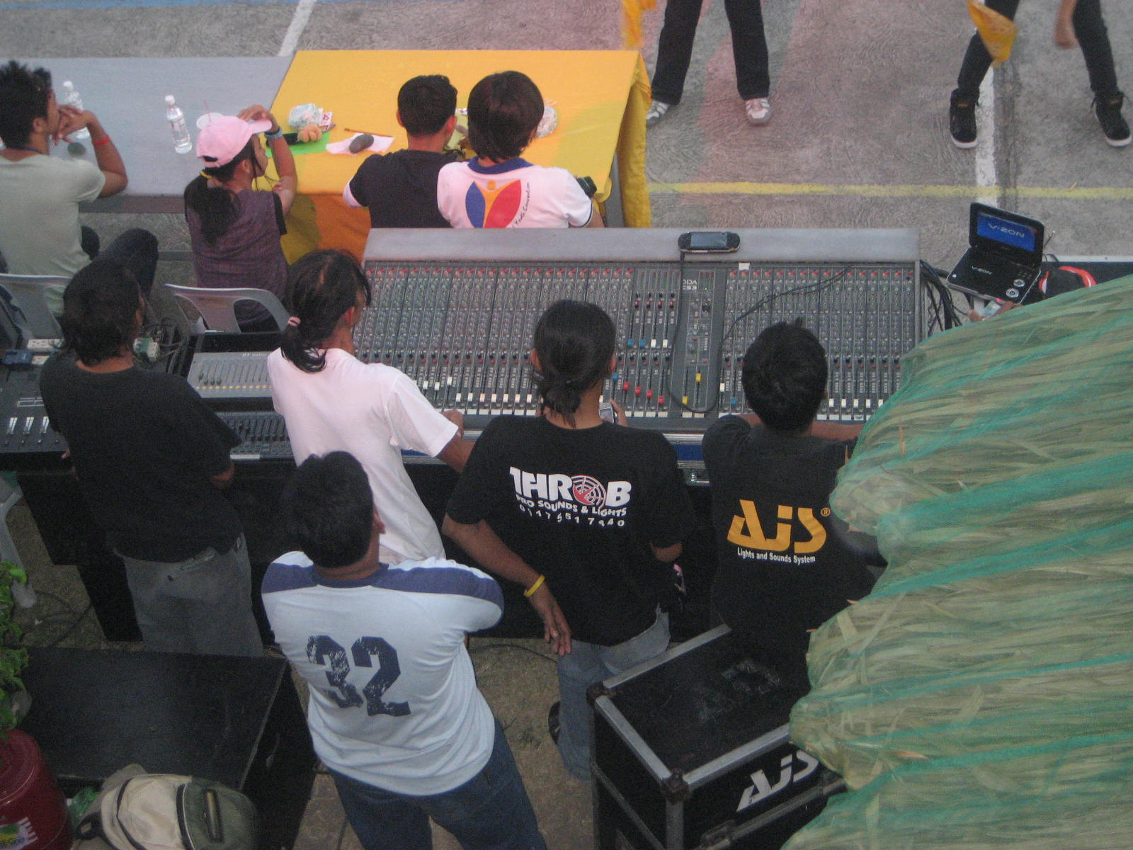

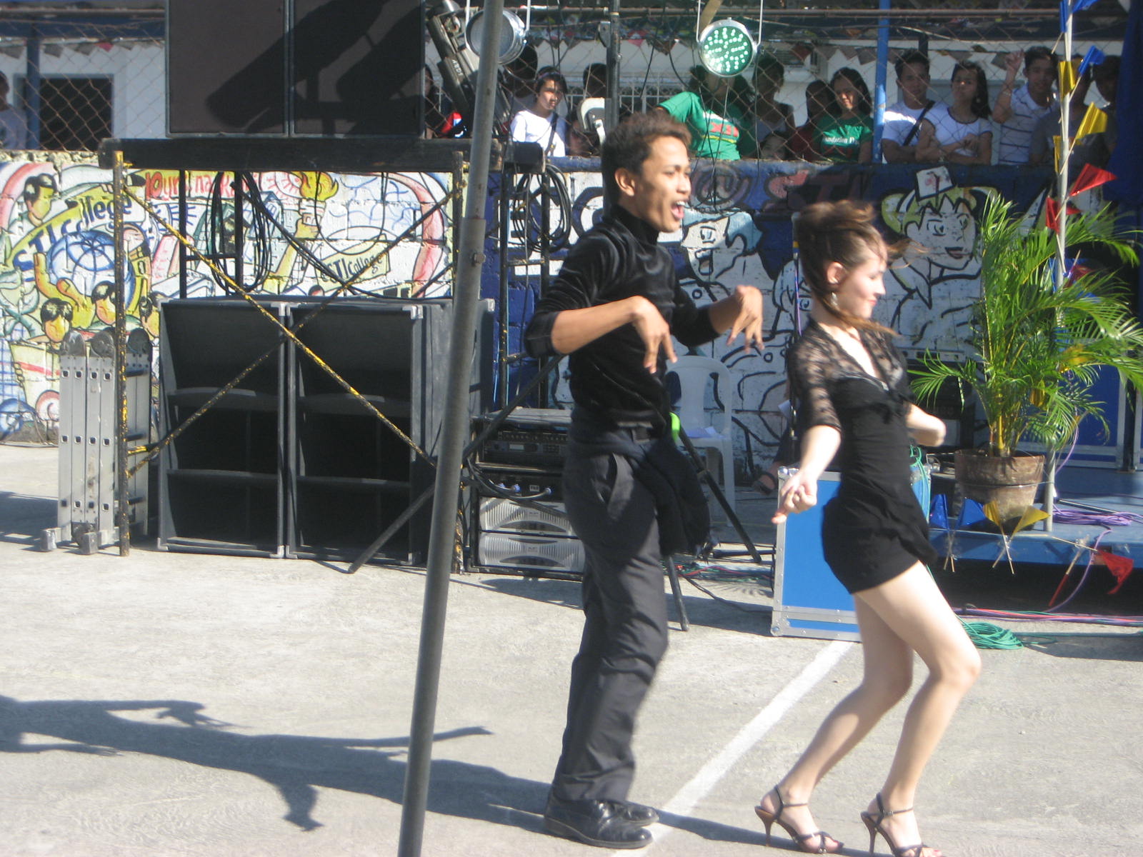

yesterdays gig XIII Foundation Day of STI Rosario...4 Martin Audio W8 clones-powered by 2 XP3000...4 Martin Audio WSX clones-powered by 2 XP5000...Loudspeaker Management DBX DRPA...4 EAW 151 clones Foldback monitoring- powered by XP3000.

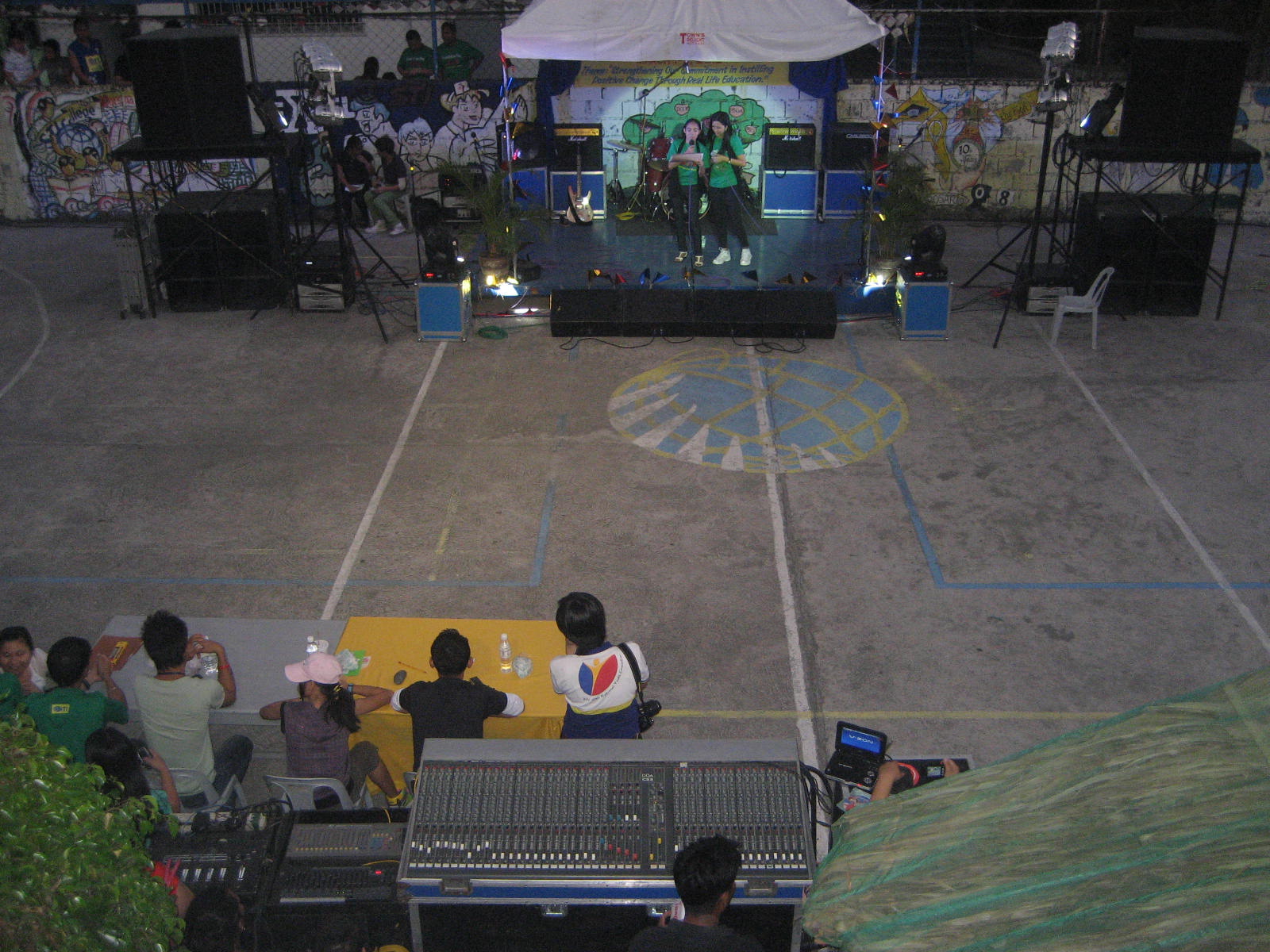

very nice sir this is not an ordinary sounds setup..may i know sir if what kind of speaker enclosure box is good to use in indoor or closed venue.. thanks
thanx Sir Amants, but the truth is...its just a simple ordinary setup. Given only 2hour to setup the system...so no time to organize the cables. Just do the Mic, drum-kits and instrument check and tuning...then start the show.
IMO...for indoor shows...it all depends on the dimension of the venue. Whats the distance from side to side?, front to back? and floor to ceiling?...this is very important for this will greatly affects the placements of the boxes and the sound quality.
remember that sound travel at approx. 343m/s at sea level, and at 20 degrees Celsius...example you have a 8meters side to side dimension...this tells us that we have a standing wave frequency and below 42hz will be difficult. ok..so now we high pass our aux feed subs to say 45hz maybe, thus, saving some power of amplifier from unusable freq. due to wall cancellation.
thats the sub...now how about our tops?...ouch!!! this is where the battle-neck is.
sub is easy you just have to worry for the kick which has a fundamental freq. of about 192hz, a bass guitar which has a fundamental freq. E => Aprox. 41.2hz
A => Aprox. 55hz. and the keyboard from Ao => 27hz G2# =>100hz...hehehe easy ha!
eto pa...how about the kick got that clicks at 2k to 5k, bass guitar slaps and keyboards percussions and sizzles?
These are the jobs of the tops box...from punch to brilliance...90hz to 10k...these are the freq. that will fill the venue...reflecting from wall to wall causing interference to each other. These interference will produce cancellation and will degrade sound quality.
its all about physics...know your venue...know you box...and you will be just fine.

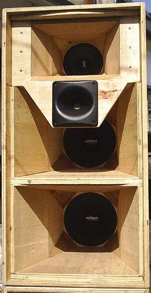

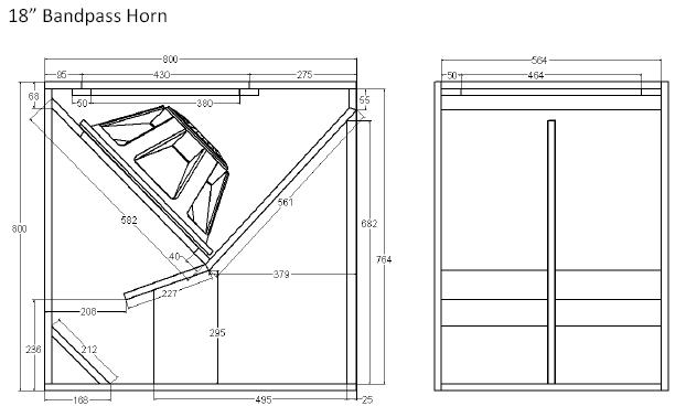

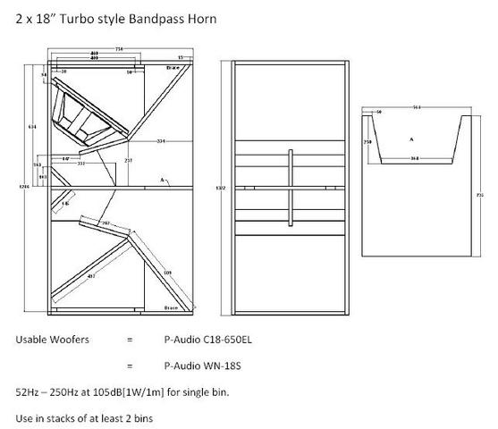

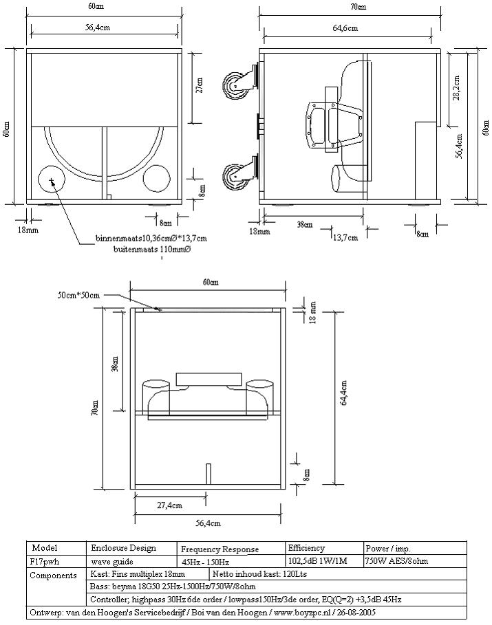

looking at the local chinese speaker products: neusch, T&T, crown, live etc. which driver tops for the full horn design like the L36 and WSX?
The P Audio 650EL is a good contender, but it seems better suited for a bass reflex like the W-Bin. The SD 18 should be the best, but it goes with a high cost. for a compromise, for a about of 6k php, which one is better?
wbin is not a bass reflex ..😕
what happen to your WSX cabs?
qts, qes and BL are 3 main parameters you need to consider on this SL36 and WSX horn. you can play with the hornresp to fine tune the 650EL on WSX or SL36.

how does your sub (tapped horn) perform? is that an 18 inch version? nice build quality!
can you please post the horn resp frequency response? driver you use?
