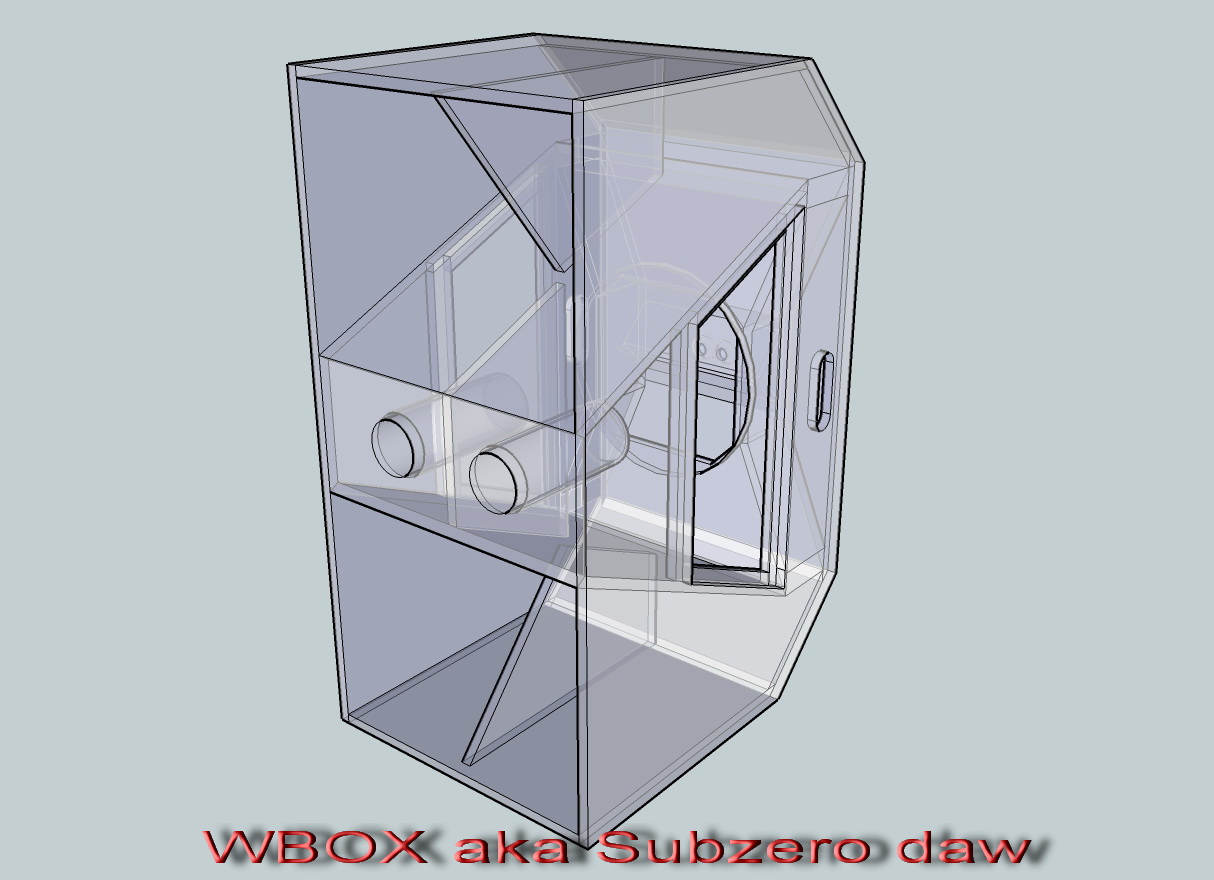

@alvin_alvin
its an old school w-bin sir.

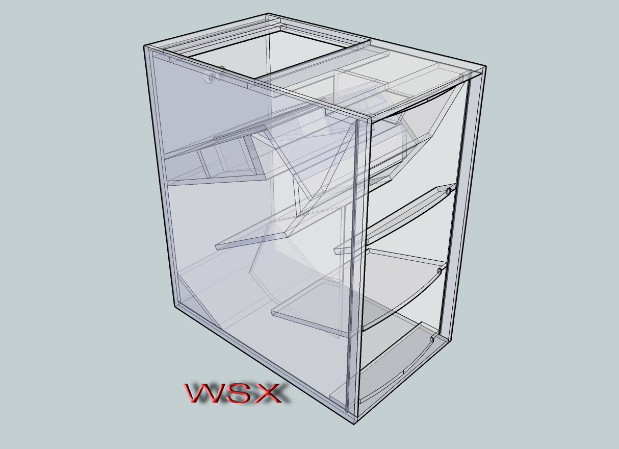

actually the only difference between the two amplifier is their power rating, my preference would be the L36 and it is making a comeback on our local sound system scene. They been around for a long time and it never goes out of style.
Thank you sir. 🙂

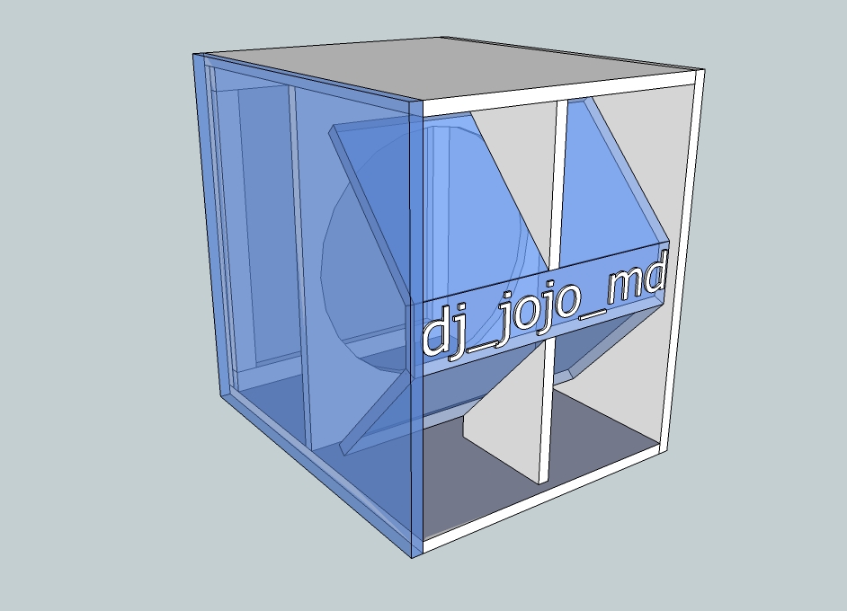

recommended local driver for the WSX and L36?
looking at the local chinese speaker products: neusch, T&T, crown, live etc. which driver tops for the full horn design like the L36 and WSX?
The P Audio 650EL is a good contender, but it seems better suited for a bass reflex like the W-Bin. The SD 18 should be the best, but it goes with a high cost. for a compromise, for a about of 6k php, which one is better?
L36 a "C horn" and WSX a "S horn" are both sealed box horn loaded configuration.
There are two main t/s parameters that can tell you if the driver is suitable for horn loading.
QTS and BL.
The Lower the qts the better. Preferably lower than 0,30
The Higher the BL the better. Preferably higher than 20.
but then again...l36 and wsx was designed for a specific driver to get the optimum performance. replacing the driver will change the response curve...but, you can use them with compromises.
that's what we all do...
have a nice day...

@alvin_alvin
@audiomachines
Sir, what speaker would you recommend for this box? Thanks.

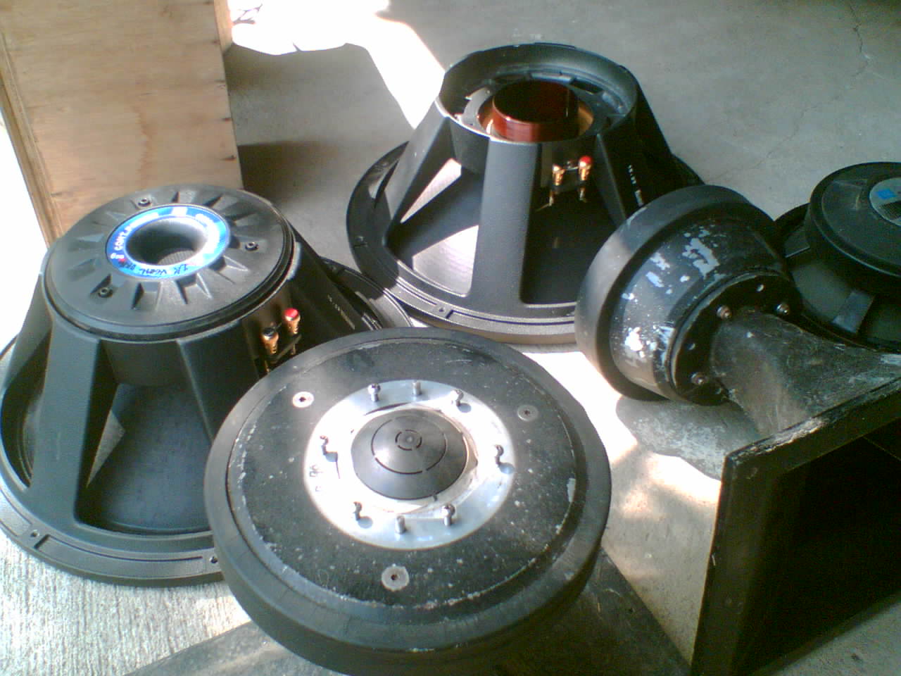

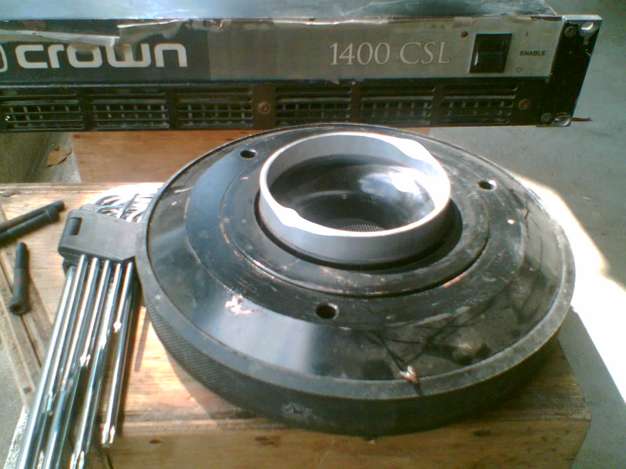

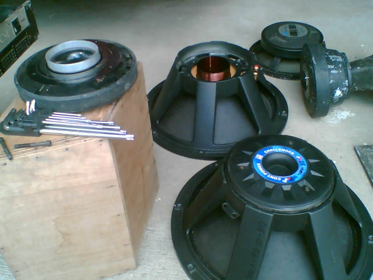

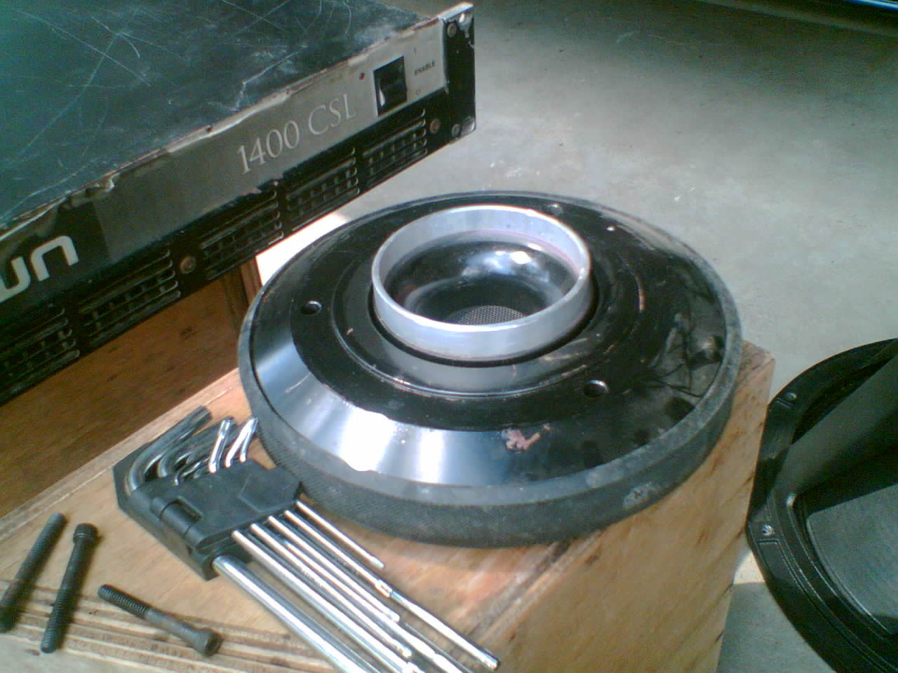

from what type of box are those 650EL coming from? what is the usual damage does it take?
@audiomachines
Sir, Igot 4 pairs Of P-Audio,From Your Experience What is The Best Box
For Them, I got A 4 Subzero, And 4 186Horn, Still not Satified With Them.
@zrolsky

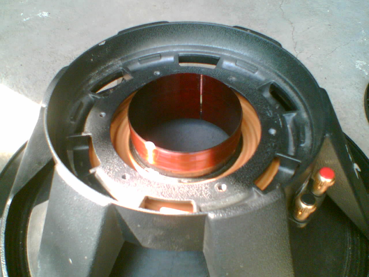

from a T18 subscope, driven by a ca20 and a subharmonic synthesizer, the usual burnt voicecoil and a ripped cone.I believed the the dual spider system is the culprit it is too stiff, ^ and that one breathed too much dirt from the road.
@leinad61
In my opinion they should be used in a bass reflex box.
@leinad61
@audiomachines

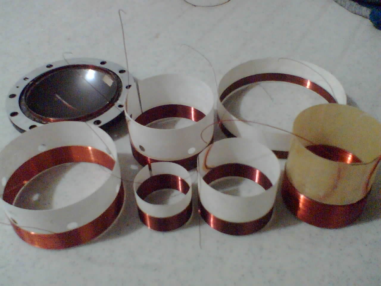

you mean the DBX subharmonic synthesizer? i've read that equipment is one of the main causes of burnt coils. i have heard a subzero with the 650EL, loud SPL, not bad at all, and given the fact that it was only driven by assembled amps.
the original coil is aluminum. do you replace it with copper ones? does it work?
the xmax for the 650EL is only 5.5mm i think. but they say this is a very conservative value. in truth, it might even be 10mm. 😕
yes it is a dbx synth
yap I rewound it with a copper voicecoil on a fiberglass former, using an inside outside winding technique. And by the way copper has a much higher melting temperature than aluminum plus you wouldn't know if it is a rewound voice coil or not, same DCR same winding depth with perimeter venting. you would not notice the difference on the output. I have also rewound countless 2226 using the same technique with great success
