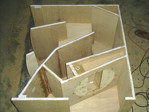

Sir, I'm new member. Can i have an enclosure plan for L36 and subzero? I'll be on vacation this yr. will probably via manila to buy some sub drivers. Any recommendation what speaker drivers suits for this and where? thanks and more power to you.

as a speaker repairman and from what I had seen,your P-Audio would probably shred cone inside an L36 enclosure
however this is just my two cents.

What Would Be Better, For This 2 Box, Doyou Have Plan For Refflex box,Ano Ang Pwedeng Gamitin Para Sa MID And High, ThankYou SIR.as a speaker repairman and from what I had seen,your P-Audio would probably shred cone inside an L36 enclosure. They are much more suited in a box reflex box. It wouldn't even last in a subscope cabs (T18).😱

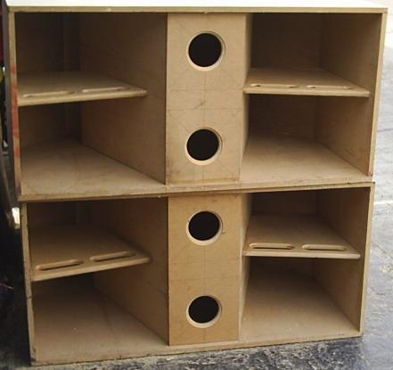

sir audiomachine im a newbie here just want your opinion on what is the best power amp among the two,the crell ca25 or ca20 of sound standard and which two sub cab gives more ground shaking bass driven by pd1850,el36 or wsx?what is the size of wsx cab i've never seen such cab before?...have you heard kevler vt-488 line array series?what is your comments on this?..thanks and more power

its an old school w-bin sir.

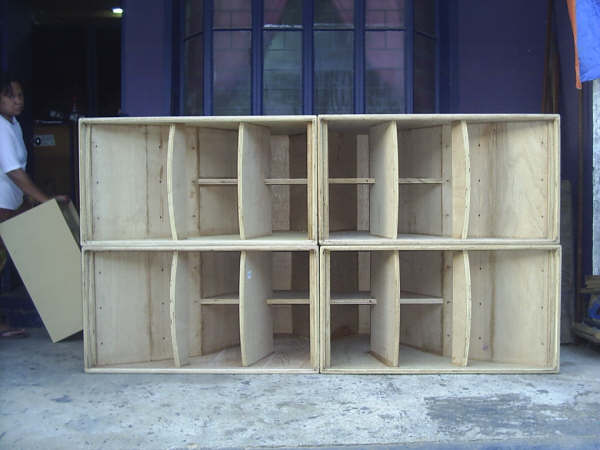

The WSX is designed to be ground stacked and ultimate performance is achieved by close coupling a stack of four or more WSX's mirror imaged on their sides to increase the combined horn mouth area. For large outdoor systems, stacking mirror imaged pairs up to six or more high will form a tall line source which will focus the bass into the audience yet retain good horizontal coverage.
WSX has a 1/4wavelength hyperbolic horn @ approx. 40hz, therefore 4 stack completes the 1 wavelength and this is where it really shine...technology of the mid 80's. Professional Loudspeaker Systems. Martin Audio Ltd.
"W"-box provides a 4dB sensitivity increase above 40Hz and a usable response from 32Hz to 400Hz. The horn mouth size of this enclosure is 1/8 of the size required for a full 40Hz horn. Hence, stacking 8 JBL “W”-boxes in a 4 x 2 configuration will provide true horn loading down to 40Hz. Because of the inherent midrange coloration of any "W”-horn design, the recommended crossover frequency is 300Hz or lower. Dr. Keele design during his days at JBL...technology of the mid70's.
we been using WSX ever since early mid 90's and its the most faithful sub we have use...not so popular for DIY'er because of the building difficulties.
