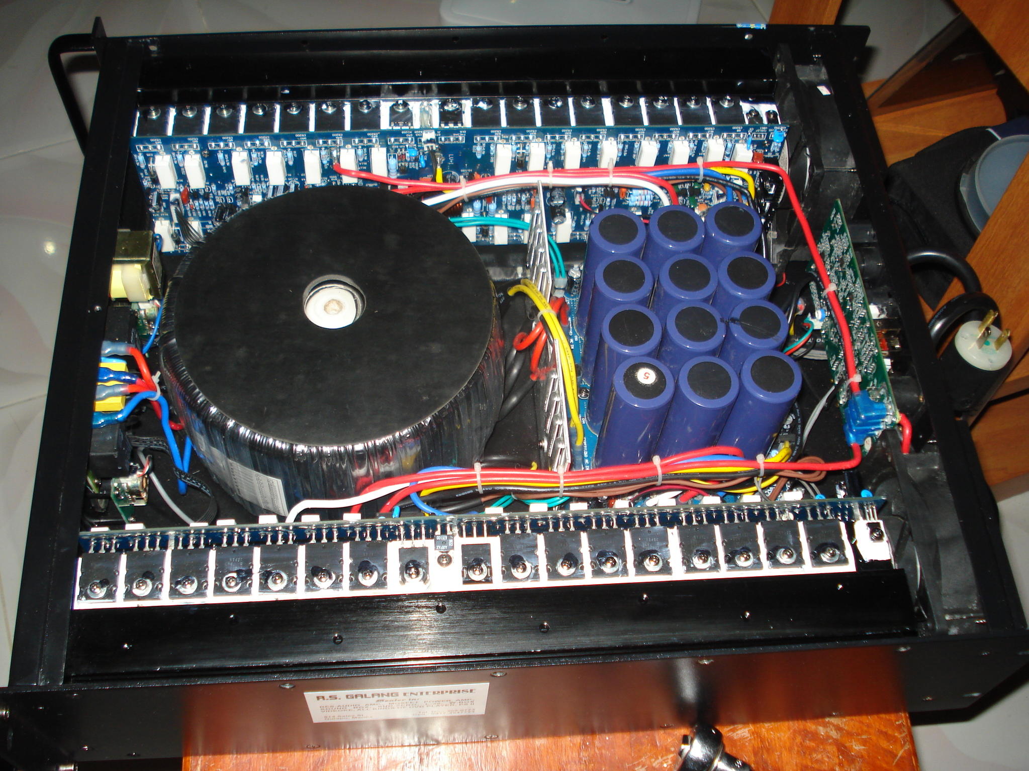

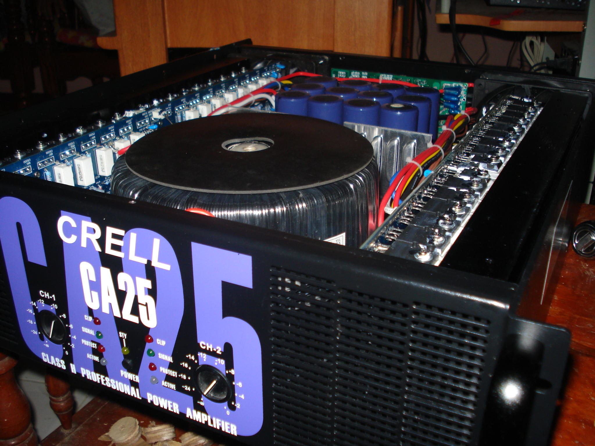

Hi Guys
Please post the inside layout of CA25. Just want to confirm if I am getting the right one. I will offer a very competitive price from 3pcs up of these CA25.
Best Regards,
jayrjoe

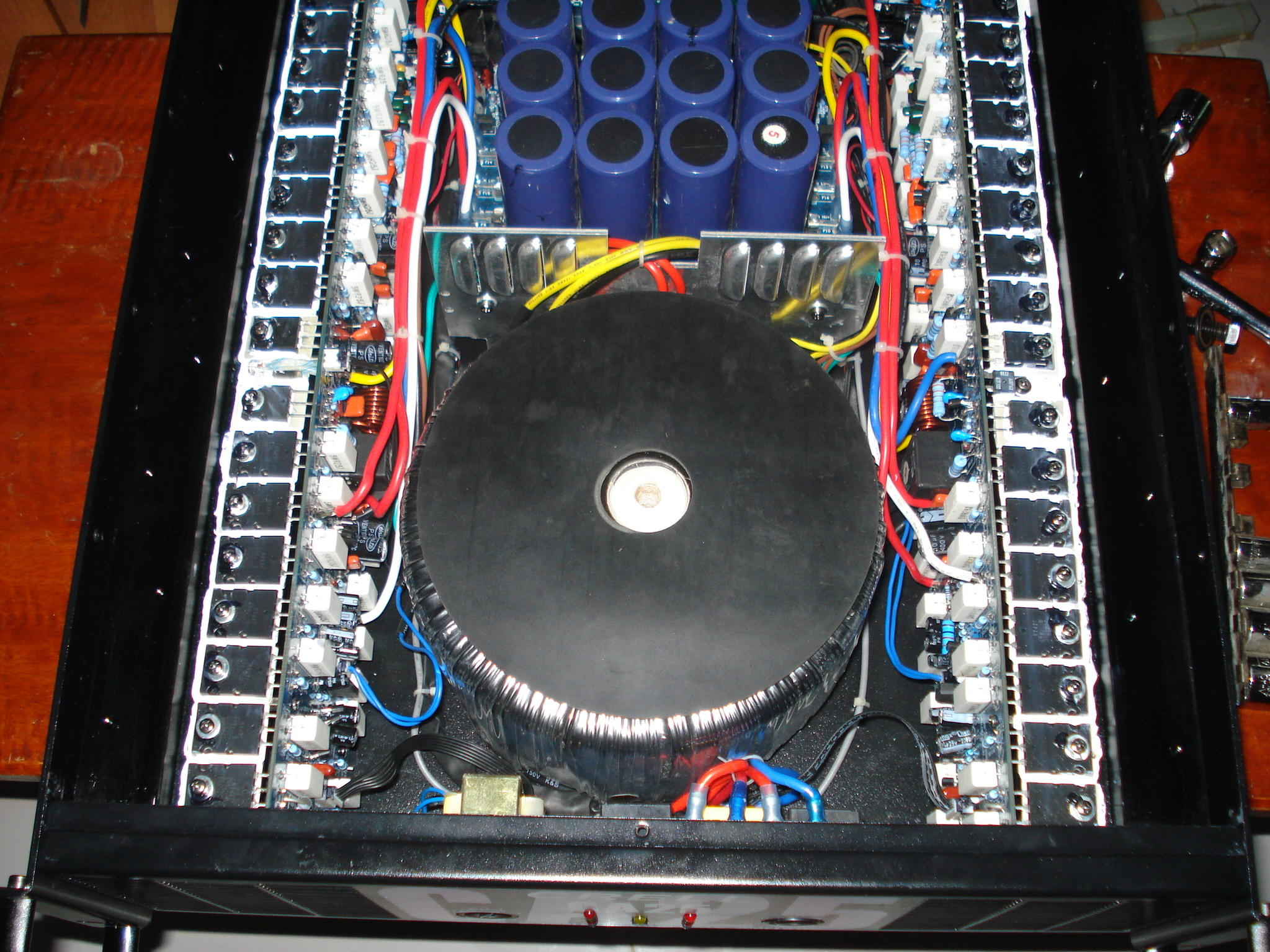

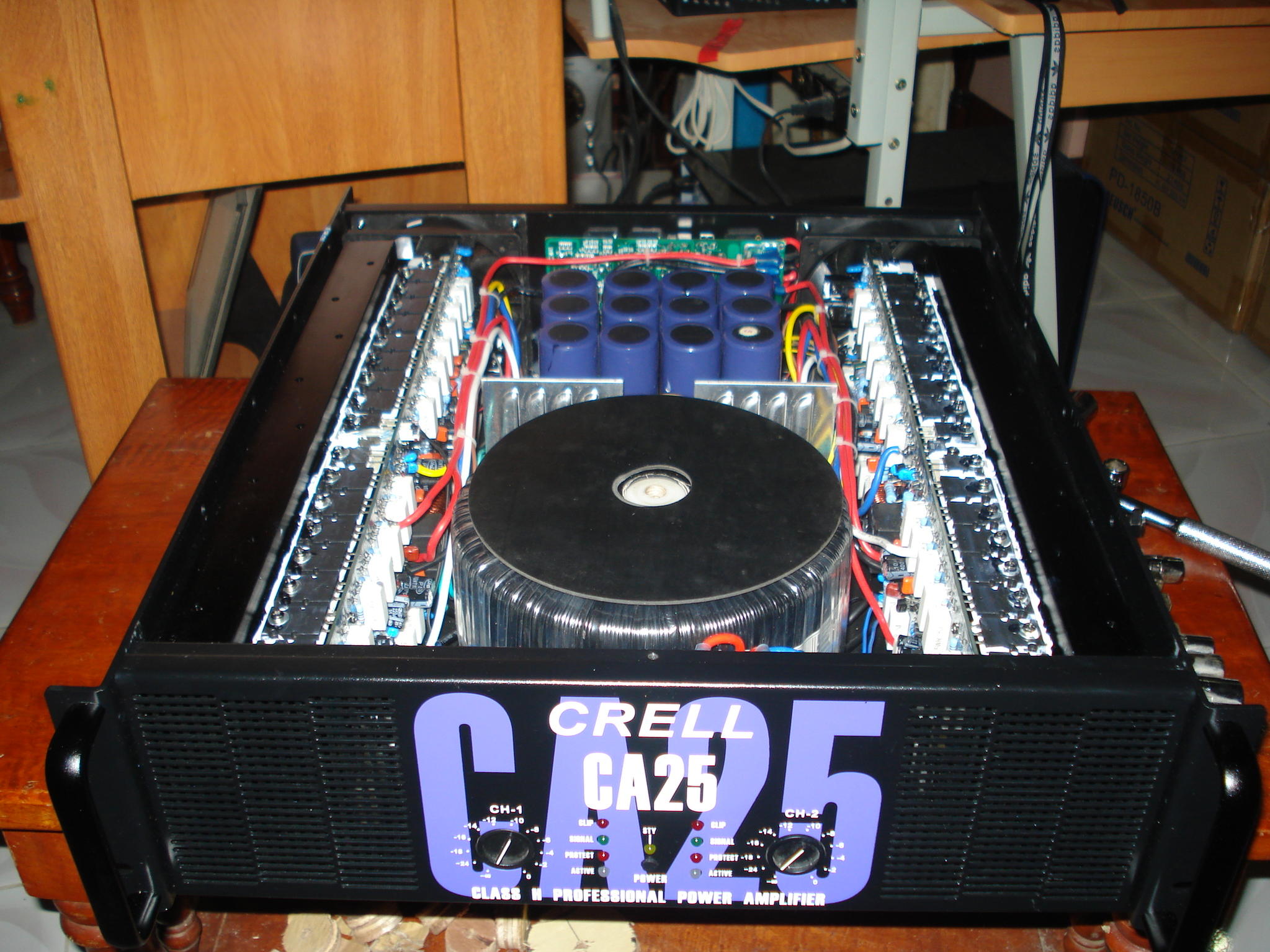

heres the inside view of my crell ca25 sir just purchased last oct.2009
@ amants,
Thanks for the effort of posting the photos.
You got some array of transistors there.
Any idea of the rail voltages?
Best Regards
Best Regards
@ amants,
Thanks for the effort of posting the photos.![]()
Best Regards
I'm sorry sir pero di ko na kc tiningnan ung rail voltage nya,basta I open & take a photo thats it,at dko n rin magawang tingnan s ngaun kc bumalik n ako d2 s korea for work.
ok sir thanks for that...
more power..😎

@amants
Hello sir, got an info on your CA25, its still a 2 steps Class H with rail voltages of +/-80volts and +/-160volts unloaded.
Previously I thought Crell upgraded to 3 steps class H.
Soundstandard CA series is now 3 steps Class H.
Best Regards
Best Regards
@amants
Best Regards
ah ganyan pala ang rail voltage nya,so maybe soundstandard ca series is better than crell ca series, or they are only the same
ah ganyan pala ang rail voltage nya,so maybe soundstandard ca series is better than crell ca series, or they are only the same![]()
2rail (2steps) and 3rail (3steps)Class-H circuitry switches or step up into high power rail only when needed.
It will result in much greater efficiency and less destructive heat. So it runs cooler. The design will not only maximizes power, but also improves long term reliability.
Basically 3 steps H is better than 2 steps Class H.
I reckon Soundstandard Techno series, though same power as CA series but only uses analog switch to power ON, has 3 rails.
VL = -/+ 55volts DC
VM = -/+ 110 volts DC
VH =-/+ 170 volts DC
The QSC PL9 proven to be a monster amp and subwoofer toaster uses a 4 steps Class H.
All the best
